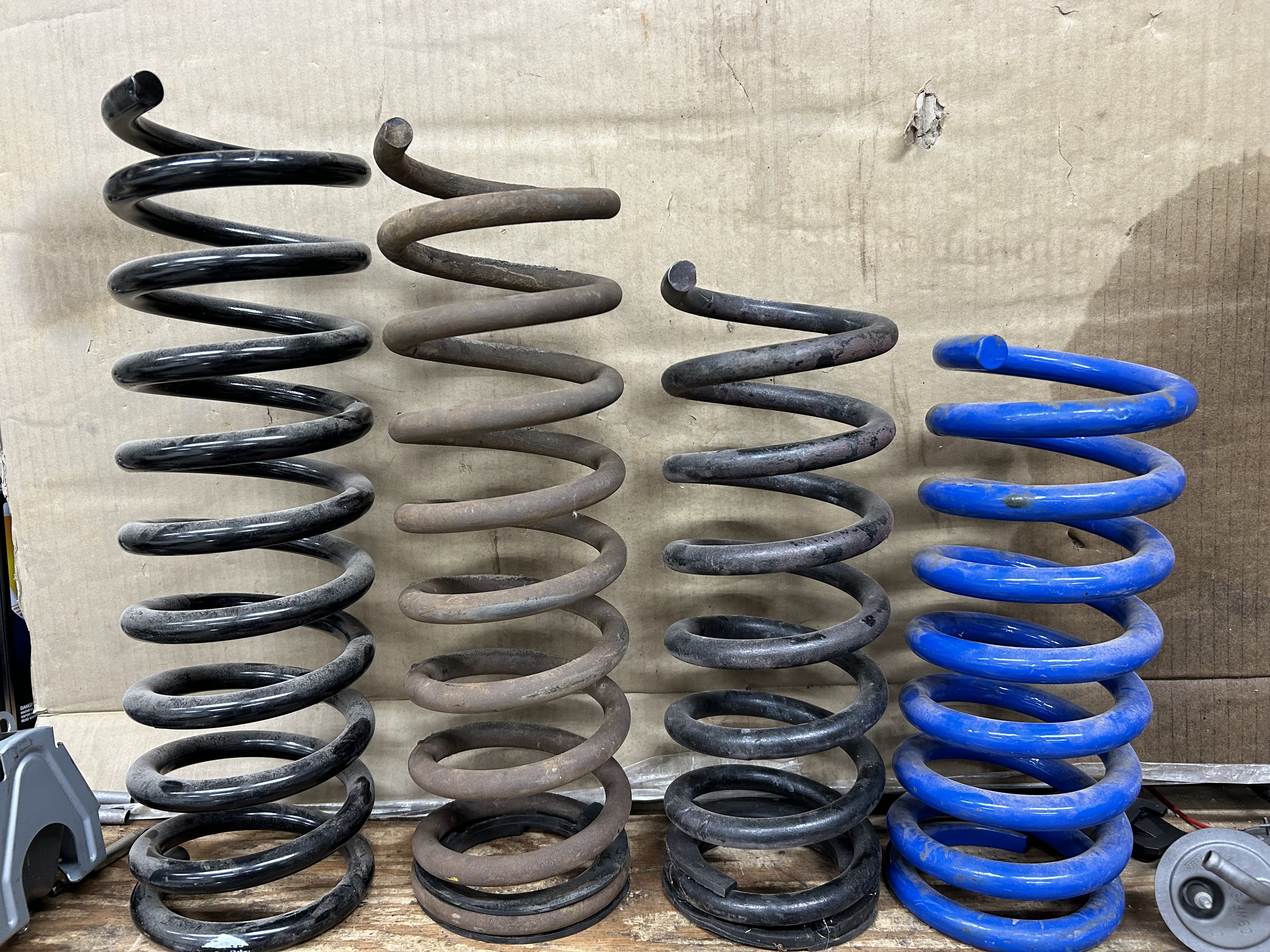

So I had a pair of Mustang front springs from. 289 automatic AC car. I counted the coils and found there were two fewer than what was in the Cougar. Same 5/8” wire diameter.
So today I found some time and put the first of the Mustang springs in. This gave me the opportunity to compare the springs.
What you are seeing from left to right is a Moog 390 spring. The spring I removed is next. Then the Mustang spring, and finally the 620 lowering springs that used to be popular. The 620 is larger in wire diameter at 3/4”. All others are 5/8”
So what springs were in this Cougar?
Bill, I am going to go with …the unpainted springs, as my guess as to what came in your Cougar.
Seriously, I have been through the Mercury, and Ford MPC, and there are so many springs. Is there any paint stripes remaining on the original springs?
So many variables, including (but not limited to) bench seat or bucket seats is one that I remember from the MPC.
If you are looking for a slight nose down stance, I would cut one full coil from the supposed OEM Cougar coils. They will still be slightly taller than your existing Mustang ones. You have lost a few pounds with the aluminum engine parts.

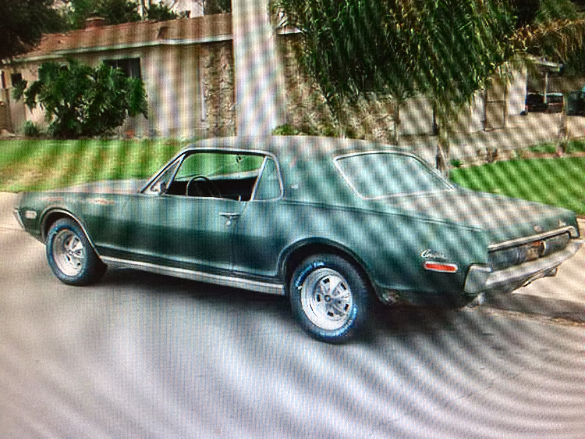

On my 1968 XR7 I repurposed 1970 Cougar 351C-4V front coils, with 1 full coil removed. My 1968 XR7 has manual steering, disc brakes, no A/C, and T5 transmission. I am really happy with the handling and ride height. 15x7 wheels with 225’s.

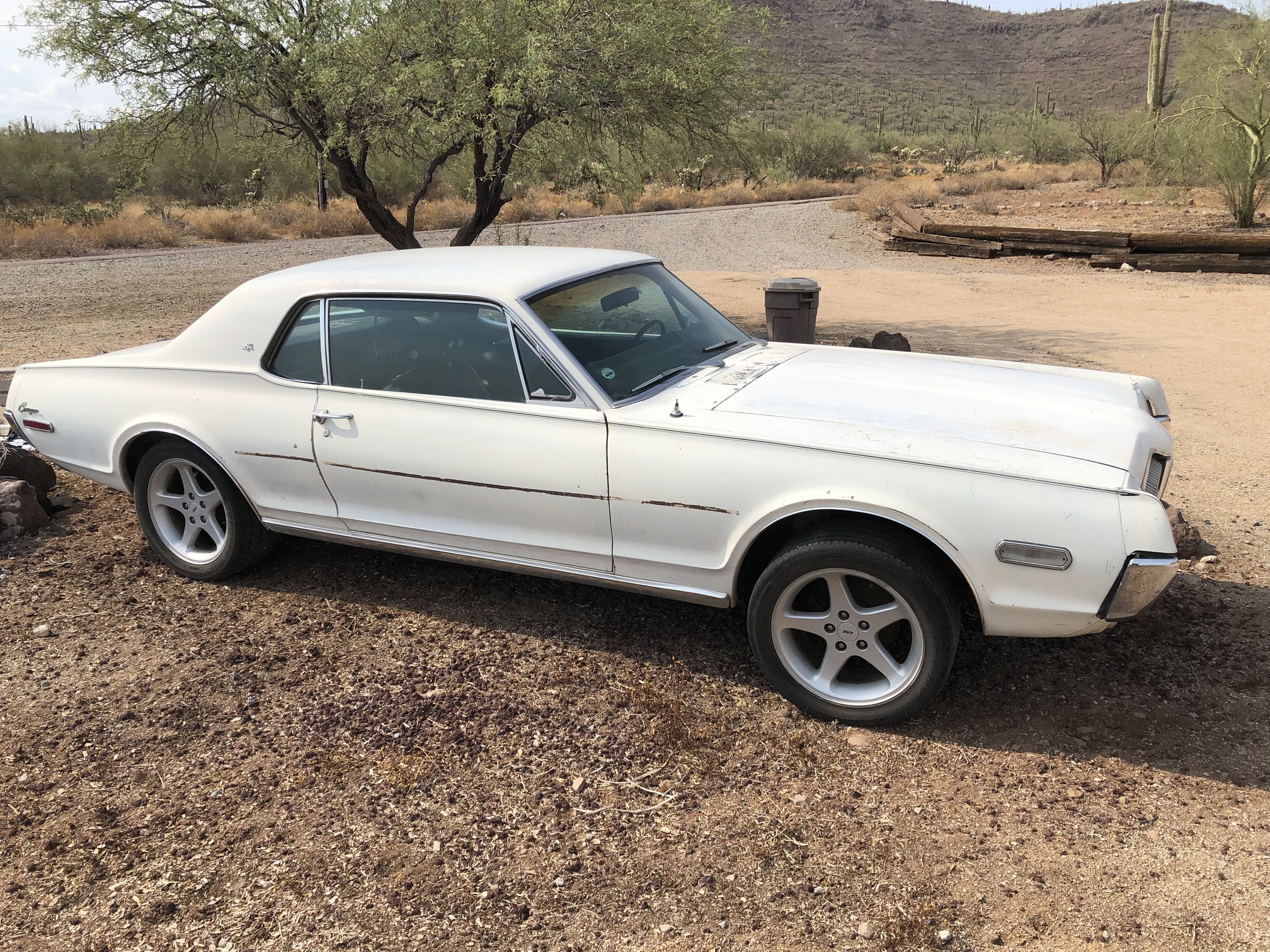

This doesn’t show the height as well as I would like. And this was with iron heads and iron intake so it was actually heavier than it is now

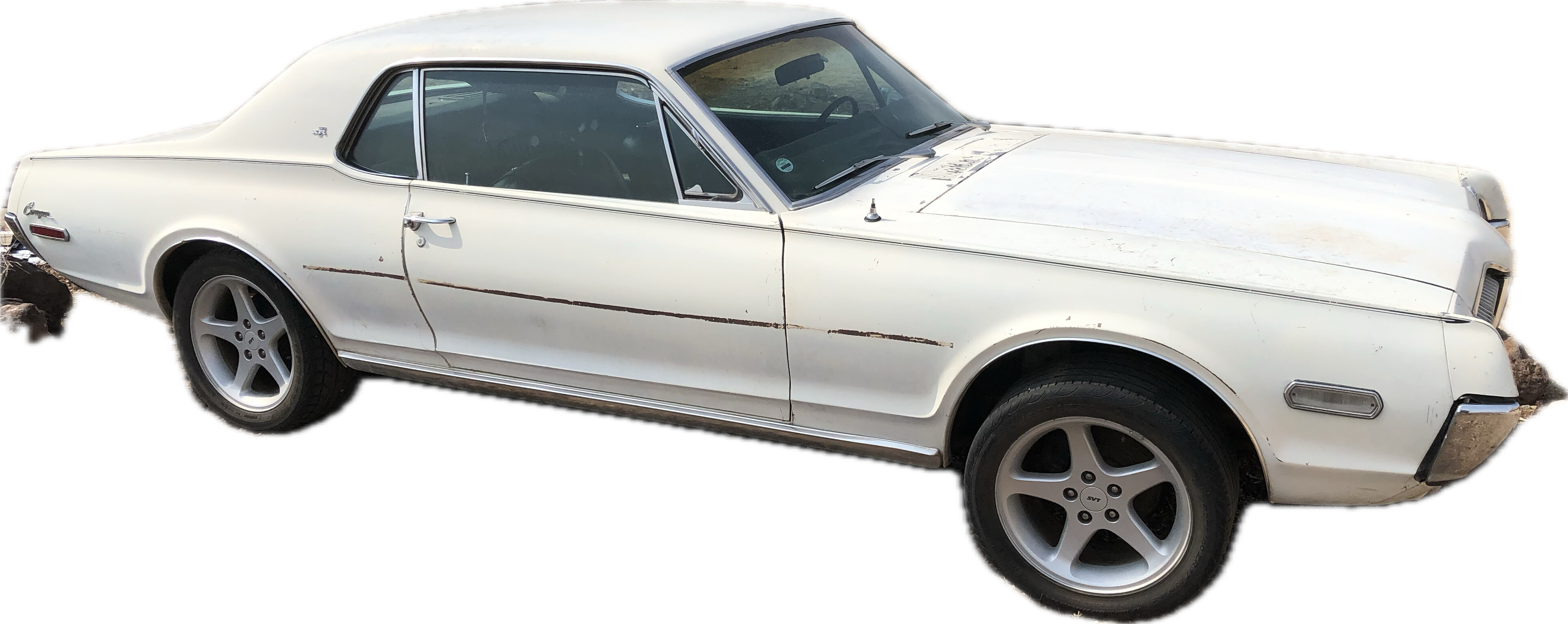

This is strange. It looks like the background is edited out. Trying again
Solid looking 68! But yeah, front end sits too high for me too. Is pic with the original or shorter Mustang springs?
Original springs. These wheels actually make it less evident how high it is. I am now using 15 versions of the Cougar styled steel wheel
It does ride quite a bit higher than desirable with those springs. If I had to guess you have worn big block springs based on what the new one looks like? But who knows what happened in its previous ownership.

I’m going to try the Mustang springs and see what happens. It looked maybe 5 to 6 inches too high. I’m going to guess that it will be too low but that will help me better understand what I need to cut off the original springs (assuming that they are the original springs?)
Thats a PITA way to find the right springs, but I don’t have any better suggestions. For what it’s worth, the Mustang springs at 7+ turns look alot closer to what I am used to seeing in small block cars than the 8+ turn springs that were in it.
