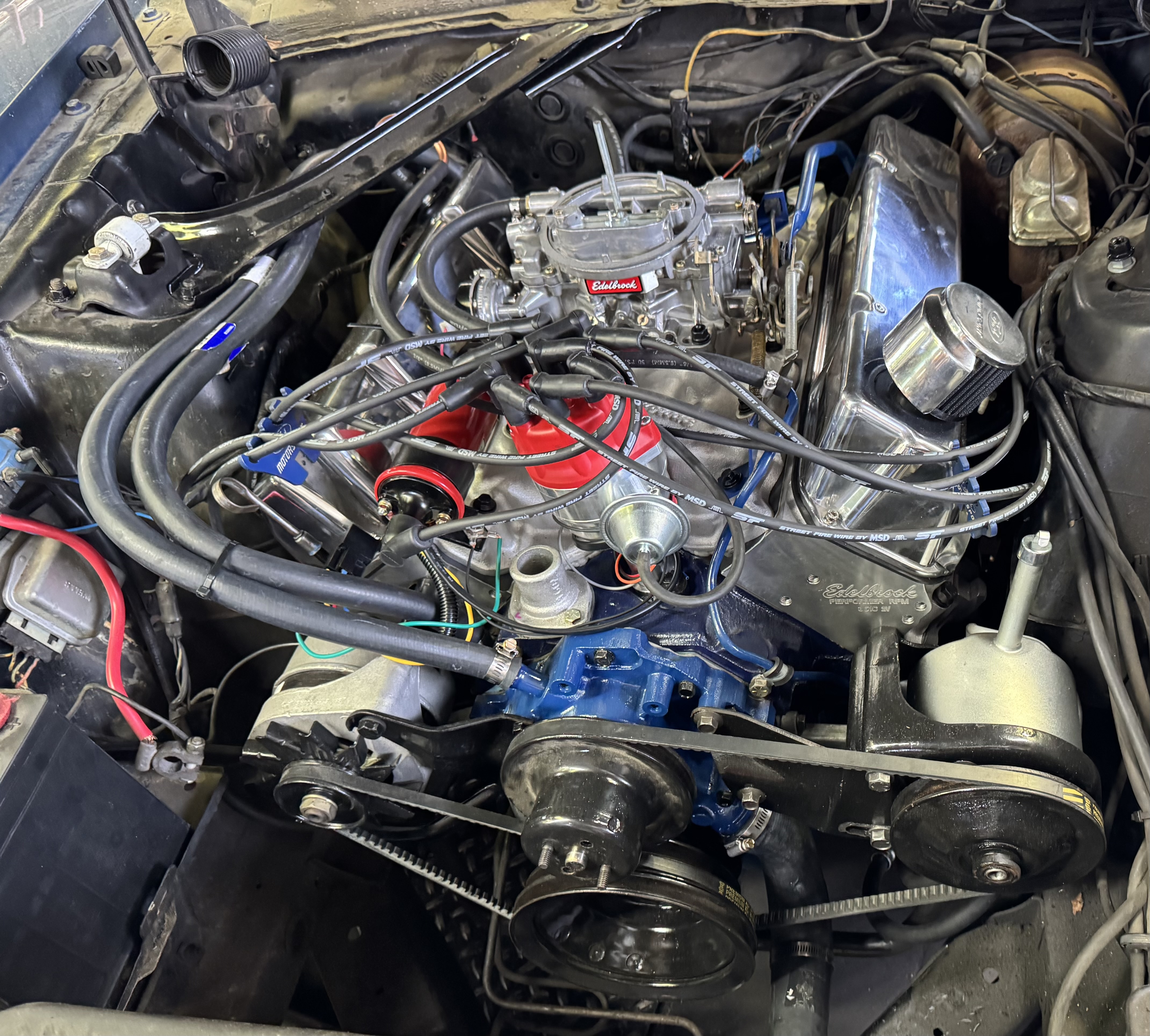

Here’s a pic that happened to show under the cap. That look like two rows or three?

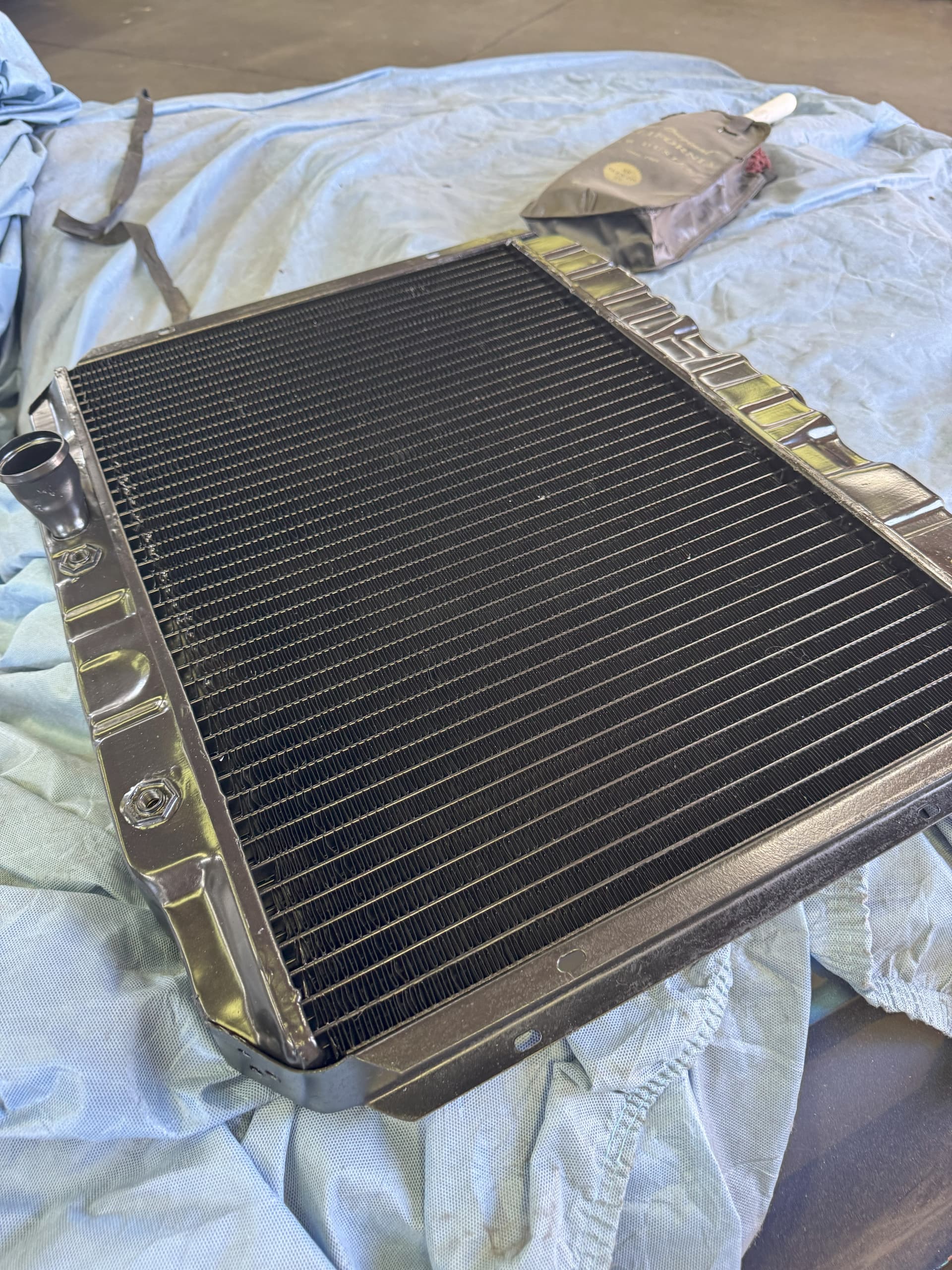

The shop heard back from the radiator shop. It was very dirty, they’ve been soaking it. It is a three row, but it isn’t the original. The mechanic’s speculation it is a replacement radiator from the 80’s back when Ford had it as a part. The plan is to clean it out and fix it.
Sorry to hear that it has languished for four years at the shop. Looking at the picture, I would recommend getting rid of the section of rubber fuel line and replacing it with a steel fuel line from the fuel pump to the carb.
The radiator is back from the radiator shop, but not yet installed. It was a three row copper replacement (because it didn’t have the FoMoCo emblem). The cost for repair was around $300, or half of what the new replacement at WCC. To think I’d thought at first about getting an aluminum replacement (shudder).
Awesome! The right fix at half the cost!
The reason there’s a hose in lieu of a steel fuel line is the roller rockers required a larger valve cover, so the steel line didn’t fit.
Don’t know what the fix for that is.
I’m glad that you got the radiator and that it’s ready for install. That is a beautiful looking engine, Cleavelands are good running engines.
Unfortunately, the only solution is a measuring tape, steel line with flare fittings on both ends, and a tubing bender. If you go this route, use a wire coat hanger as a template for your bends. The reason I recommended staying away from rubber is a lesson learned when my dad had an engine fire on his 63 Avanti due to a rubber hose (rubber hose, fuel, pressure, and a hot engine are not a good combination). Fortunately, he put out in time with minimal damage.
