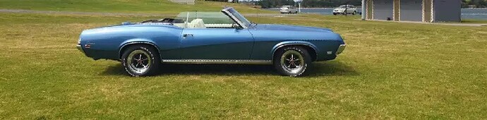

My 69 convertible has 15 x 8 Magnums on the front with i think is 235/60-15
and 15 x 10 with 255/60-15 .
fits fine, looks good, still std ride heights, no rubbing, handle well enough.
Im planning to test fit some 295/60-15 . if they don’t rub, i will fit !
