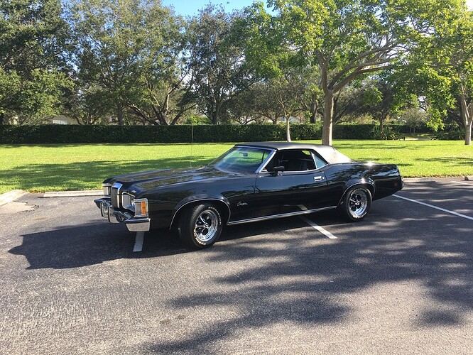

My 73 came with 14” and now has 15” wheels.

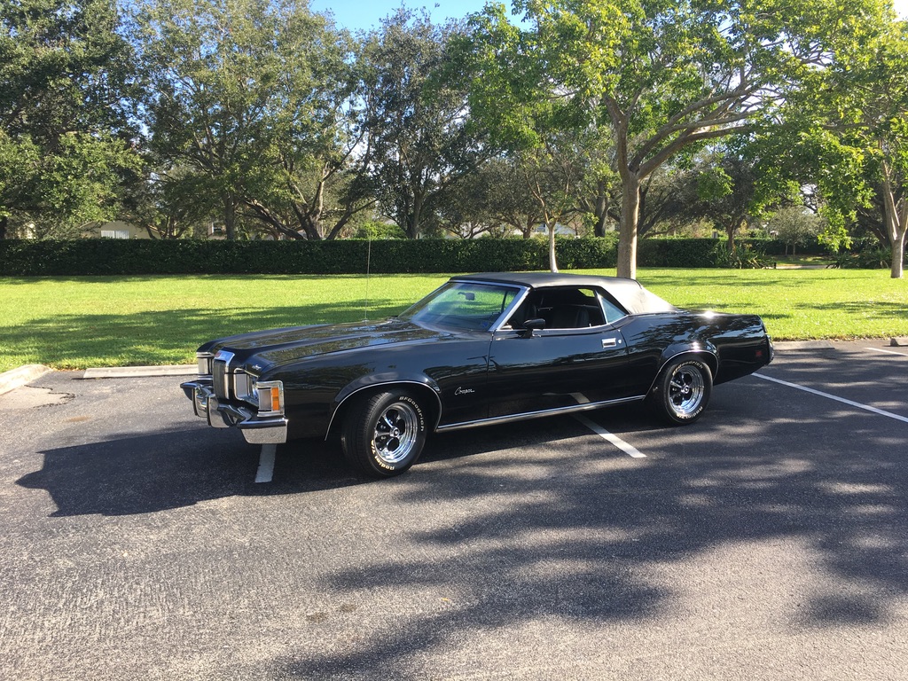

I also received mine with 14’s upgraded to 15

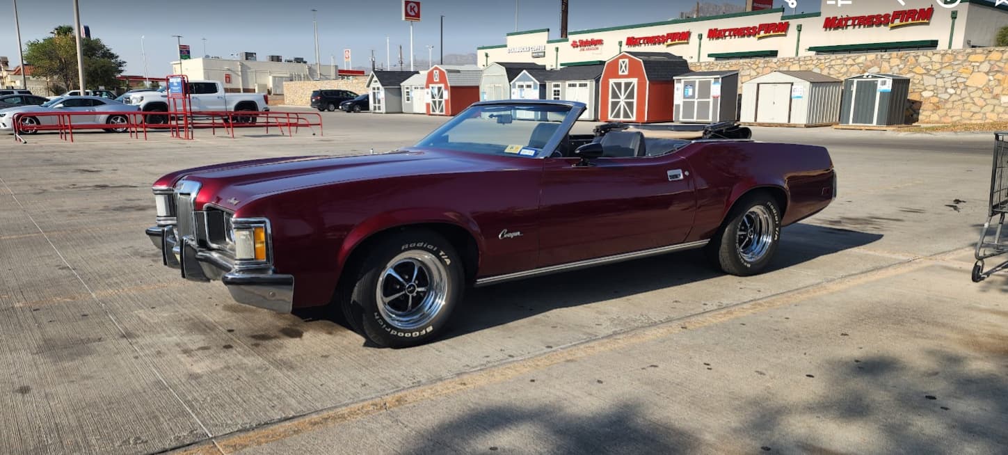

Is that a factory color and what is it?

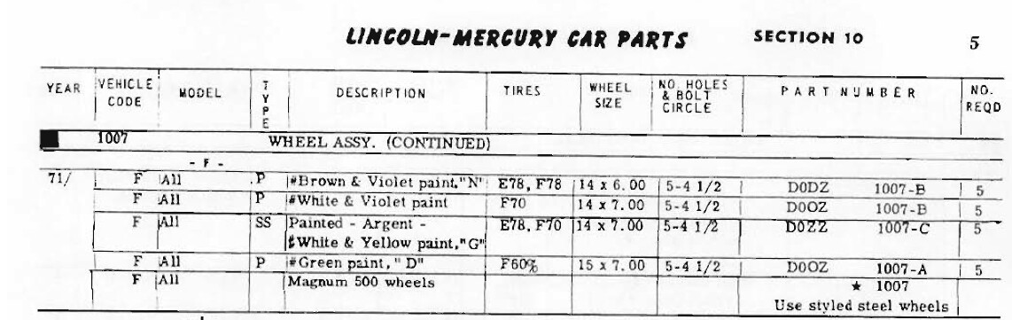

Unfortunately, it’s mostly incorrect.
There were three sizes of wheels used for the 71-72 Cougars, 14X6, 14X7 and 15X7. What size wheel the car received depended upon the tires, engine and other options.
1973 dropped the 15X7 and added 14x5.5 steelie.

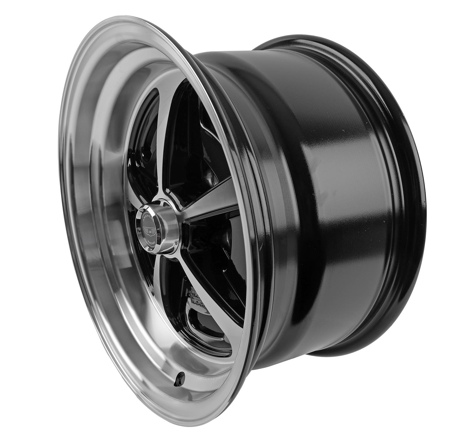

I’m running 15X8 on my 71 and had an issue with them hitting the upper control arm at full lock. The PO had used the earlier style four bolt balljoint arms, swapped to the correct three bolt and no issues. I doubt you’d have an issue with 16X8 a long as they have about the same backspacing.
American Racing VN501
It was born with Blue Glamour Metallic. I purchased it with the current color. It’s an older maroon but I don’t know if that was a factory color.
