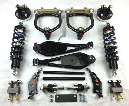

I just bought a second set for my current project. Other brands also build 3 degrees of caster into the control arm like Hotchkis and Global West
I’d suggest you contact Shaun Burgess owner of Street or Track. They’re based in MI but Shaun is from the UK. His entire business is focused on vintage Ford suspension, brake, steering, and performance bits. He’s a great guy to work with and his parts are top shelf. Prodrive is using his stuff now as well. I’m a customer-front suspension, steering, brakes, rear shocks-on my 1969.

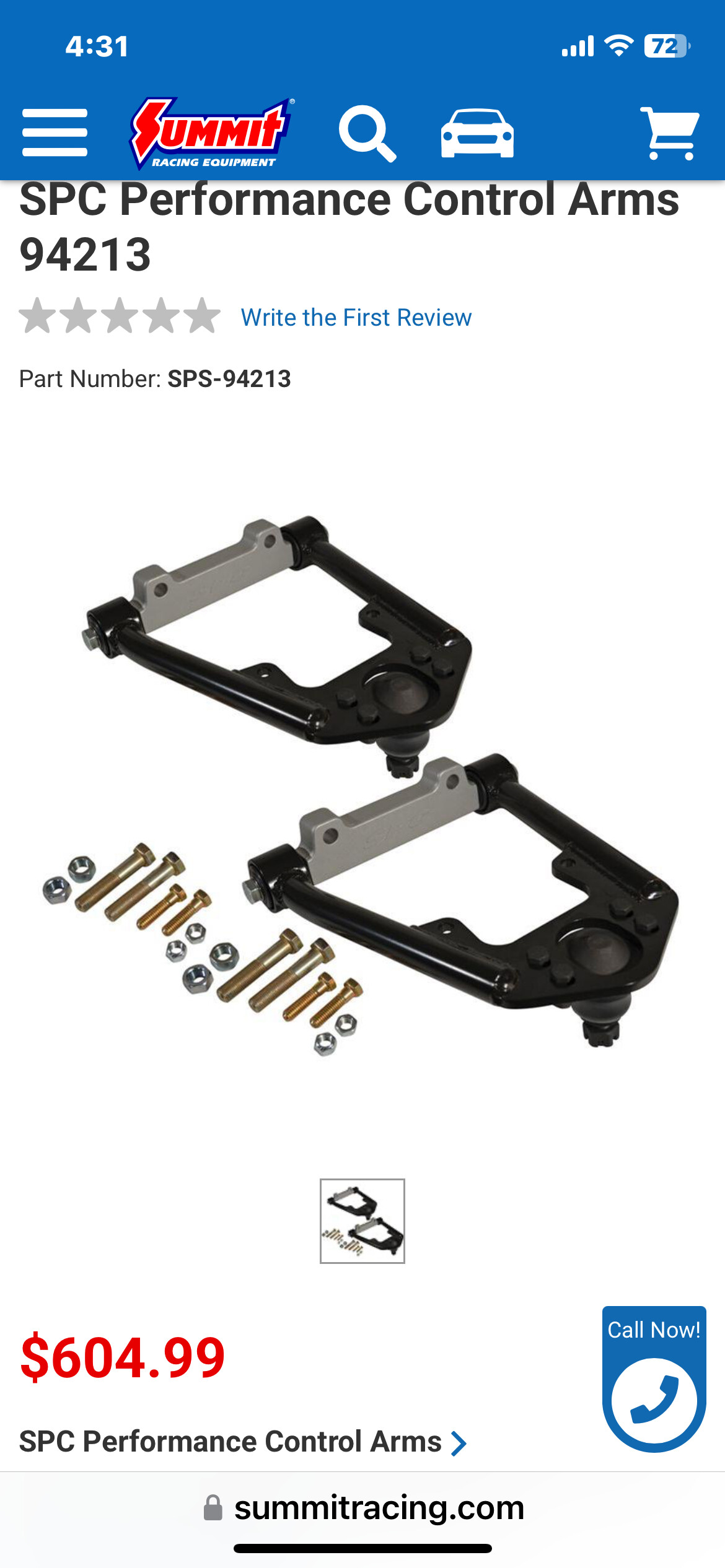

If your front tires are hitting the bodywork your caster is most likely out of spec. Also I’ll second those SPC front control arms, I’ve had them on my car for awhile and very happy with them.
