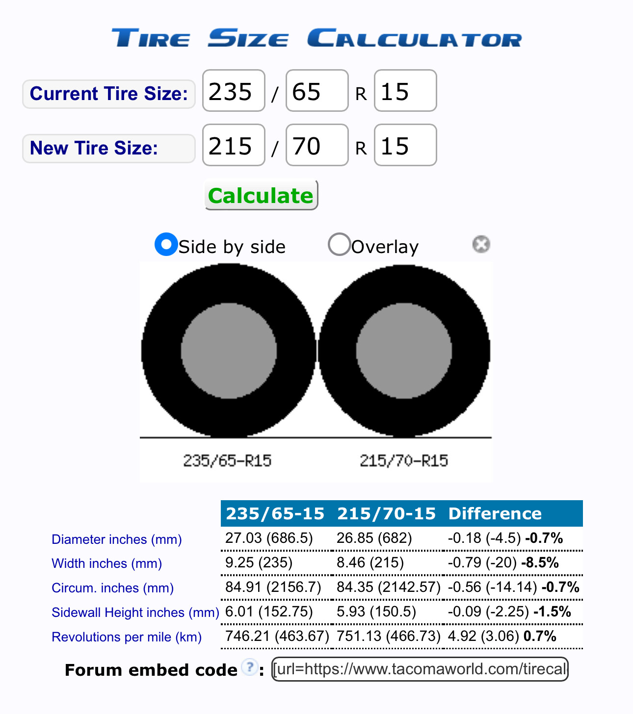

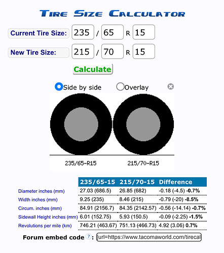

On my ‘68 XR7, I put P235/60R15 on 15x8 Cougar styled steel wheels in the rear and they rub on all turns, corners and road bumps. Front has P215/65R15 and is fine.
I am changing the rear to 15x7s with P215/70 R15.
