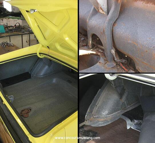

I am finally getting to the end of restoring the trunk floor and putting in new quarter panels into my 72 convertible. Anyway, I am in the process of painting the trunk floor. Thanks to Badcatt and J speegle I have pictures of the original paint. My question is where can I fine the Zolatone paint or something similar. I had bought some speckled paint from Eastwood, but it is too light. The trunk paint seems to be fairly dark. Any help is appreciated in finding a source. I do prefer the rattle-can as opposed to buying a whole quart.

Unfortunately check my receipts and it won’t help since the supplier no longer carries the product I used. I choose to respray with the lighter of two colors used that year and since what I could find was only two color my lacks the white specks in the final look (left side of the picture below. I shot it with a “kit” for about $50. In the kit I got a quart and shot across the area over the top of the tank just because I had enough product mixed.
