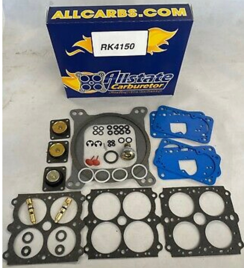

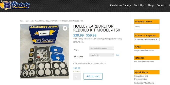

I’ve had excellent results with carb kits from Allstate Carb. They use mostly genuine Holley parts at a much less than Holley price.
Those seem to have everything but the secondary diaphragm which will not be needed on a mechanical secondary double pumper.
