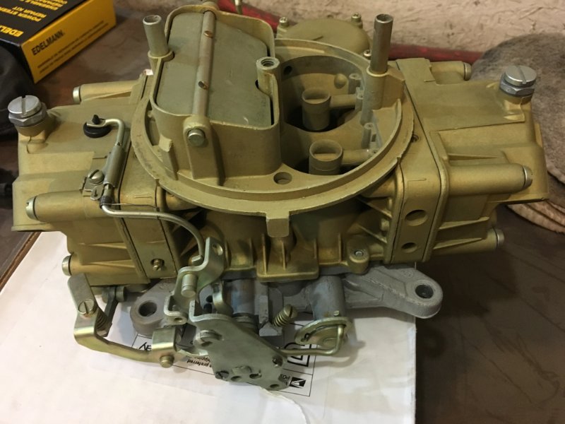

Which Holley carburetor did Ford install on the first 390 67 cougars ( the 66 July 4th cars )
Im looking to find out any good info , on which Holley carb Ford used on the very early big block 390 cars. The July 4th 1966 cars.
Would it be a C6OF- 9510-N or M
or a C7OF-9510-D or B
And what would the carb date be ?
Thanks for any help

The determining factors are type of transmission and whether or not the car has Thermactor. No Cougar received C6OF-N or M.
From the Mustang and Cougar Tag Book
For 1967
390-4V S code STD C7OF A
390-4V S code AUTO C7OF B
390-4V S code STD C7OF C CA emissions
390-4V S code AUTO C7OF D CA emissions
That narrows it down to 390-4V S code STD C7OF A unless it’s a CA car with emissions.
Mine is a CA car auto.
I own one of the early scheduled to be built July 4th cars. Marti report says actual build date is 66 days later.
Im looking to find a date correct carburetor for it.
Its an automatic so a C7OF 9510 B or D would work.
But it would have to be atleast an early June 1966 carb is what Im figuring then.
