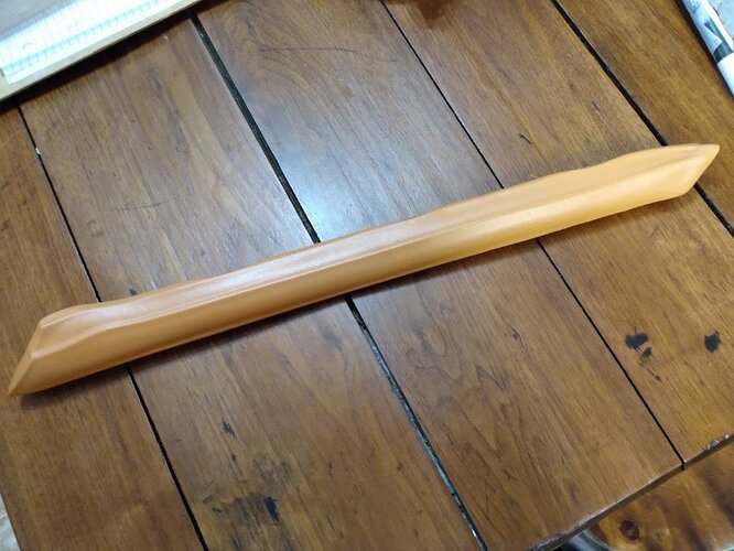

I am trying to dye some of the original padded wind lace pieces out of our 1968 Cougar with the 2F Medium Saddle decor interior. They original parts have faded to an almost Ivy Green color.
I searched the forum previously and read that the SEM VP-5739 Medium Saddle was a good match. I ordered a can from NPD and after drying the color is more like pumpkin than saddle. There is no way that this color is a better match to the original medium saddle color.

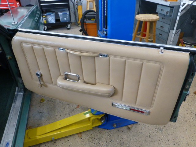

I’ve read over several threads and asked the question to others in the industry here and there and the answer seems to all be the same. Nobody makes a close color match and you’re better off getting a custom batch mixed for best color matching results. That’s why WCCC doesn’t carry a Saddle dye in their inventory. I’m in the same boat switching my interior over to saddle and will be asking my local paint distributor to see if they can prepare some custom mixed SEM aerosol cans.
That color seems to match closest to the vinyl that was hidden from the sun.

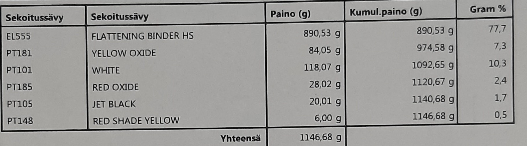

I have an Imronel mix code, a local paint shop painted my console in 2017. I think that they made a very good job. The amounts are gram weights.
Markus.
