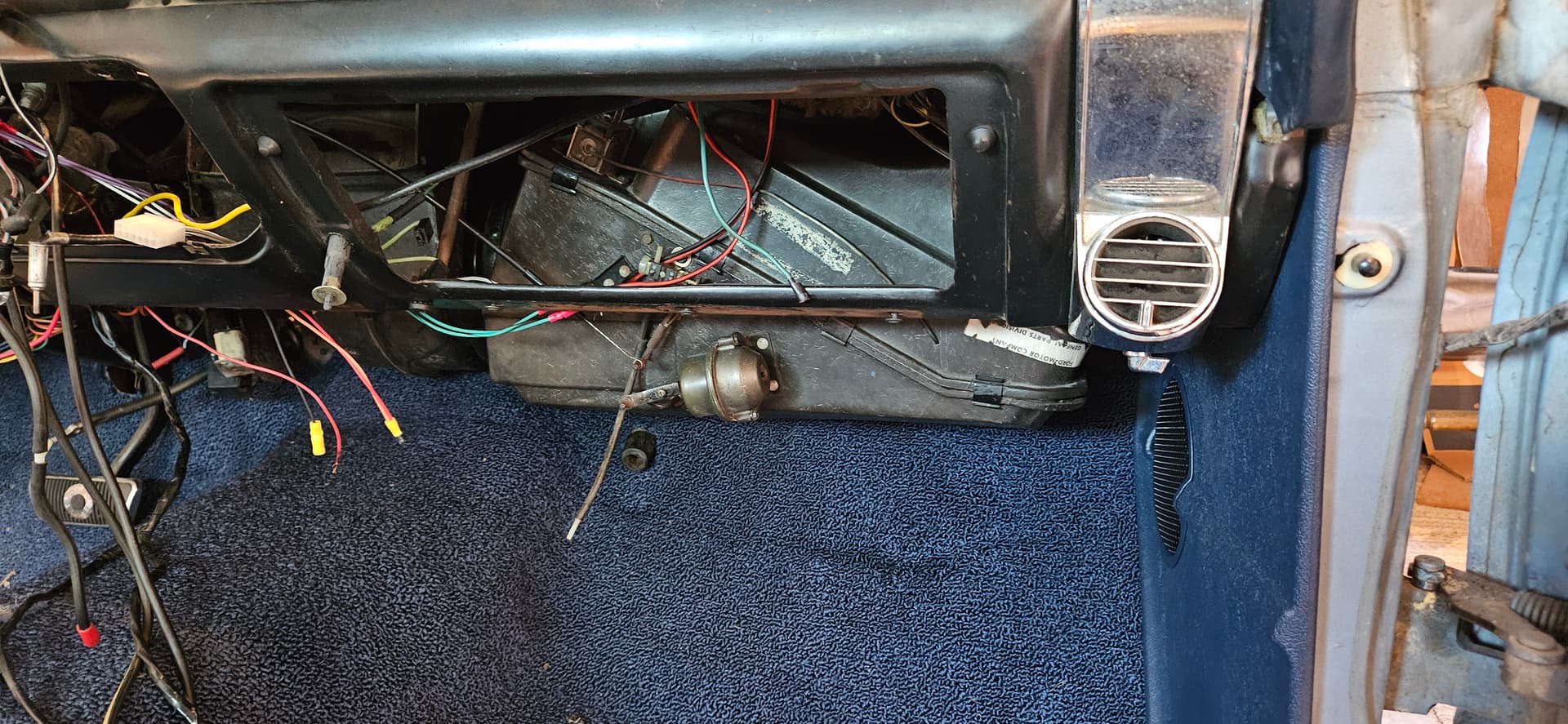

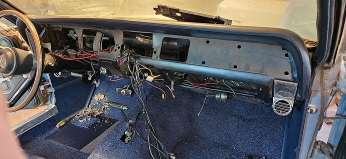

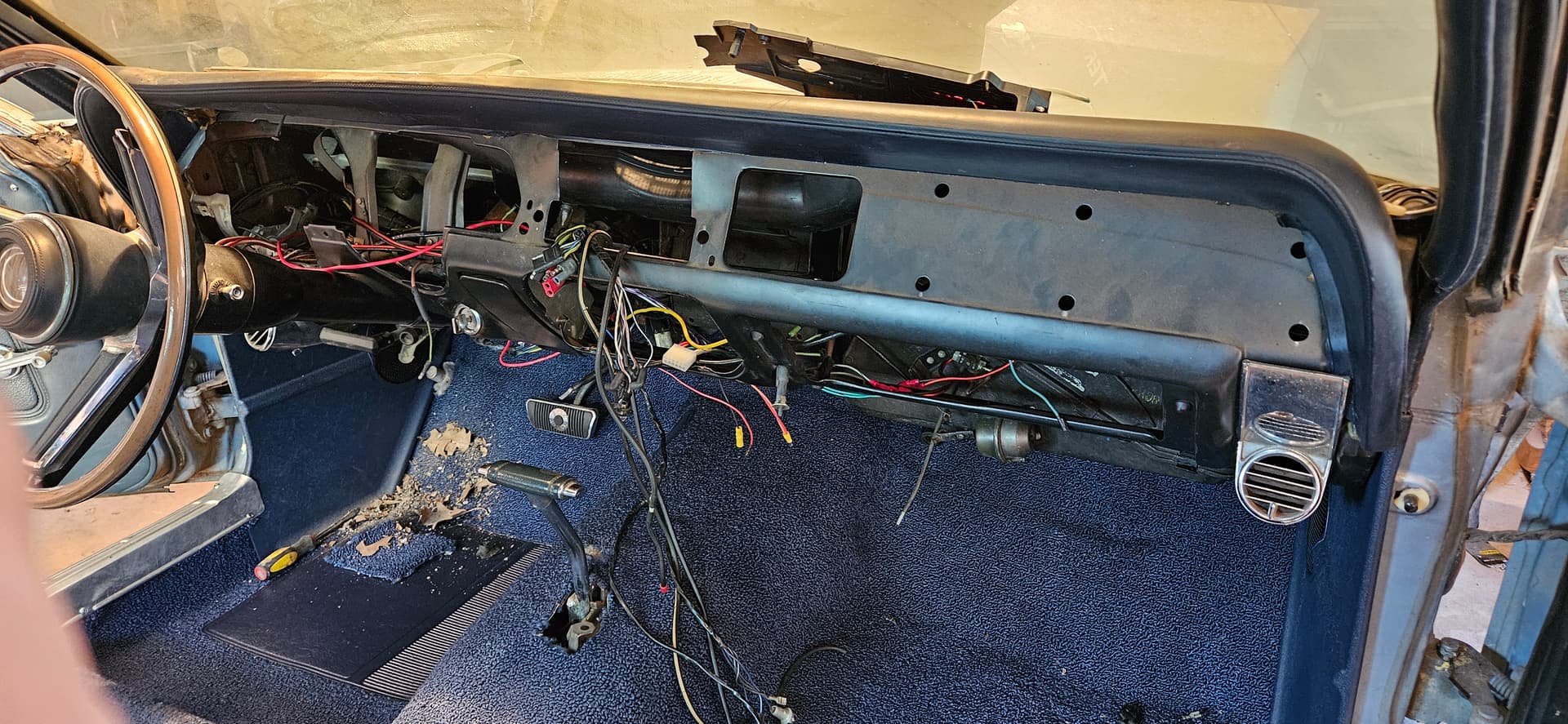

Many thanks to all that offered advice! I did manage to get it in there, without damaging anything, and without pulling the carpet! (that mass-backed stuff is challenging to lay down and get in place!)
Thankfully my buddy came over and helped me by throwing nuts on the studs as I got it all in place.
It was not easy, but it’s in! Now to find all the brackets and screws I’ve managed to lose over the last 18 years…

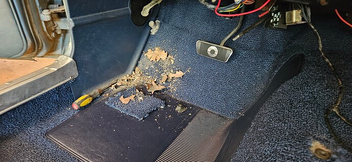

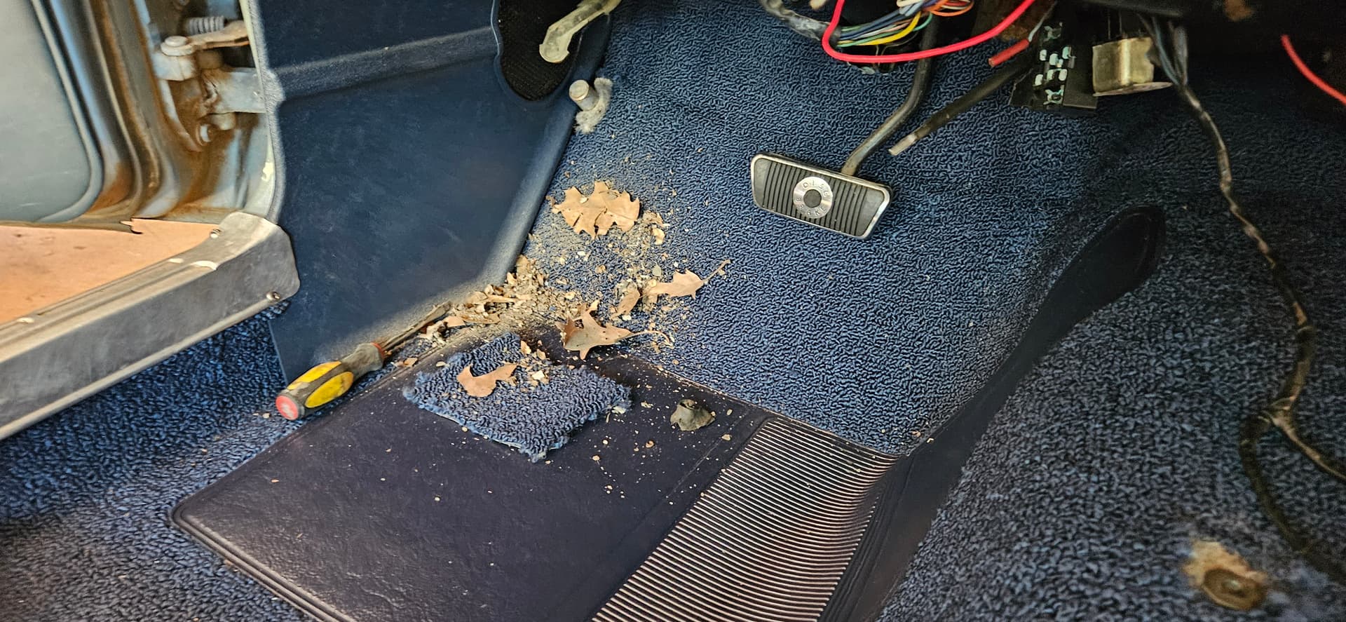

I also discovered that the fresh air vent on the driver’s side doubles as a storage device for leaves, bugs, and old mud dauber nests! I was lying under the dash, and demonstrated its operation to my friend who was helping. bap Right in my face, and onto the new carpet. lol
