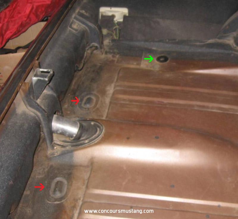

Nice work on the panels in the trunk. I did the same only different. Used two 71 Mustang floors to reduce the number of seams and the amount of welding
One thing that the panels will lack when your done unless your going to add them is the drain plug holes at the rear (red arrows) and the dolly holes (green arrow) one each side
Also the panel will not have the seam (bend) towards the rear end of the panel as well as other details. Some that can be seen when you compare some of your pictures and the one below. But as usual not allot of choices short of NOS or having talents much greater than I have as far as sheetmetal work

I may add the plugs at the rear of the panel. Dolly holes also.
Recognize this isn’t perfect, but need to be realistic. This isn’t a 429CJ car, and is a 4 speed conversion. Best case a $25k car. With a concours correct trunk floor probably also a $25k car.
Although this was a San Francisco car from birth to 2014, the factory trunk floor was toast from front to back. I just need a solution that’s adequate and not a total embarrassment. With the trunk mat, trunk paint, and spare installed, nobody will see it, it will be solid, and most important - back out on the road!
