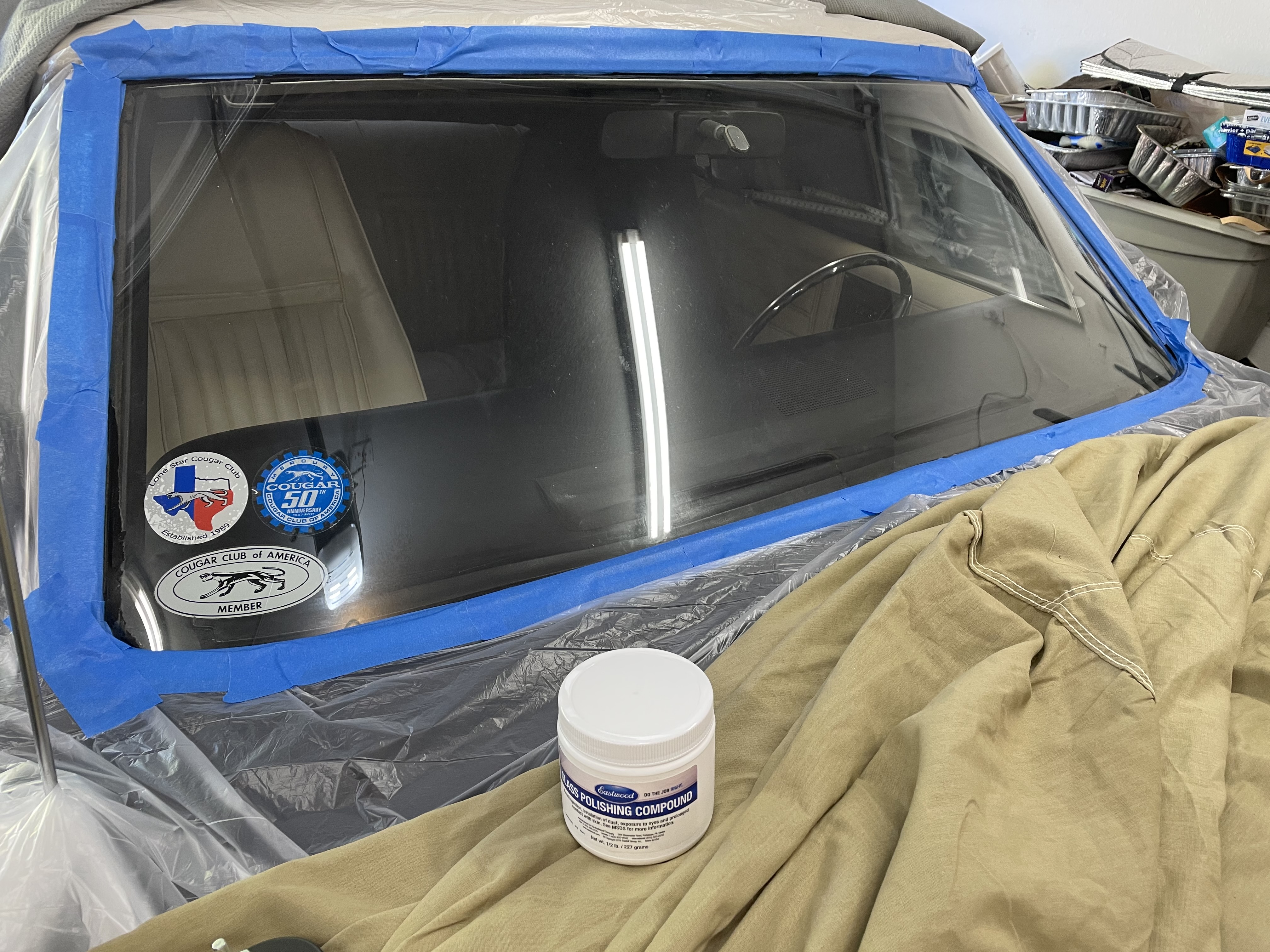

I’ve had some of Eastwood’s glass polish sitting on the shelf for a while and finally decided to go for it. 50 years had taken their toll on the outside of the glass but there weren’t any significant chips or deep scratches so I decided to see what this stuff would do.

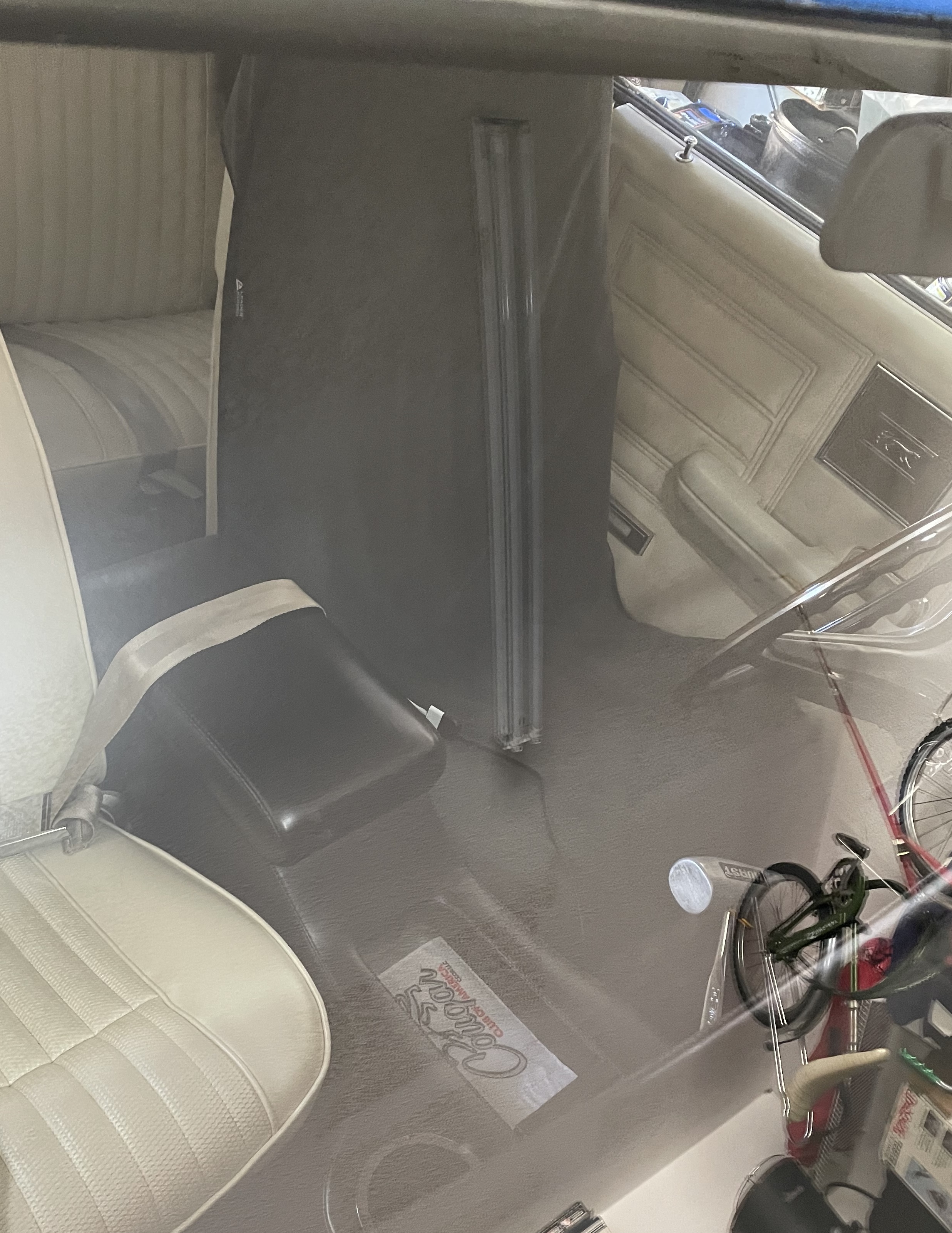

I wasn’t able to really get a good before and after pic so these will have to do until I can get the car outside (at least for the end result). The ‘after’ pic especially doesn’t show how crystal clear the glass is now but I can tell you this stuff worked miracles. :dance:

Does not do much on tempered glass except remove water spots. Its best use is for light wiper burns. If you got the patience you can get out deeper issues on windshields but you will create an optical distortion.
I should say that my windshield was mostly just foggy, not scratched or chipped. It had one noticeable scuff that looked like a wiper mark that was right in my line of sight. All that’s gone now.
It took about an hour of actual polishing to go over the entire exterior surface twice. Make sure you get the interior surface as clean as possible before you start and don’t skip the respirator. You definitely don’t want that stuff in your lungs.
