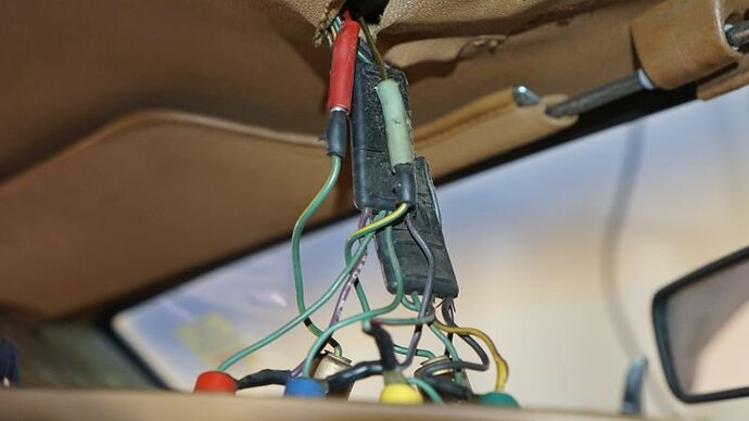

I have a problem with my overhead console. It doesn‘t work, I got all the wires, but which one belongs to another.

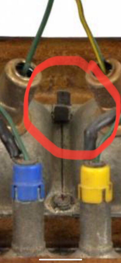

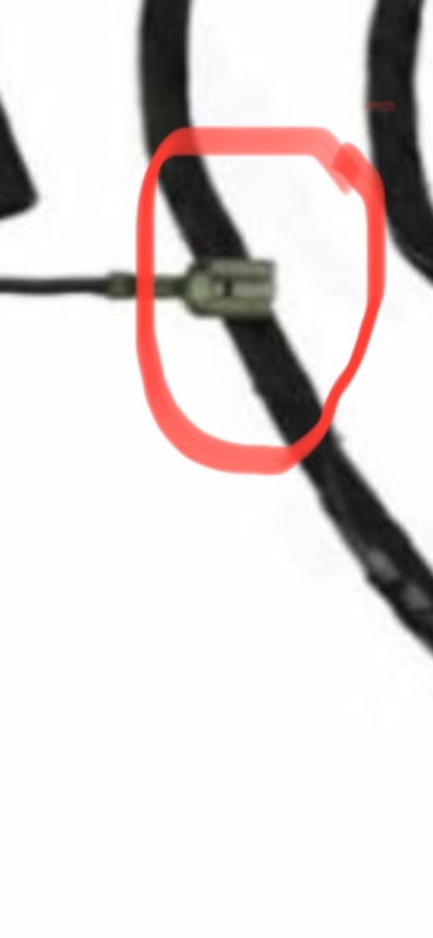

There‘s the upper overhead cable and I red-marked two wires. Are both for ground? And the wire „without the hole“ belongs to the back of the overhead console, especially to the part I also red-marked (see the picture)?

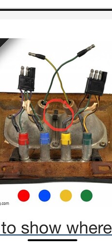

Here’s a picture I snapped of my 68 overhead console connections prior to disassembly. Might help if your aren’t able to read the schematics. The terminals you have circled are typically ground returns. The whole console wouldn’t light up without these connected properly. Unfortunately I didn’t have a good picture all of the connections.
