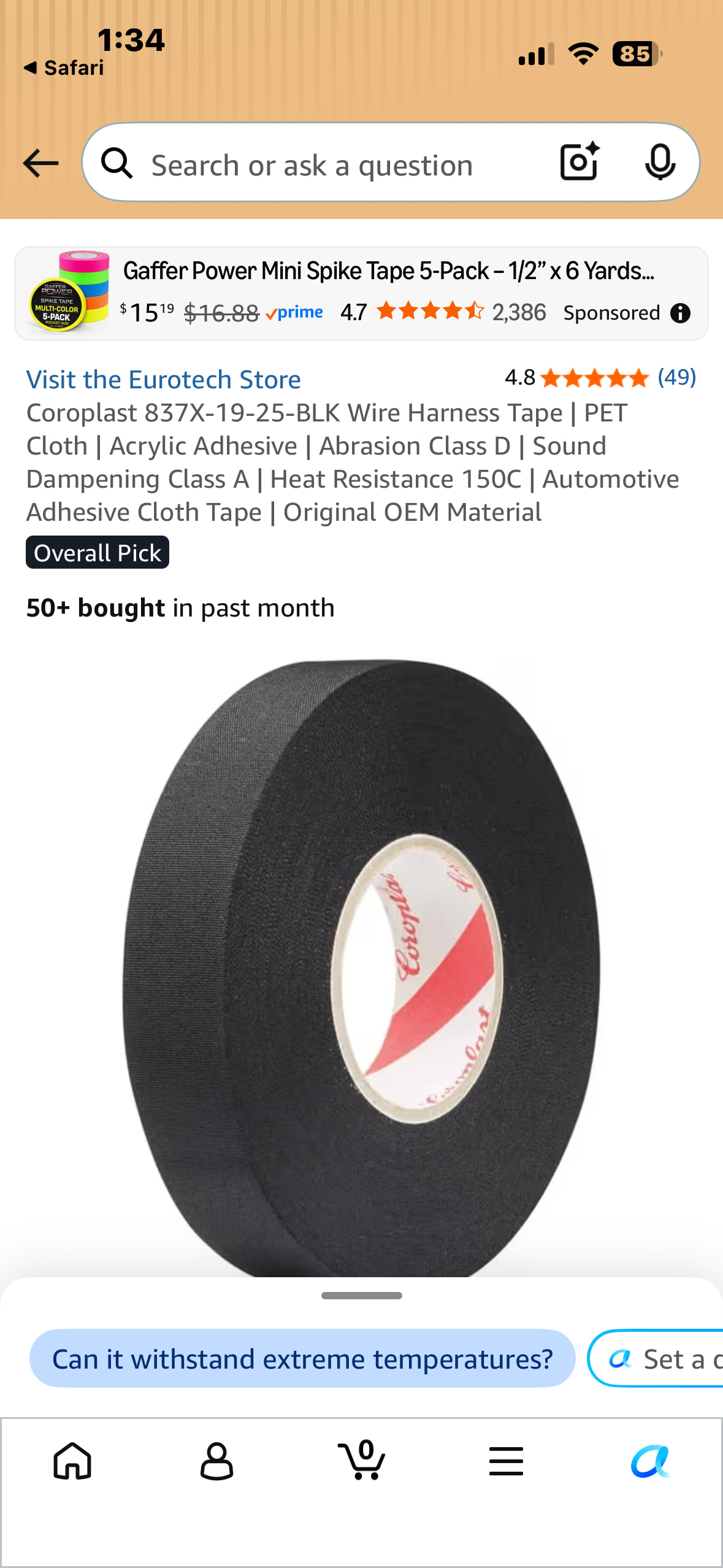

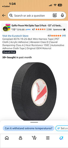

I use Coroplast tape for the rear harness and engine compartment side. It is Fords current spec for service repairs. It’s a cloth tape
