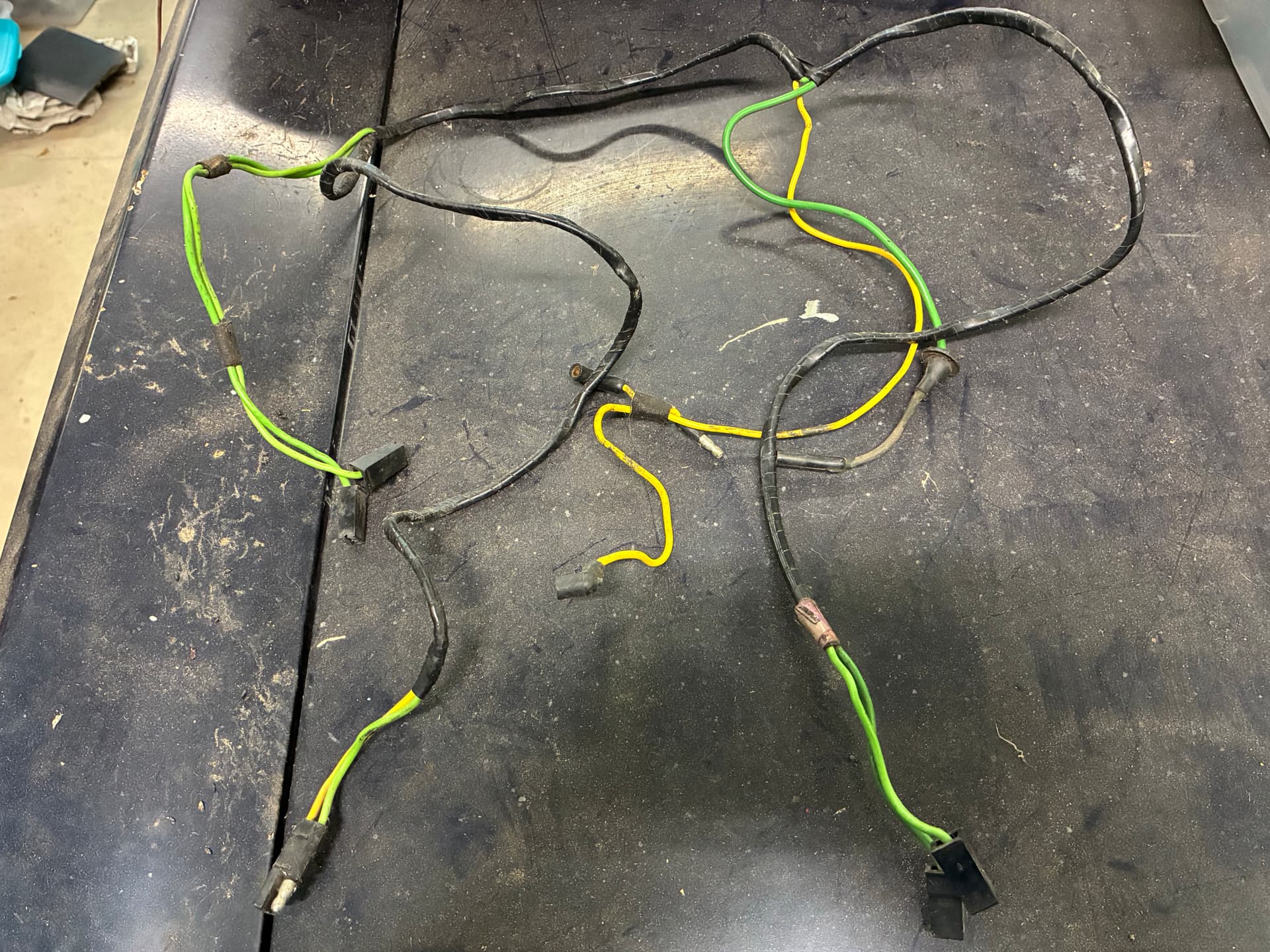

Anyone recognize this? Found its way into my parts collection but I don’t know what it is.
Maybe Midlife can is that. I see heater connections but what it fits is lost on me
It is a separate harness so it most likely is for something that was an option, perhaps A/C. I can see that there is still a paper ID tag wrapped around it. Can you read any of the numbers on that tag?
I tried a bunch of different searches with what I thought the tag says but came up empty. I’ll get a close up of it maybe someone else can read them.

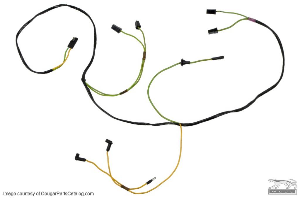

Looks like tilt away harness (68-69) to me
Definitively an AC harness. Note the green wire colors with black covers over female spades, and a small grommet that goes into the firewall for the AC clutch.
I think Cougar Bill is correct. Looks like a ‘68 Tilt Away harness.
If for A/C is a 67/8. I still think tilt, but ya know I ve been wrong before!!!
The AC connectors are individual on the green wires. The tilt away they are the type shown.
Sure looks like A/C per WCCC catalog.
well that settles that!
Midlife for the win
Plus, you can tell by the thickness of the A/C wires. Very heavy gauge compared to similar under dash wiring.
Looks like the AC harness now. The green wires go to the icing switch.
