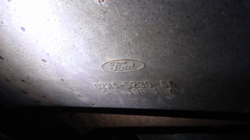

This is what Ford calls the Quiet Tone muffler. My 71 351V and my 72 Q code both had these mufflers as part of the factory dual exhaust system. Is your car a July '70 Build or a July '71 build? If the latter, that is late in the model year, and it’s possible you got a part destined for '72 Build.

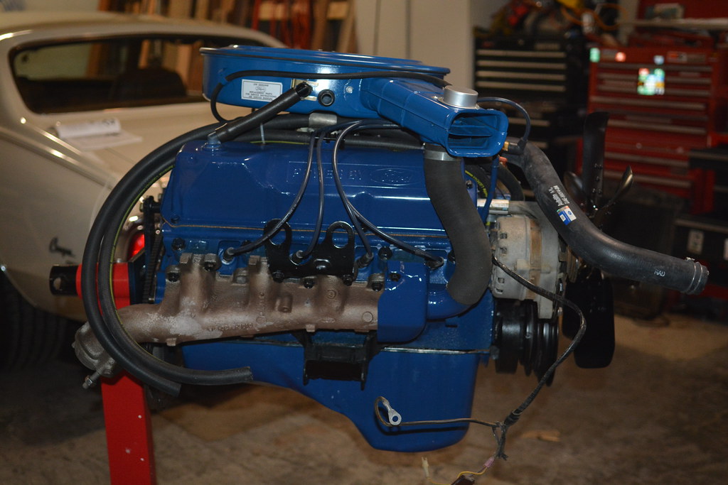

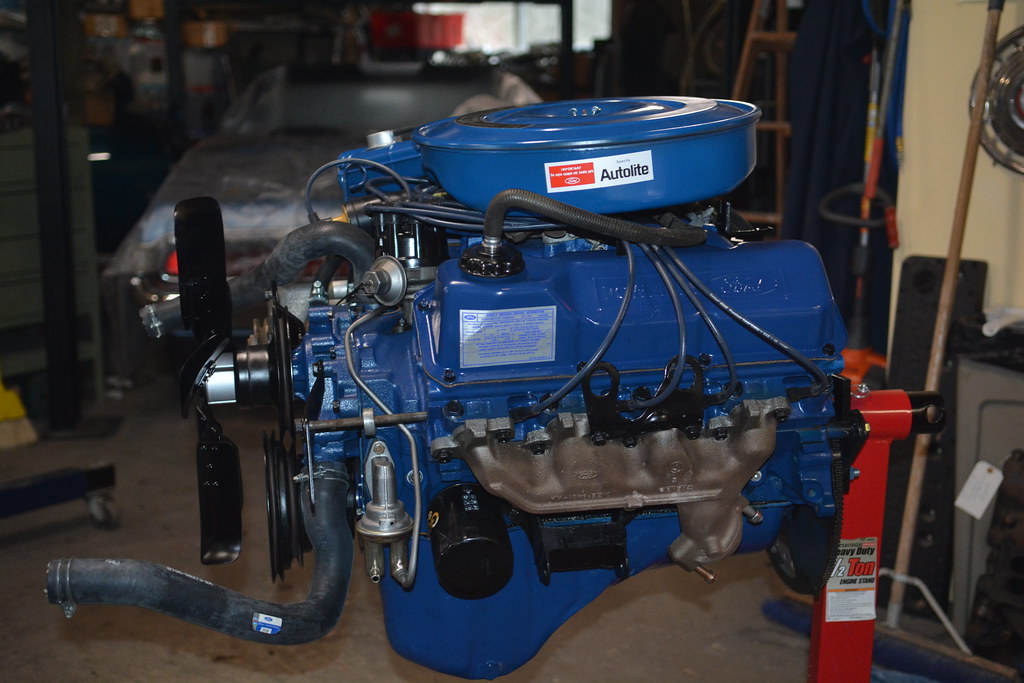

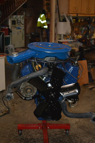

A little update, I have most of the accessories added to the engine now.
I decided not to use the 4 blade cooling fan that was originally on this, but will save it. I also decided to do a dual exhaust. Factory style parts of course. It was missing the dual diaphragm advance and assorted hardware when I got it, I am for now going to stay that way. It will be easy to add it later if wanted. I am thinking about electronic ignition but have not committed to it yet.
I will also have to repaint the air cleaner as it is not the same color as the engine.
I hope it will be warmer in the shop as I get going on the engine compartment restoration and brake job.

Looks nice. I would be itching to get it back in that gorgeous '71. Great car. What kind of electronic ignition are you thinking of using?
