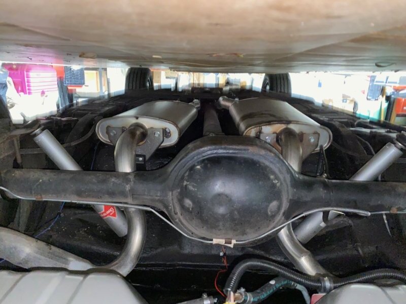

I’m pretty sure this is a 8" rear, maybe I’m wrong.
here’s a picture of it…Not sure why it came out upside down, the original picture is not this way.

I’m going to say it was a 9" only because an 8" posi in 69 was a rare bird. This also had to see special ordered, IMO, either by a individual or the dealership. 351W 4bbl, 4 spd, 3.25 posi, heavy duty susp, wasn’t the usual setup. sounds like someone wanted a Eliminator type setup in sheep’s coatings. Your pic from last night, that’s a 9". I think someone changed out the gears for better gas mileage. As for the axles, the same 28 spline was used in both the 8 & 9 due to housing width being the same. My parts interchange bock shows many times it was done. Saves production costs.

I always understood the 9" rear ends have a “Bulge” on one side of them and the 8" is more evenly rounded (like what my picture indicates).
I’m still going with an 8" rear-end.

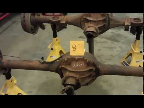

This You tube video shows the differences as well, and if correct I currently have an 8".
