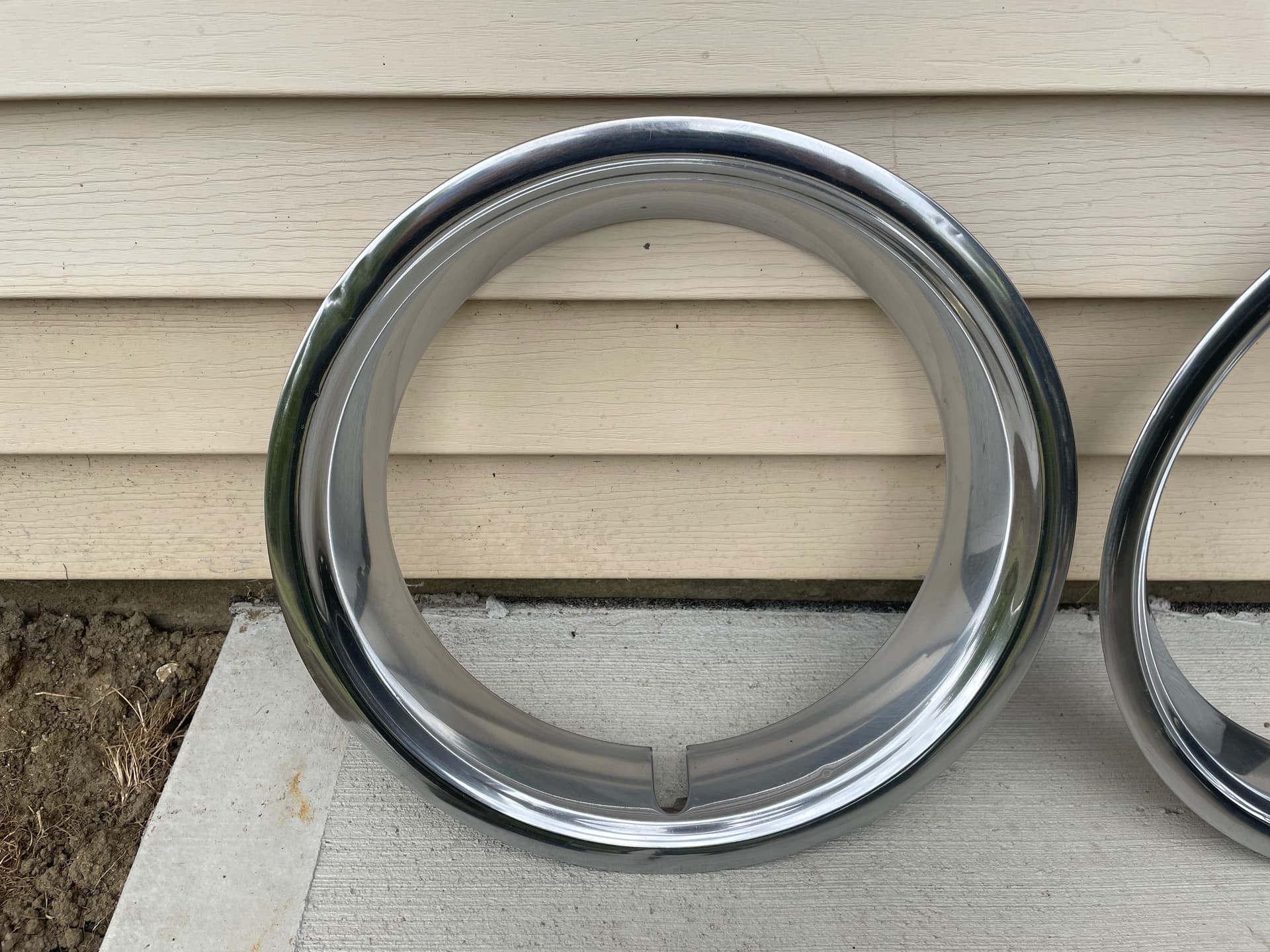

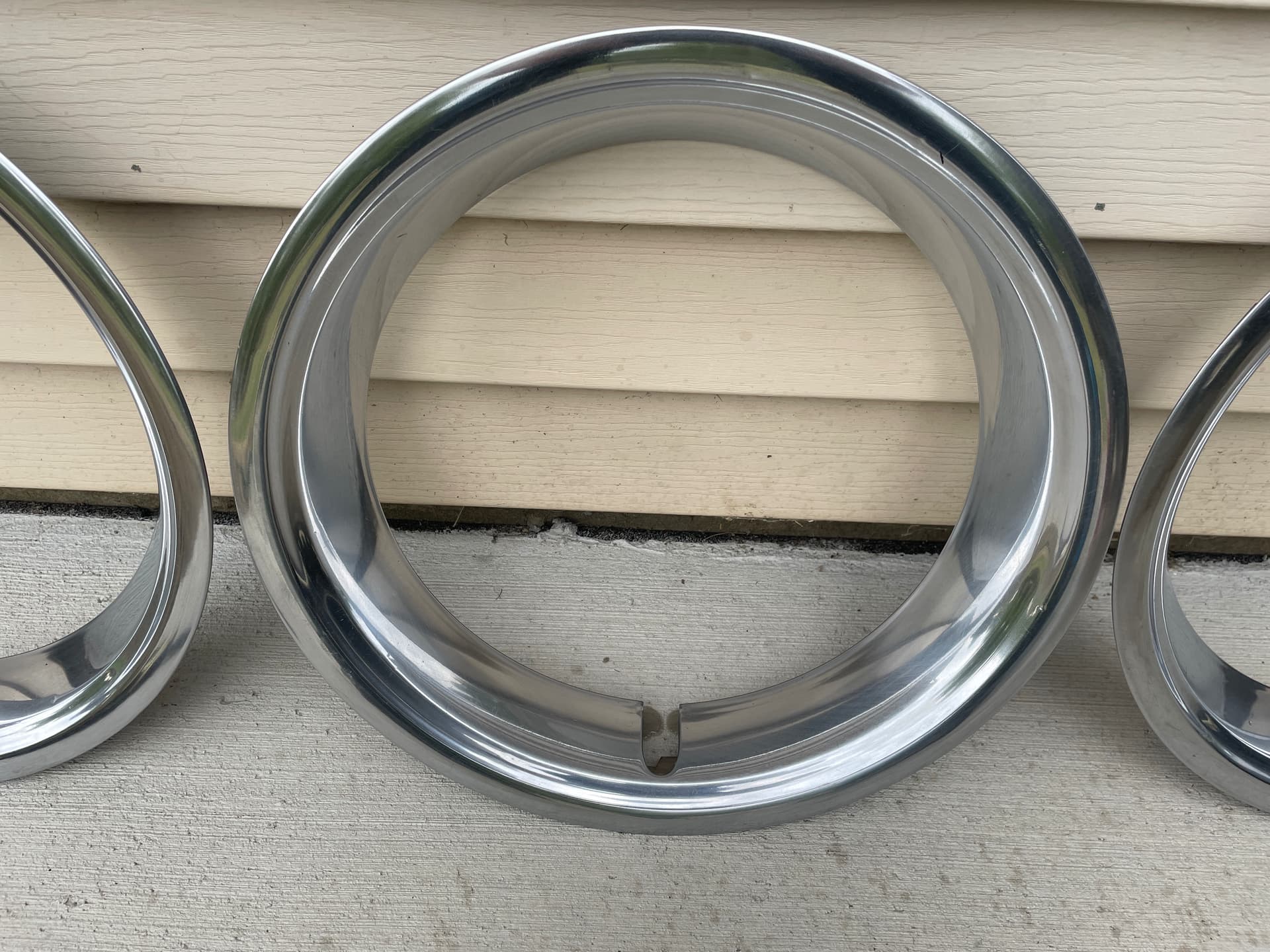

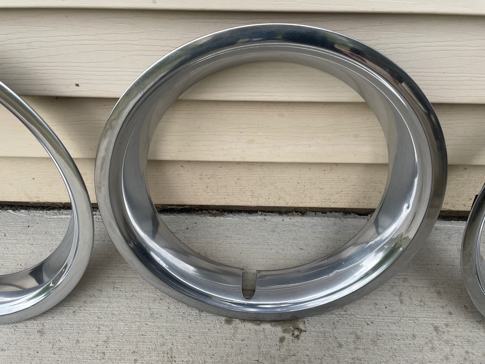

I have a set of four with cracks in the typical areas and trim rings
Thanks for the link, but I want to use a trim ring.

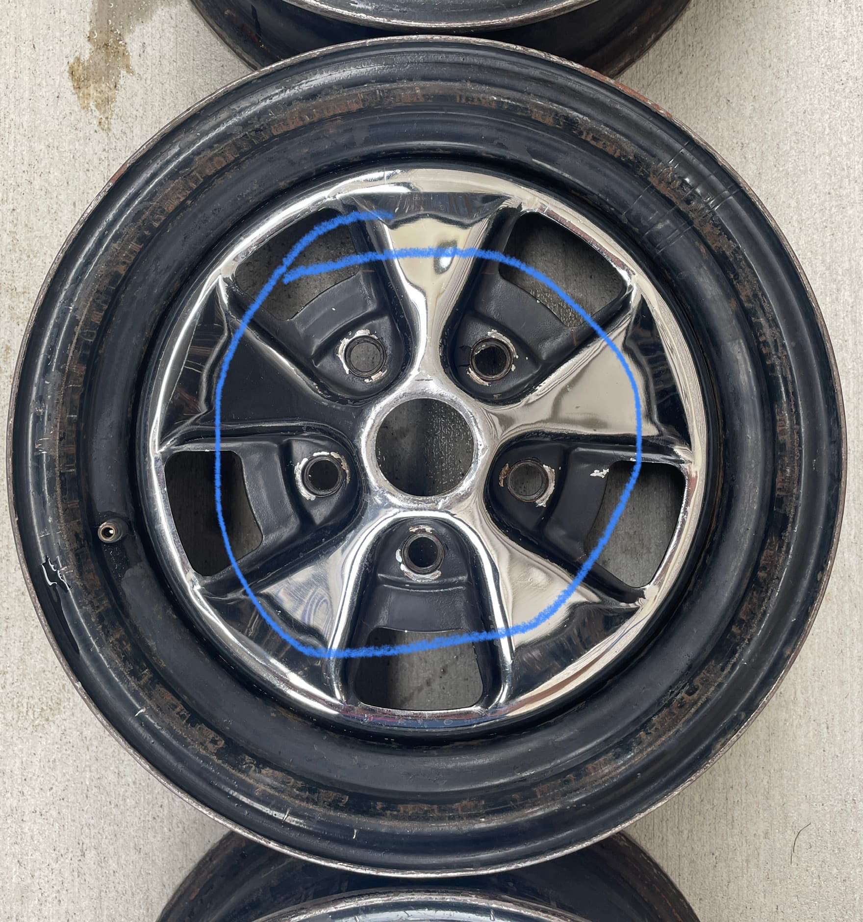

Cracks are usually found around the corners of the wheel openings, or around the rivets. I havent found anybody who will repair them.

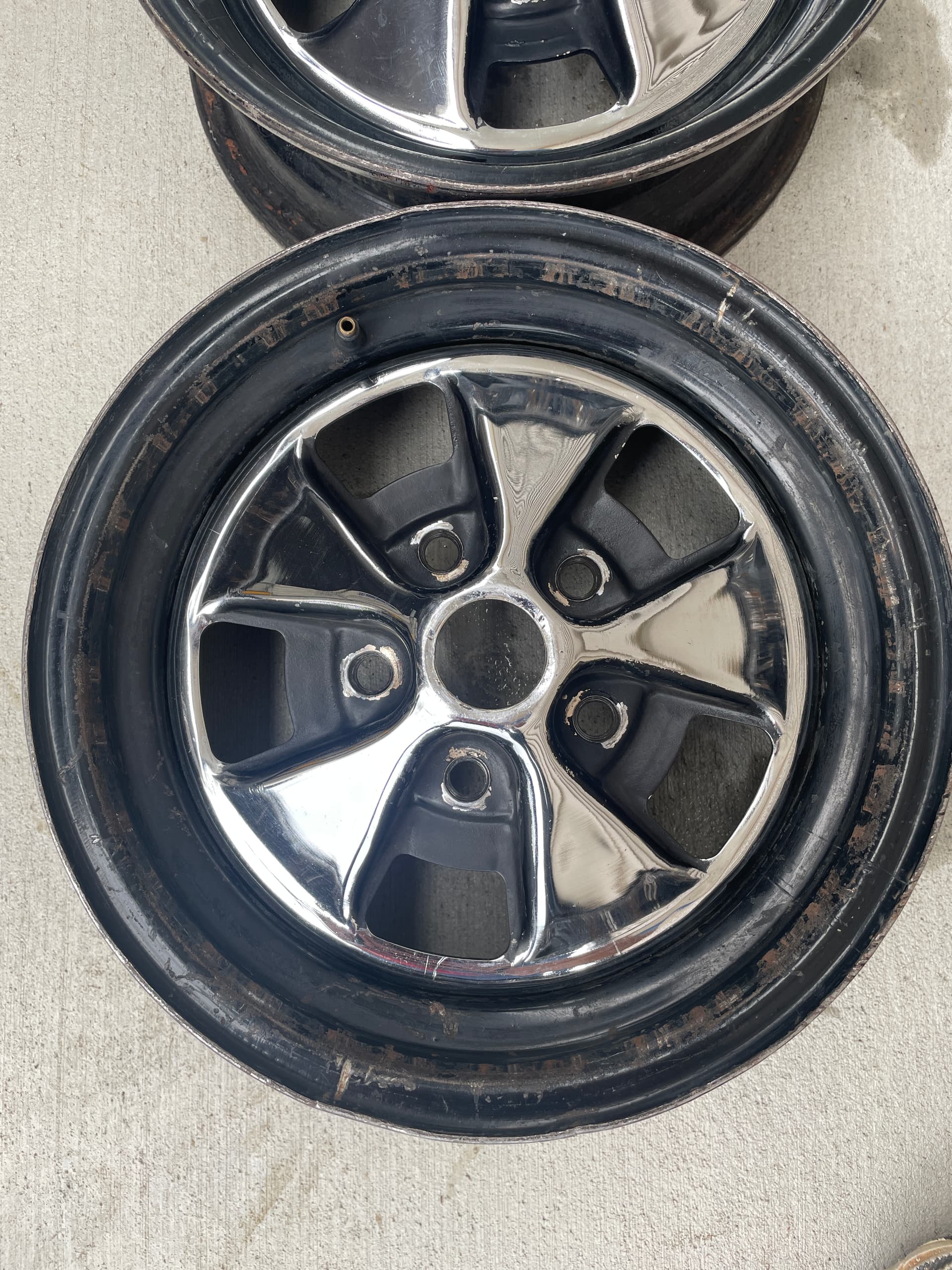

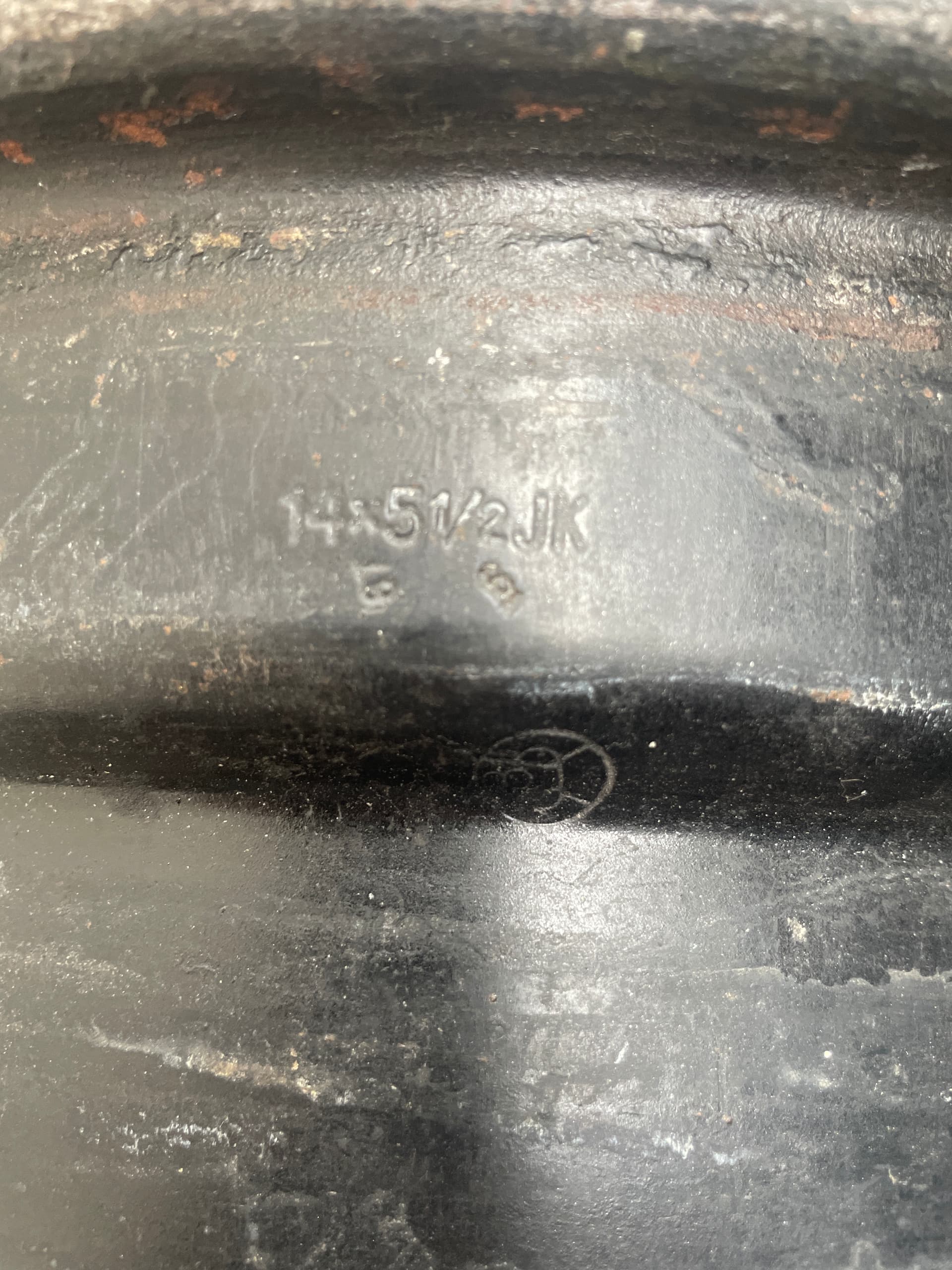

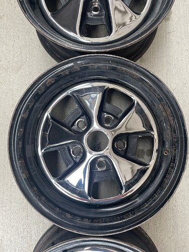

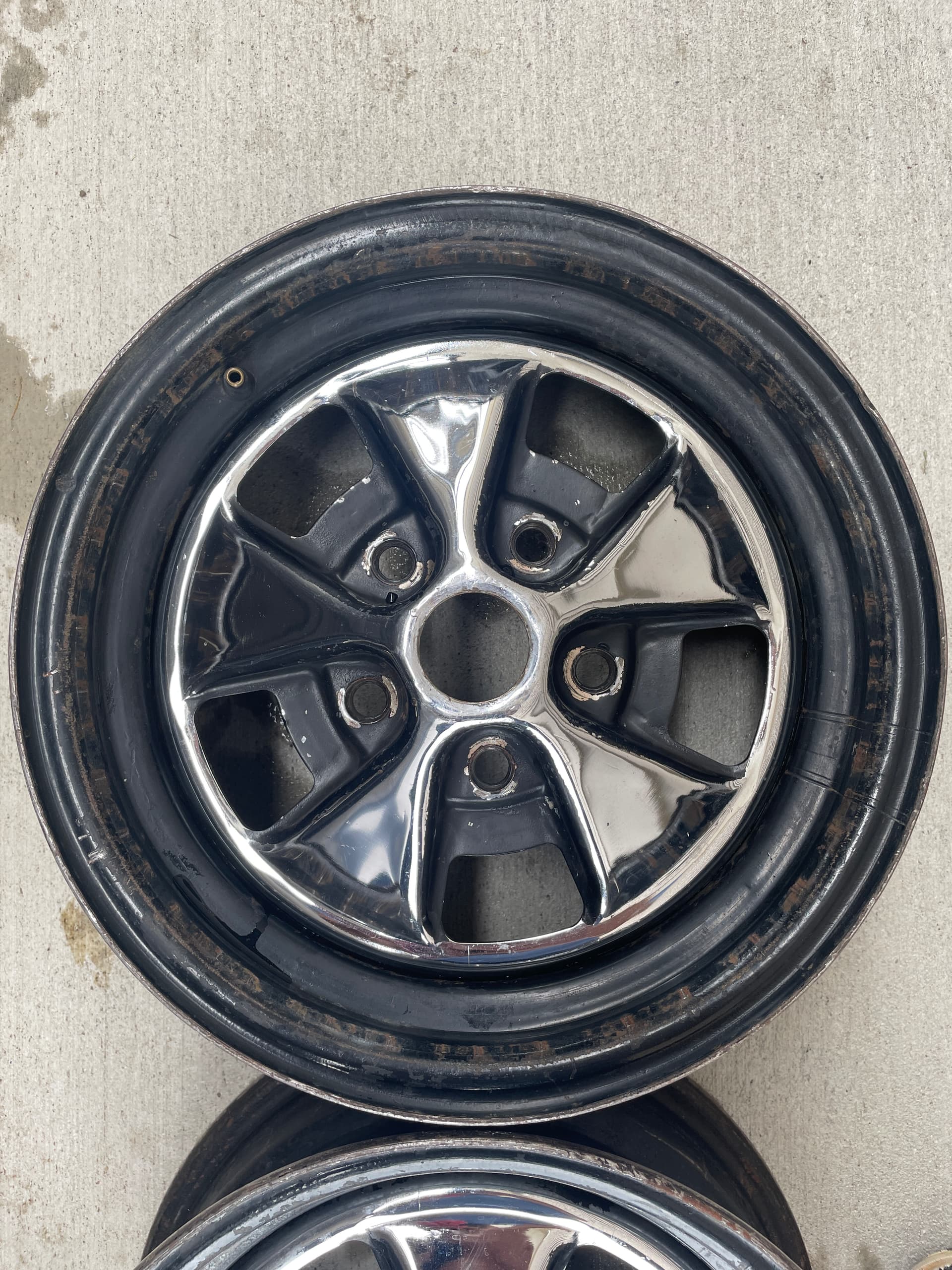

As promised way late
Rims…only one has cracks…lug nut holes are worn pretty good
67s I guess
Yes, those are ‘67 wheels. I am looking for 14x6, but thank you for responding.
A pair of $20 wheel spacers bought from O’reilly Auto Parts will provide the clearance needed to fit 67 wheels over 68 brakes. You’ll want to upgrade your lug nuts to “reach inside” the lug holes so there is adequate thread grab.
