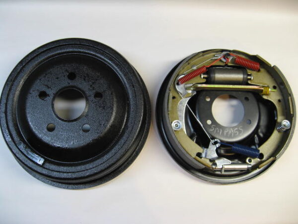

OpenTracker has an 11ā€ kit:
Cobra Automotive offers similar, and still has 10ā€ dia kits up.

The 11ā€ x 2.25ā€ kit won’t fit 14ā€ wheels. Also, you lose 1 sq in of swept area.
The 10ā€x2.5ā€ backing plates were found on 1963-71 Fairlane SW and Rancheros.
My ā€˜67 Race car setup came out of a 1967 390 Fairlane SW. I used 7/8ā€ wheel cylinders after the NOS Ford Shelby-size 13/16ā€ wheel cylinders started leaking (and couldn’t find any out of town). An adjustable proportioning value sets the front/rear bias. Initially, I ran the heavy finned rear drums but still managed to turn them blue due to the heat from heavy braking.
Based on my observation, the only difference between the 1969-70 2ā€ backing plates and the 2.5ā€ backing plates is the length of the anchor pin - it’s slightly longer. I never found a source for new anchor pins. Theoretically, you could machine a new pin and use the 2ā€ backing plates. The finned drums are the same for 2ā€ or 2.5ā€ applications (Torino).
If you make an adapter ring to center the drum, the 2.5ā€ drums and shoes from a 1991 Explorer will fit. The 1991-94 Explorer 581 shoes have bigger rubbing tabs on the side of the shoes and help guide the shoe better.
