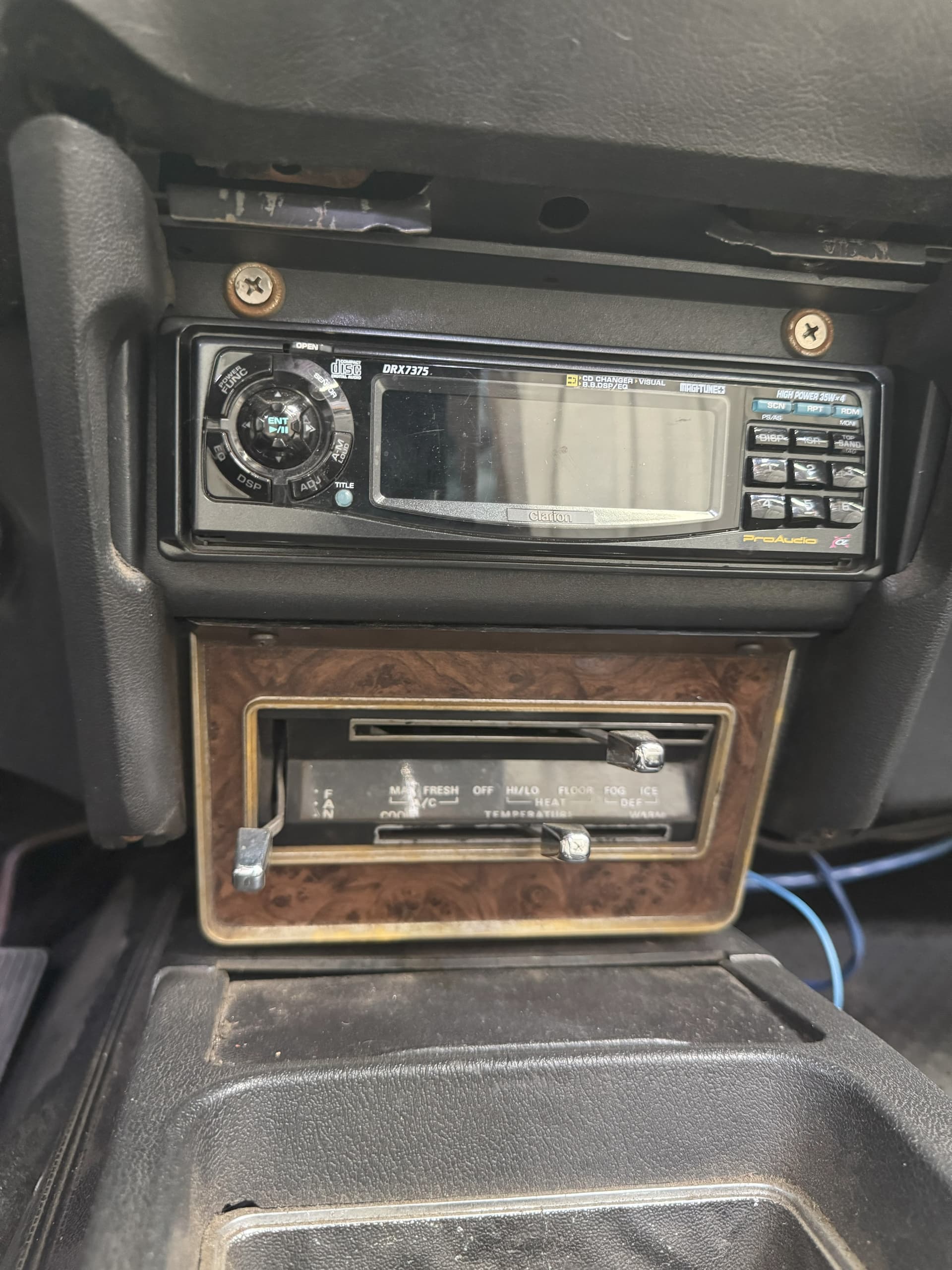

I’ve also a need of an XR-7 burl, as if I’m going to restore my radio bezel, all that’s available in reproduction is black Standard.
Reproduction Black Standard Radio Bezel for the 1969 and 1970 Mercury Cougar or Ford Mustang

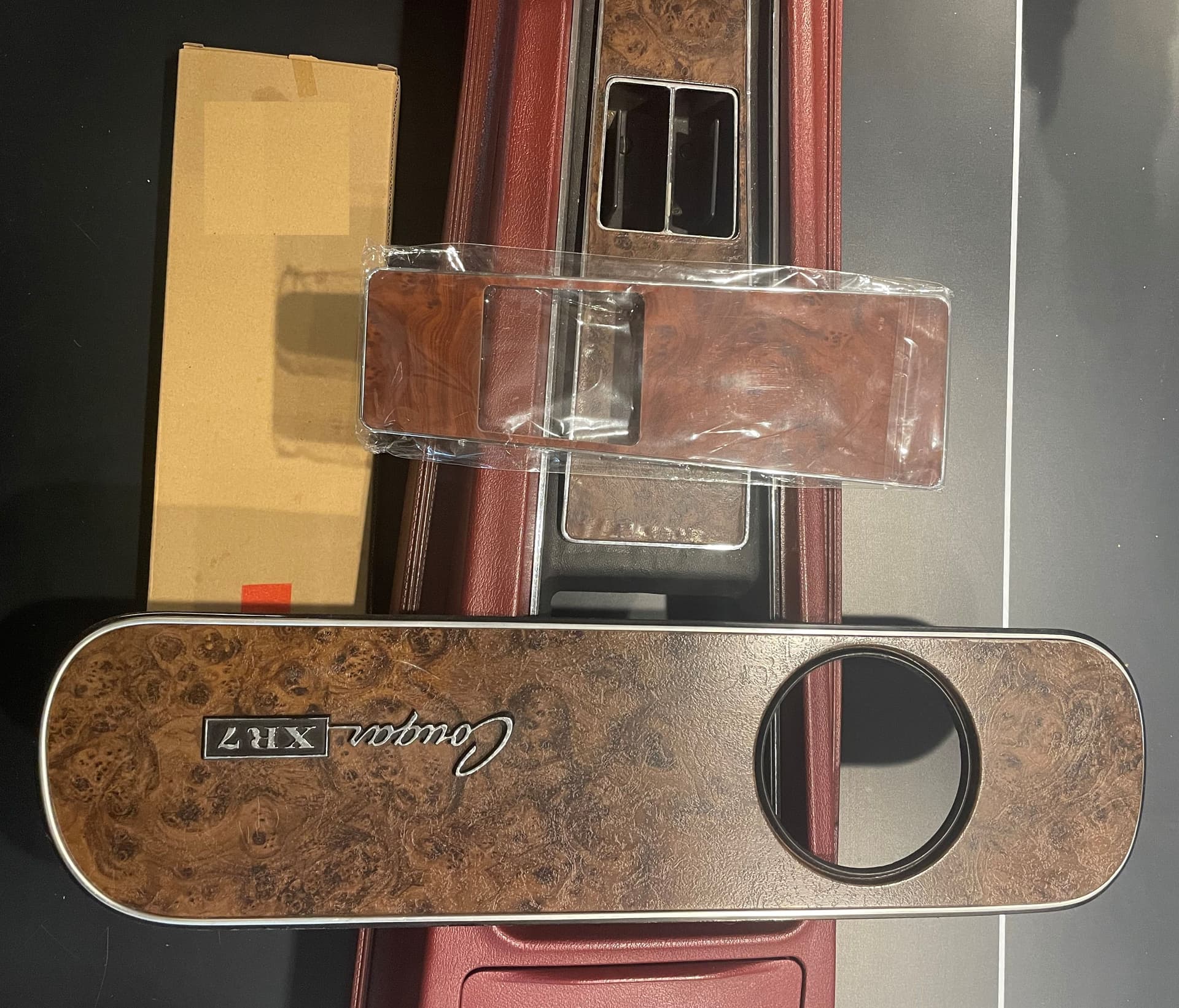

I haven’t seen a good reproduction in years. A previous owner put in an aftermarket stereo and chopped the bezel to bits, so I ended up buying a used stereo faceplate off Ebay that is far from perfect, but at least looks original between my cluster and passenger side dash panel. I bought the recently released console plate, which is advertised as not quite right, and when I put it next to my console I decided to keep my worn and slightly wrinkled original because the color and sheen were off and bothered me more than the imperfections I currently have.
Same for me - still living with my original. Has anyone had success regluing the original woodgrain down where it curls away from the bezel at the edges? It’s kinda brittle.

Like Knight717, I purchased the new console plate. Although the new replica looks really nice, it doesn’t match the “patina” of the rest of the aged woodgrain in the car, and doesn’t look right with my dark red console. Unfortunately, I had to return. Maybe if a console plate was available in black, I’d replace the console plate and the radio bezel both in the black.
I didn’t use mine, but I’m a fanboi so I didn’t return mine either. Maybe someday I will find a use for it, but I don’t mind making a one time donation to WCCC that has made probably hundreds of perfect purchases work for my car, and never steered me wrong.
