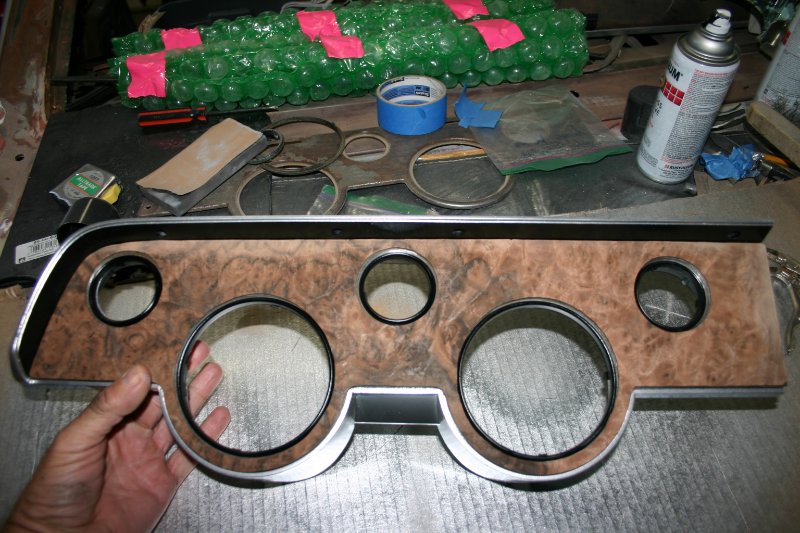

Here’s what I did on my ‘68 convertible project:
https://cccforum.discoursehosting.net/t/g-for-sale/236/1
I wanted to keep my standard dash but give it an XR7 type of wood look. I also added a mini tachometer in the clock area.
The material is a plastic laminate used for sign engraving.

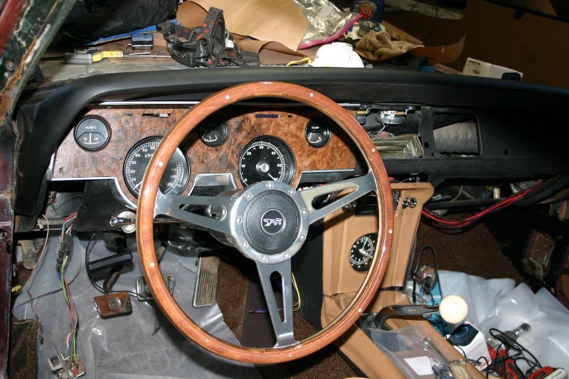

Getting a little bit closer. I took a break from the dash panel for a while because I got my parts in for the front and rear suspension. That is done and working on the instrument cluster, Vintage Air system, wiring and stereo. This is what I got so far. Still in work, got my tester to test some on the gages. Need to check them before I put together.
looking really nice!

DAMN! That hand-shaker (4-gear) is the best! I can’t believe how many old cars I’ve owned and only ONE has been a 4 gear… ![]()

Thanks Phillip. It’s not perfect, but I am ok with it.
