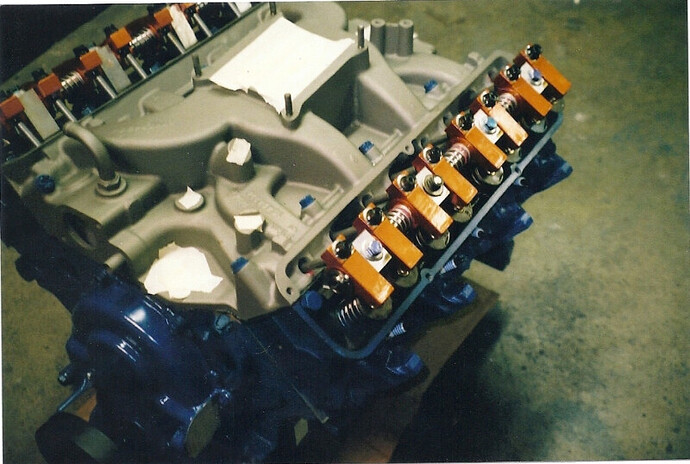

Wow, that is a good looking setup. How much horsepower does it make?

Totally agree, these are probably the best things that you can do as far as the crank and rockers. Get the Harland Sharp rockers shown in the photo, they are a great value for the price, and quality.
The stock heads actually are quite good if you install new stainless 2.09 / 1.66 valves (GT-E sizes). They cost the same as the standard size valves. Get a decent valve job done. Think about a set of shorty JBA headers for another 20 LB - Ft of torque.
