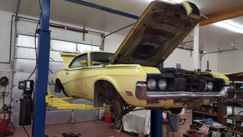

I’m doing some detective work right now on what may have happened to this car over the 48 years it has been away from me. The hood has been blown up at one time as there is a crease across the hood in front of the hood scoop. The trunk lid shows some red paint under the yellow so it has probably been replaced and it seems that the back end may have been damaged in an accident years ago prompting the repaint.
It started right up after what I believe to be a 25 year dormancy. OK, changed oil and filter, primed oil system with external motor through distributor, Marvel Mystery oil in each cylinder for several days before manually turning the engine over to insure nothing frozen, new starter motor and solenoid, new battery, new carburetor (wrong one but new), oh, and a new fuel pump. Ran the fuel line from a can of gas to the fuel pump, primed it and fired it up. Runs smooth, 72 pounds oil pressure, 18 inches of vacuum, no smoke, no blow-by, just a nice gentle rumble.
So it is drivable (licensed, registered and insured) since I found 4 decent tires to mount on it except for the brakes. I have all new brake gear for the rear (wheel cylinders, shoes, springs, keepers) and new pads for the front discs. Also a new master cylinder. Going to trust the power booster for now. While I have it up in the air I spun the back wheels and there is no posi. Either the Traction-Lok is completely shot or this is a different rear-end. When I owned the car, I was told that it had a Detroit Locker and 31-spline axles. I pulled the axles and they are 28 spline. Next I’ll drop the pumpkin and check it out. There is no snubber on the 3rd member so this may not be the original axle.
The plastic mud flaps I mounted on each wheel well are still there after all of these years! The lights work, the radio works, the rear turns are not sequential but they all light as well as fronts and front marker lights. The seats need new foam in them but the upholstery is almost flawless; back seat never sat in it seems. I plan on adding an isolation panel behind the back seat and the trunk (aluminum sheet) just for safety purposes in the future.
Needs power steering added to it as it never had it when I owned it and still not there although the two rivnuts in the frame for holding the PS idler ARE present (dealer must have removed it before I bought it as a “demonstrator” with 2400 miles on the clock, 1/4 mile at a time).

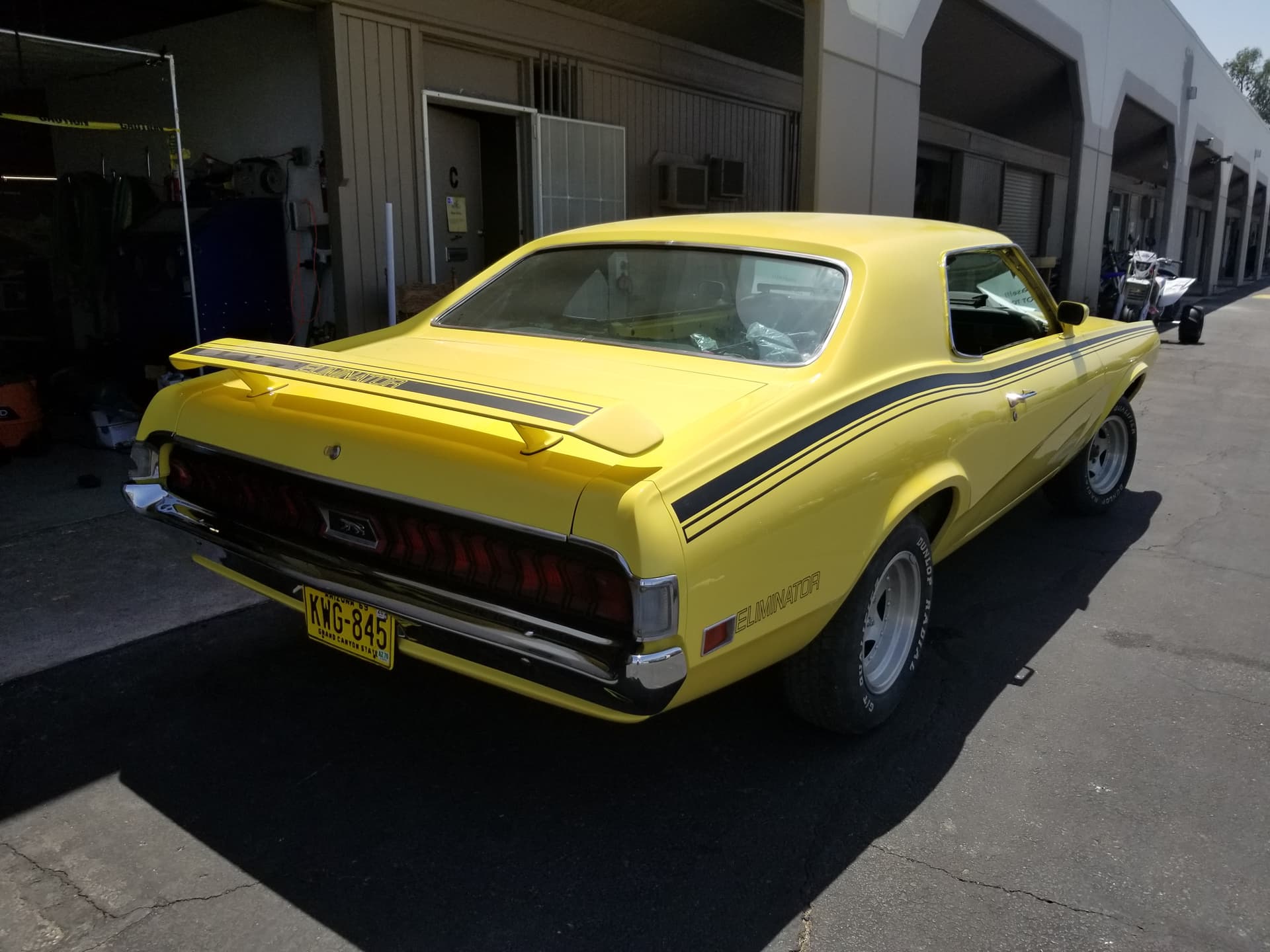

Christmas Eve day…off she goes to see Jorge for paint and body. Sitting on new 5 leaf springs with original mountings to axle housing.
Notice 4 gallons of gas for $1.33, what???
Awesome! Can’t wait to see it all finished up!
Me too. It has been 48 years since I have driven it.
So they could drive it of the transport and and it would be out of gas… lol

Getting everything back together. Should go much quicker now. I lamented the fact that the paint guy took everything apart and marked most things. Many mysterious parts left over. Been puzzling for several months now on some minor piping details. I finally remembered that the paint guy took pictures of EVERYTHING before he dismantled anything. Oh yeah, he gave me all of the pictures (on my phone) DUH! Now I know where every clamp and loose screw came from and where it needs to return to!!!
