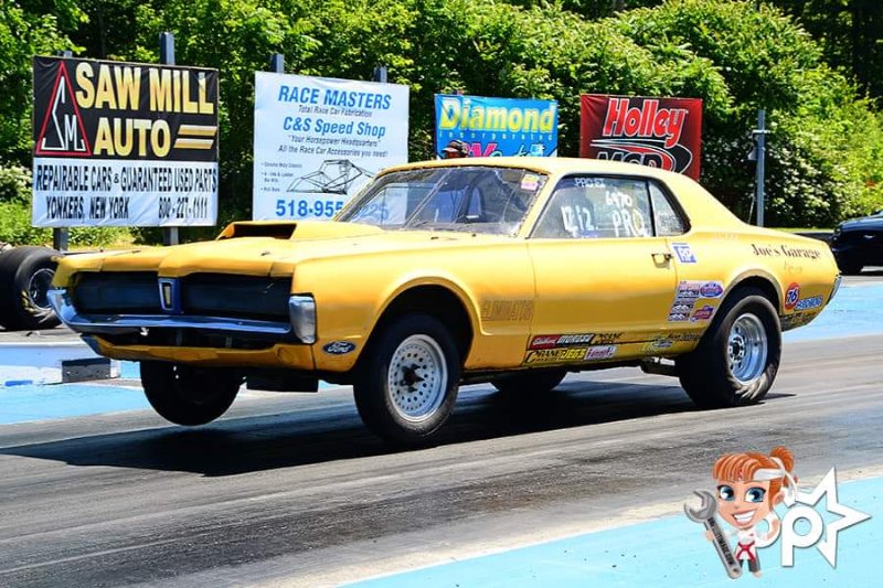

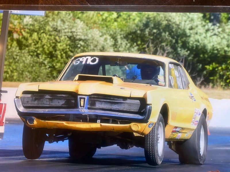

Oh man…that math hurts my head…lol. The car goes very straight all things considered…and she is not very elaborate when it comes to chassis mods…6 point roll bar…home made sub frame connectors…its a 67 so there is angle iron triangulated from the rear of the RH front frame rail to the rocker. But she does not twist at the hit
Here is a good pic from the track photographer…they may not be very high …but it hangs the hoops !

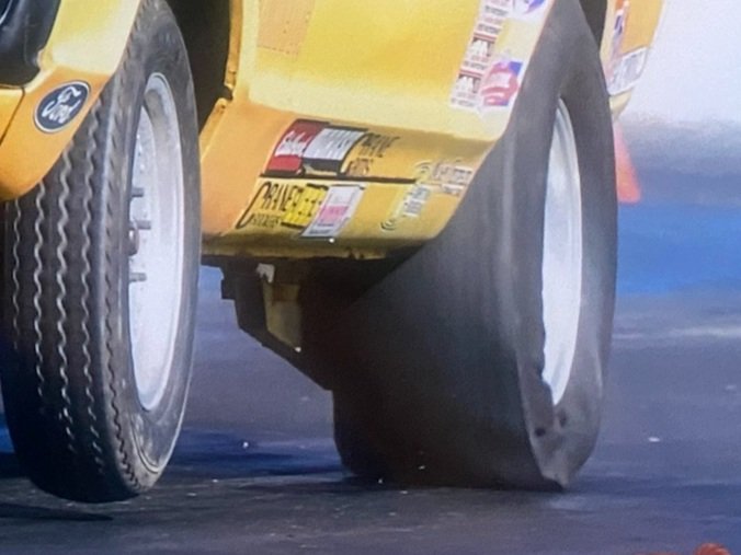

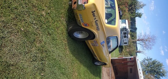

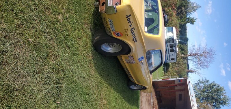

The rear is an early 9 in big tube housing. There are 1 inch aluminum pillow blocks on the spring pads. The inner wheel well lips are rolled flat. The rear shocks are summit single adjustables set on medium. I needed 1/4 spacers between the wheels and the drums. The 10 53 pass was leaving off the footbrake at 2500. I have the car setup with a 2 step and a transbrake. Best 60 ft. was this last pass 1.45. I need to work on the launch …two years ago I was trting the " button" and it made no difference in my 60ft. Launching at 3500 off the brake or footbraking it my 60 ft was 1.54. Sooo now I realize that was due to spinning the slicks. Lower launch RPM. LOWERED the 60ft. Here is a pic I took of the car static last weekend and a cropped pic of the lo buck 70’s vintage “SLAPPER BARS” at work. They might be cheesey…lol They are Mustang bars with an extension welded to em and I tell you they really worked ! I have since replaced them with Slide -A- Links that a fellow Cougar guy gifted to me. If anyone here wants the slapper bars…just pay shipping I will pay it forward. They aint pretty but they do work
