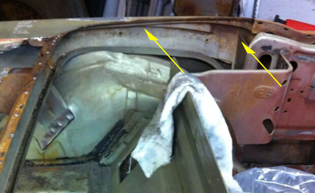

After some study, it is clear that there are two places where reinforcement are used for the quarter.
  1. Between the inner panel just after the jamb and the outer quarter skin. This essentially boxes the quarter window region and stiffens the attachment area for the seat/top frame.
  2. Between the two edge of the quarter panel and the gutter. This stiffens the entire upper edge of the quarter under the hockey-stick trim.
Looks like I need to try to locate the left/right sections of the gutter. I already have the center section.

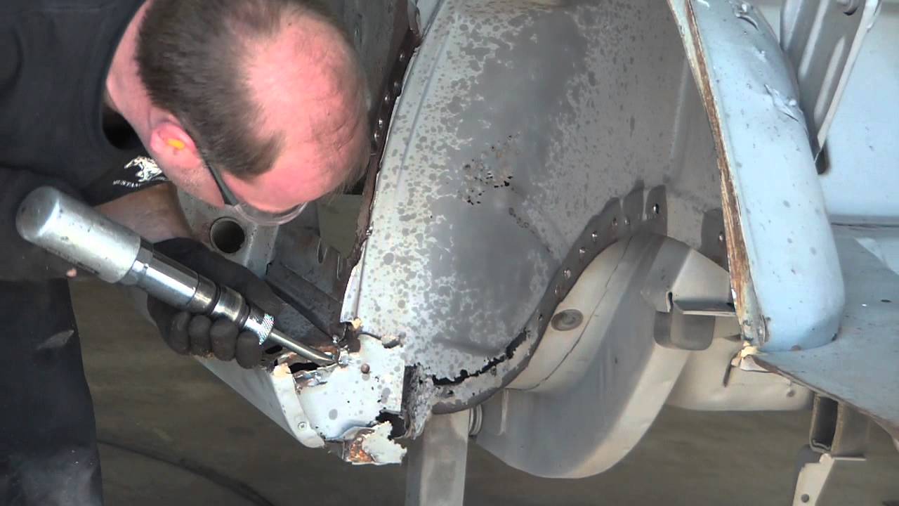

This video shows removal of a quarter from a 67 Mustang convertible and verifies the attachment. I guess that cutting with an air hammer confirms detachment. But whatever!
