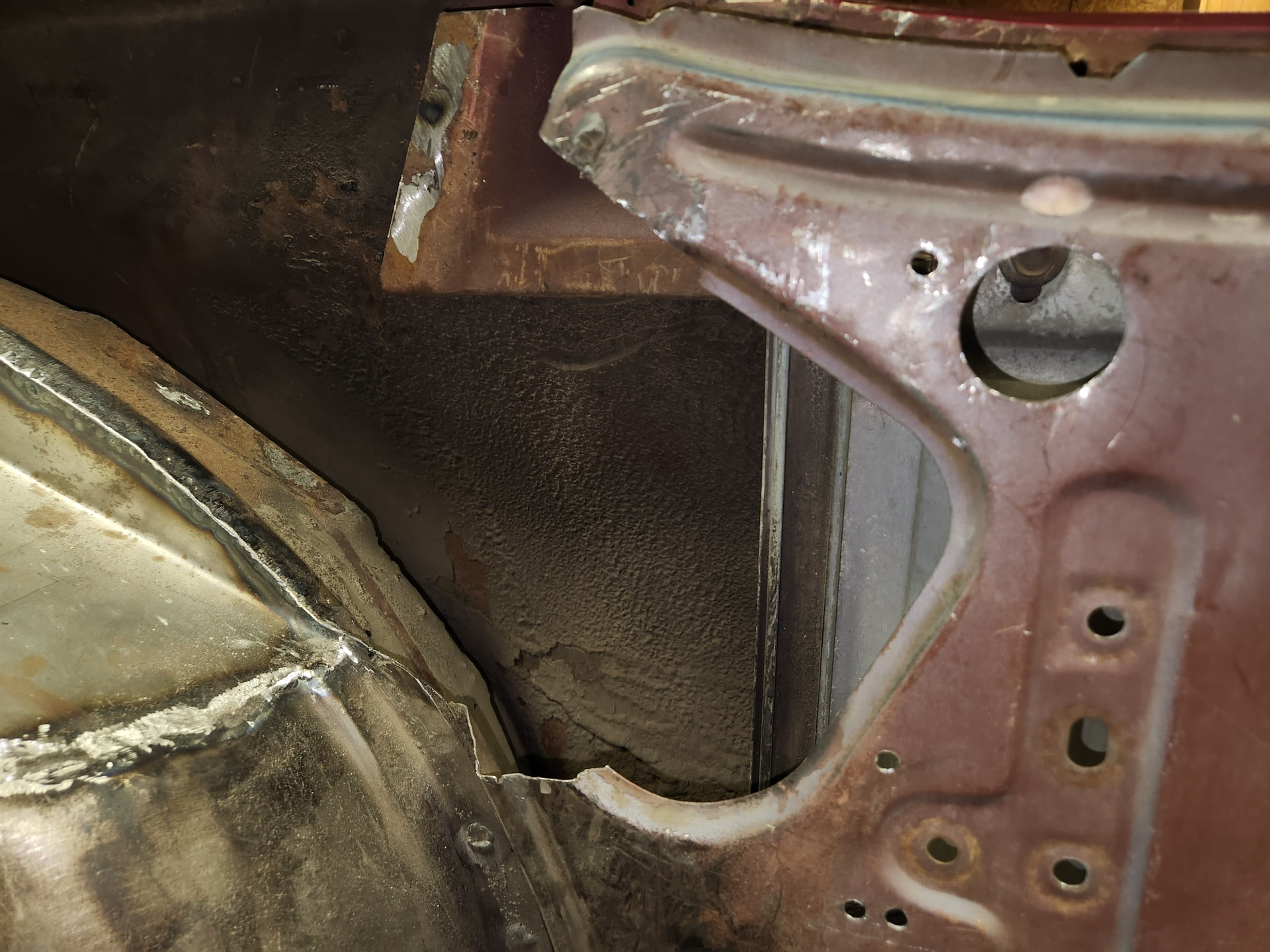

Today’s fun.
Getting ready to plate over the large rectangular hole (center of picture) in the inner panel and then tie the inner panel to the quarter and the brace (top center of picture) supporting the quarter window track.
Originally, I may have been a little aggressive with removal but I also need proper access for the top lift cylinders.
