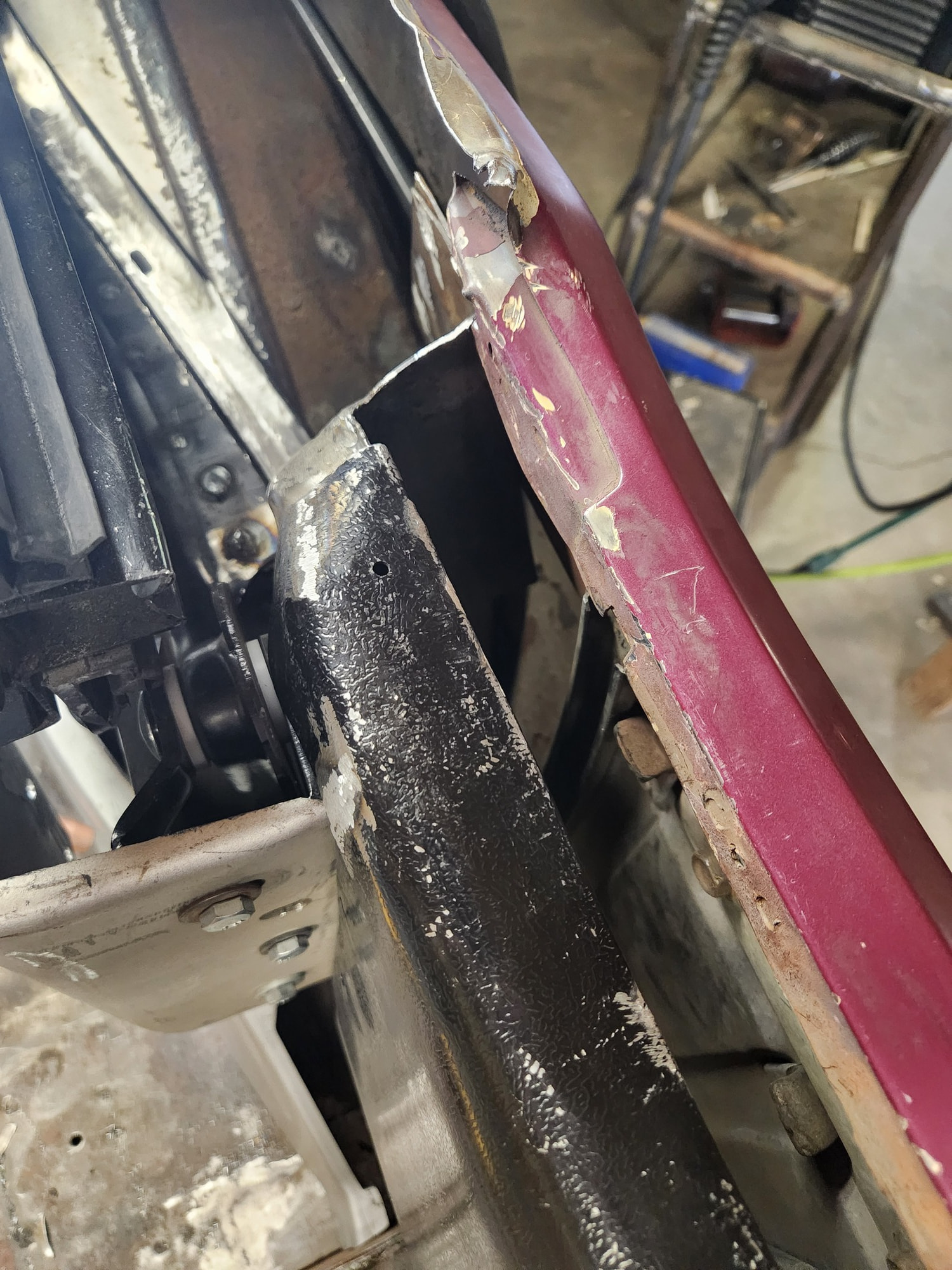

More bracing and fit-up of the inner and outer sections of the quarter window metal.

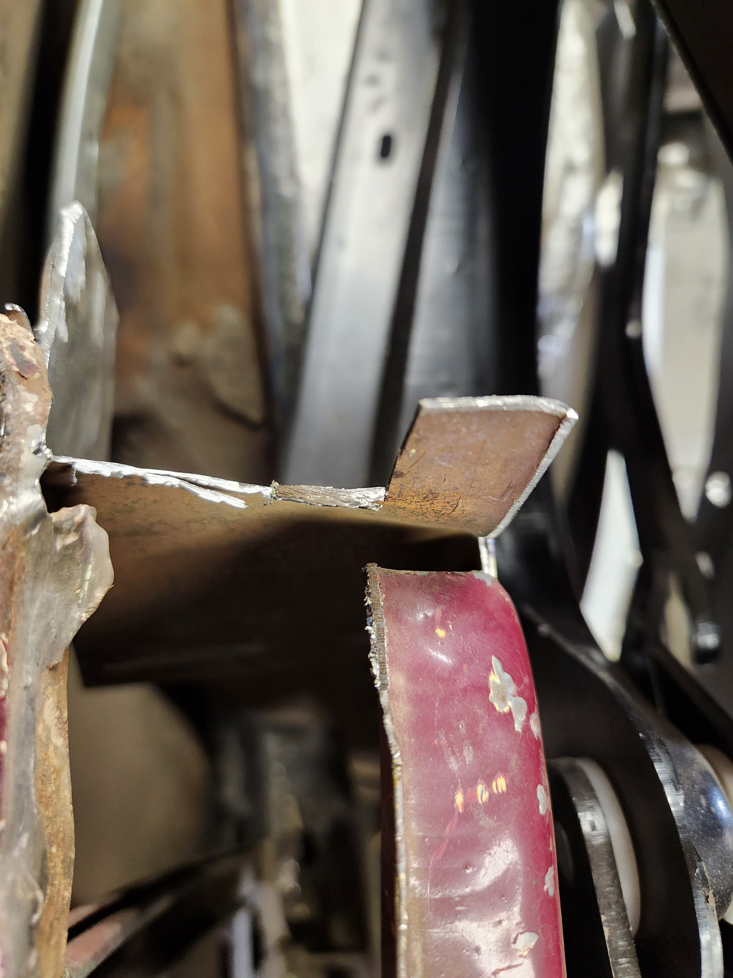

Before…
The previous metal shaped-up a bit. The tab that is sticking up must be welded into the red portion to rebuild the corner.

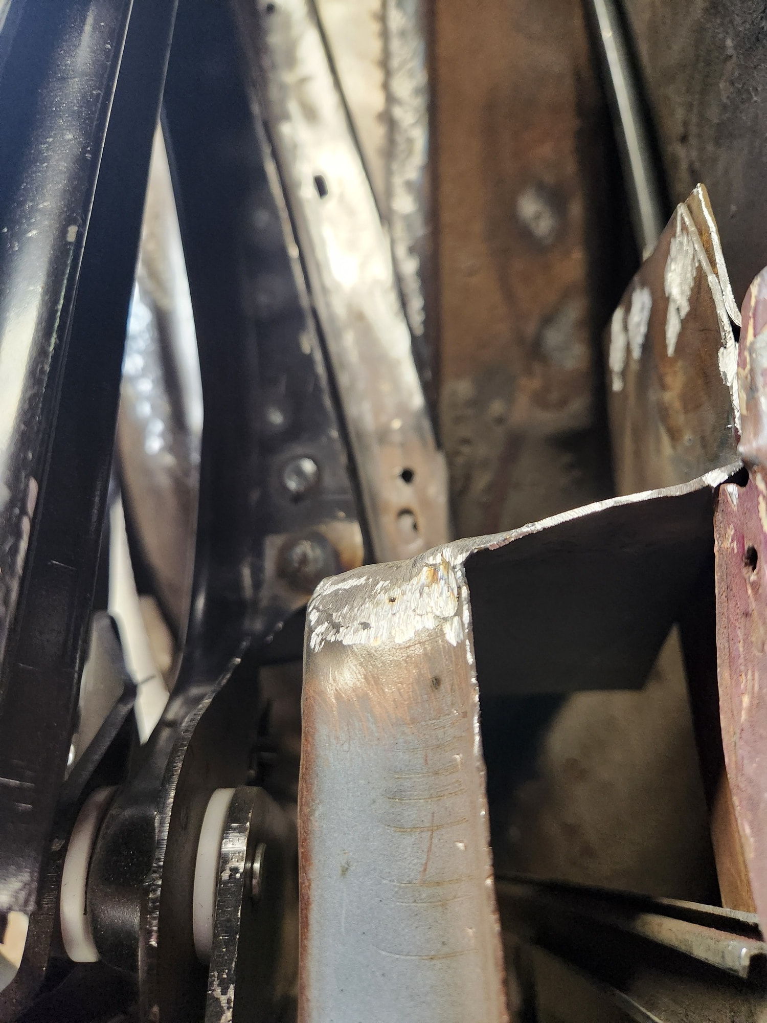

Cut, grind, hammer, etc. Now nicely contoured.

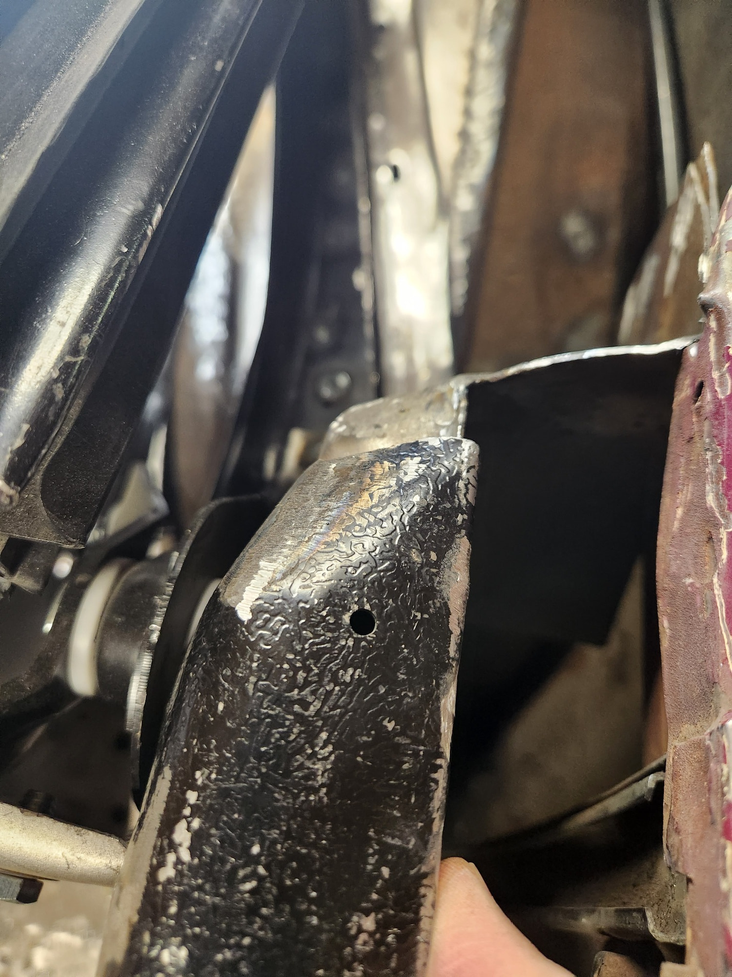

Lots of messing around with the interior panel to match the Cougar quarter window metal contour. Removed the existing hump and it now has the gentler Cougar profile. I also tapered the rear to ensure clearances around the top frame seals. The front edge of this panel at the door jamb also needed a little rework to maintain the Cougar door profile. I may have to tweak this a bit still since the doors are not yet back on.
