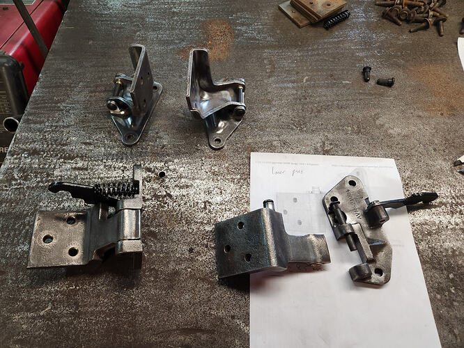

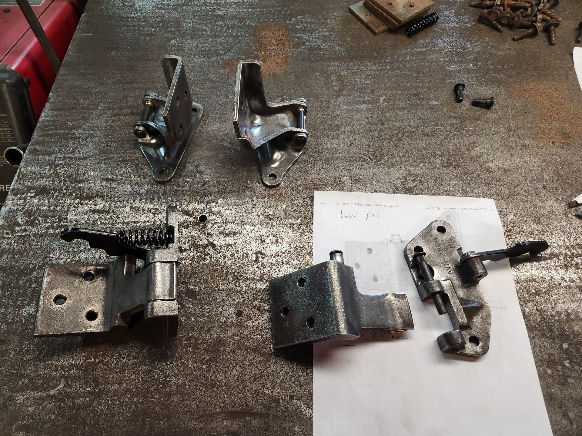

Got started on the hinges but then went on vacation.
Rebuilding the hinges was honestly a serious pain. Grind, heat, press, hammer. The pins were embedded harder than hell.
One of the pins for the rollers was broken off as was one of the cam plate pins so had to drill those out.
Reassembly went well and the bushing install was easy. Then the passenger side lower hinge arrived. The holes in the door side portion are oversize ~0.360” versus 0.337” for the unfluted portion of the pin. Going to have to drill these more oversized 0.375” and sleeve with either bronze or steel and then drill to size.
Luckily Lowes has various 3/8” OD spacers/bearings or I might have a piece of 3/8” seamless tubing. Yeah for the Bridgeport. Wish me luck.
