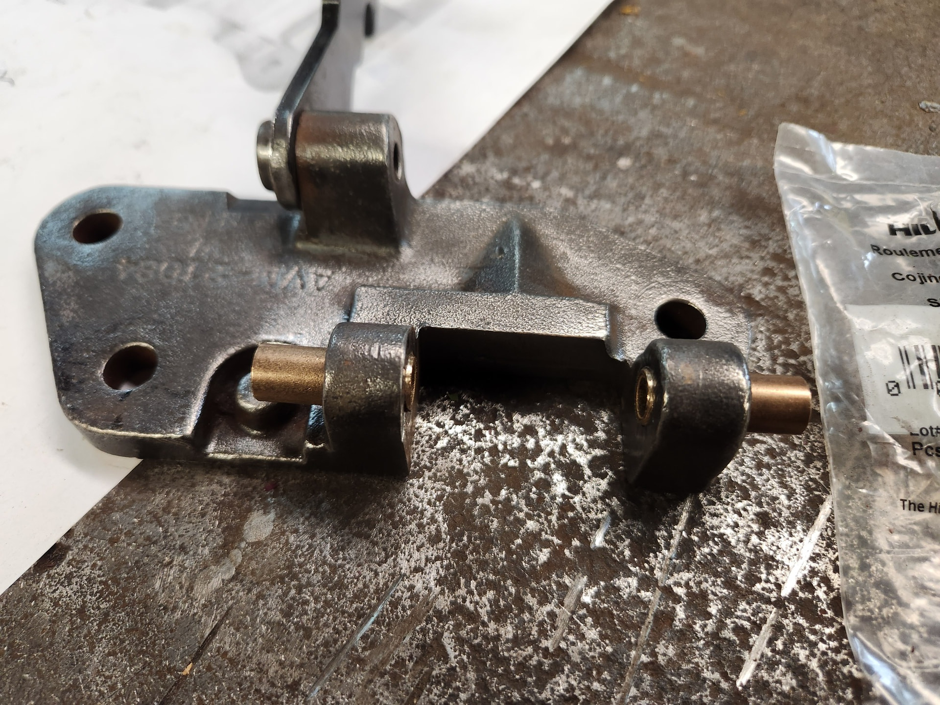

The bushing used. This is from Lowes.
These measure a little over 0.375” so a good 3/8” bit makes a light press fit. Get it lined-up in the Bridgeport.

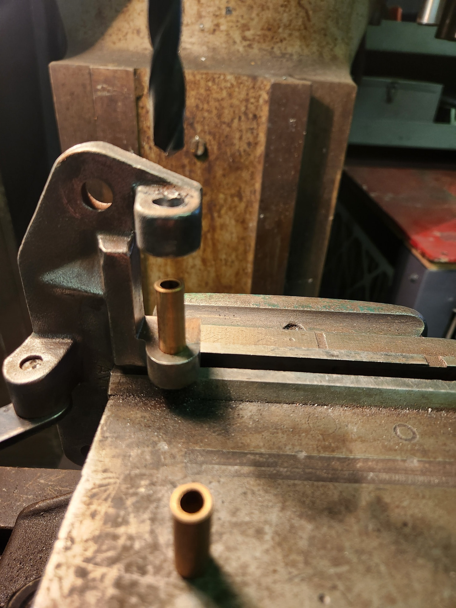

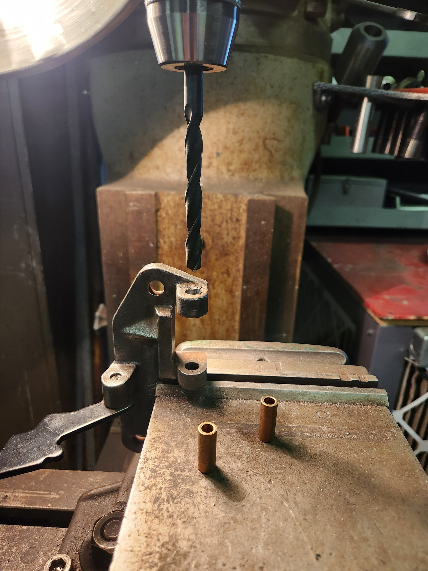

They just start. So good fit. If using a hand drill. I would go with a slightly smaller drill size “U” or 9.4mm. The hand drill is going to make an oversized hole.
I left them long on purpose while pressing in and prior to drilling to size with the “R” drill. Better drill guiding. The fit is perfect.

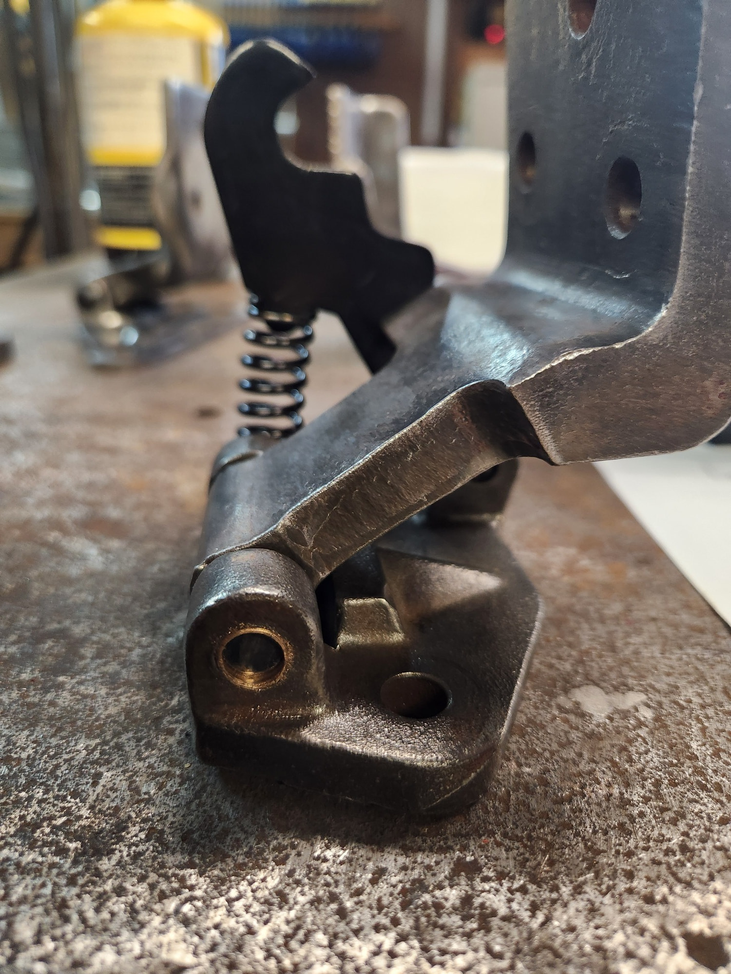

Cut of excess and lightly deburr.

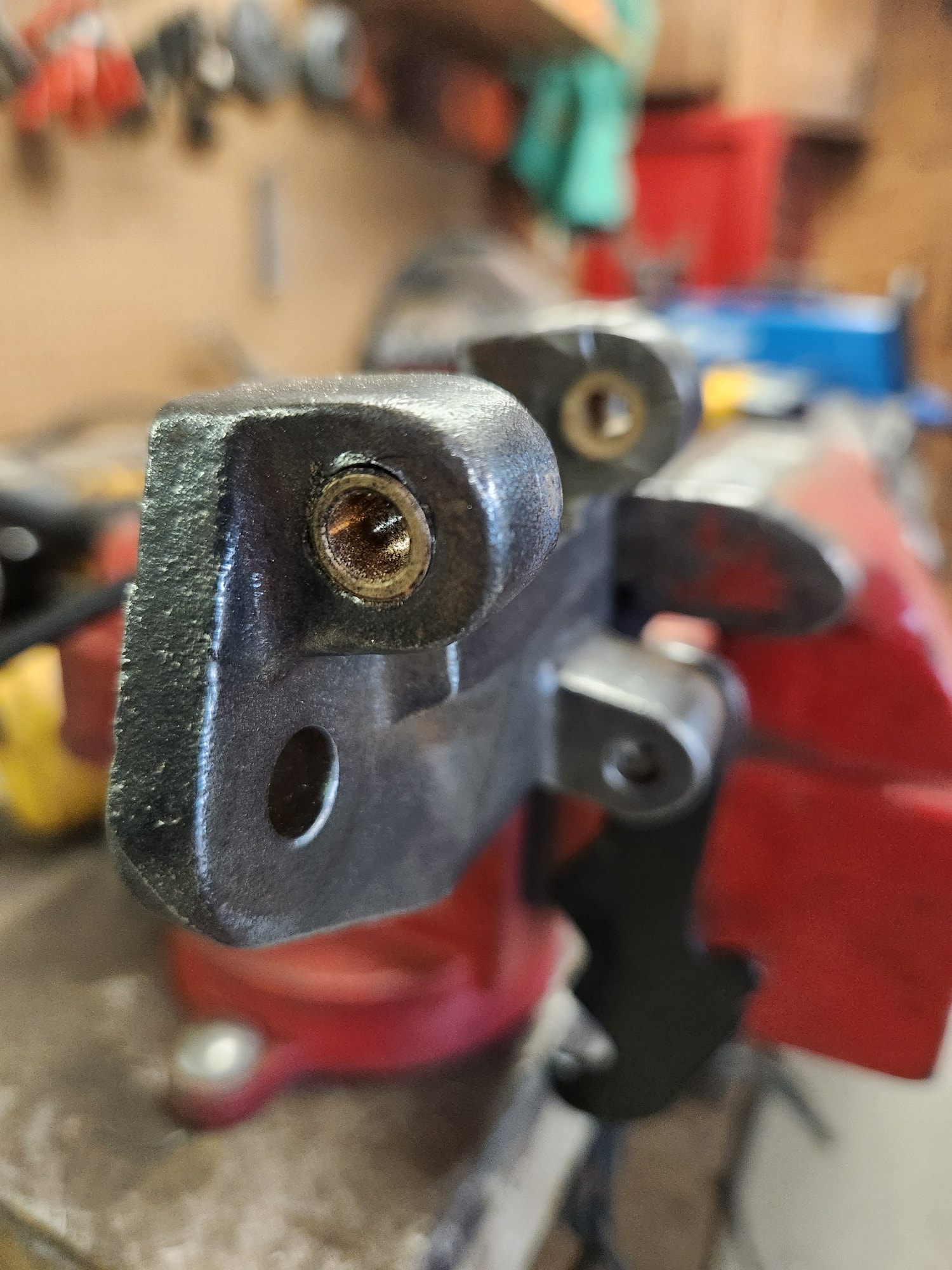

Done. No sag anymore.
