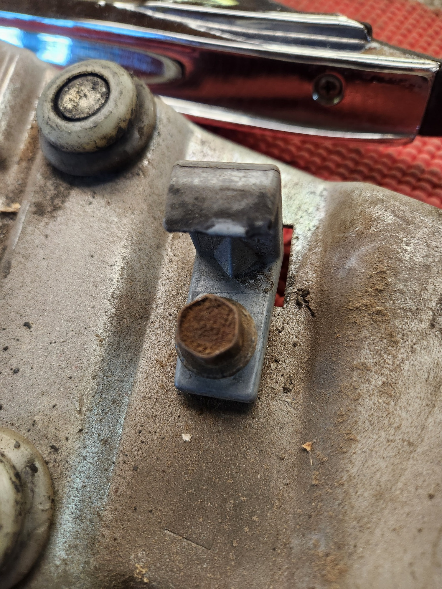

I freed both the glass and the vent window prior to pulling anything out. This allowed more room to wiggle things around. Do NOT forget to remove this stop!

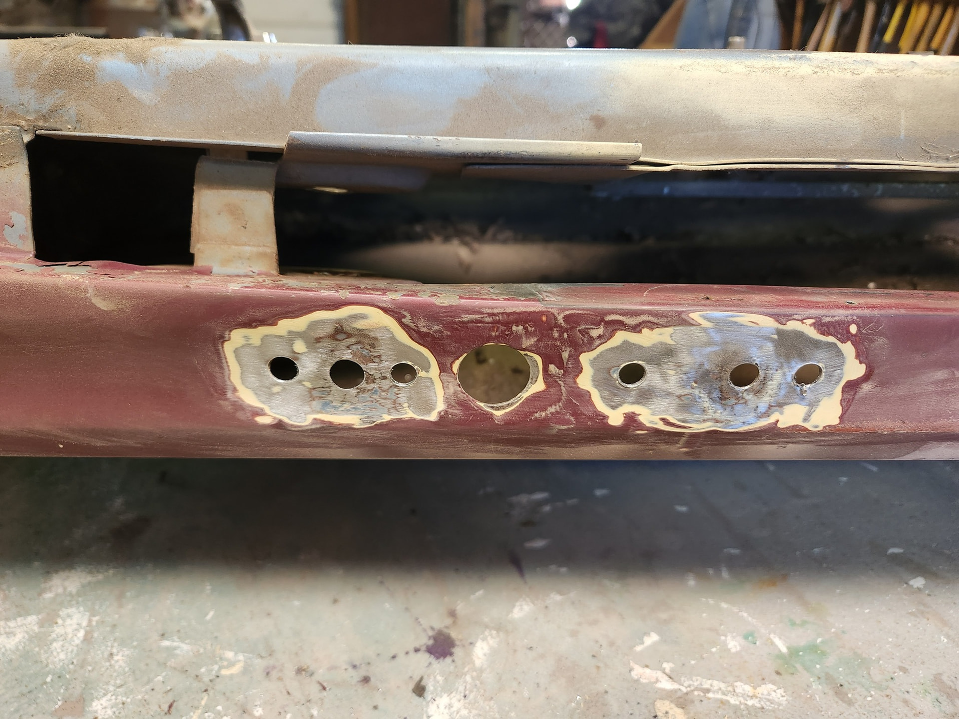

Fortunately my doors are very clean, no real rust or damage, except for the mirror mounting holes but that is easily solved. Felts, rubber, seals obvious shot-to-Hell with age.
To patch and reinforce the mirror location, I added a few more holes. Say what?

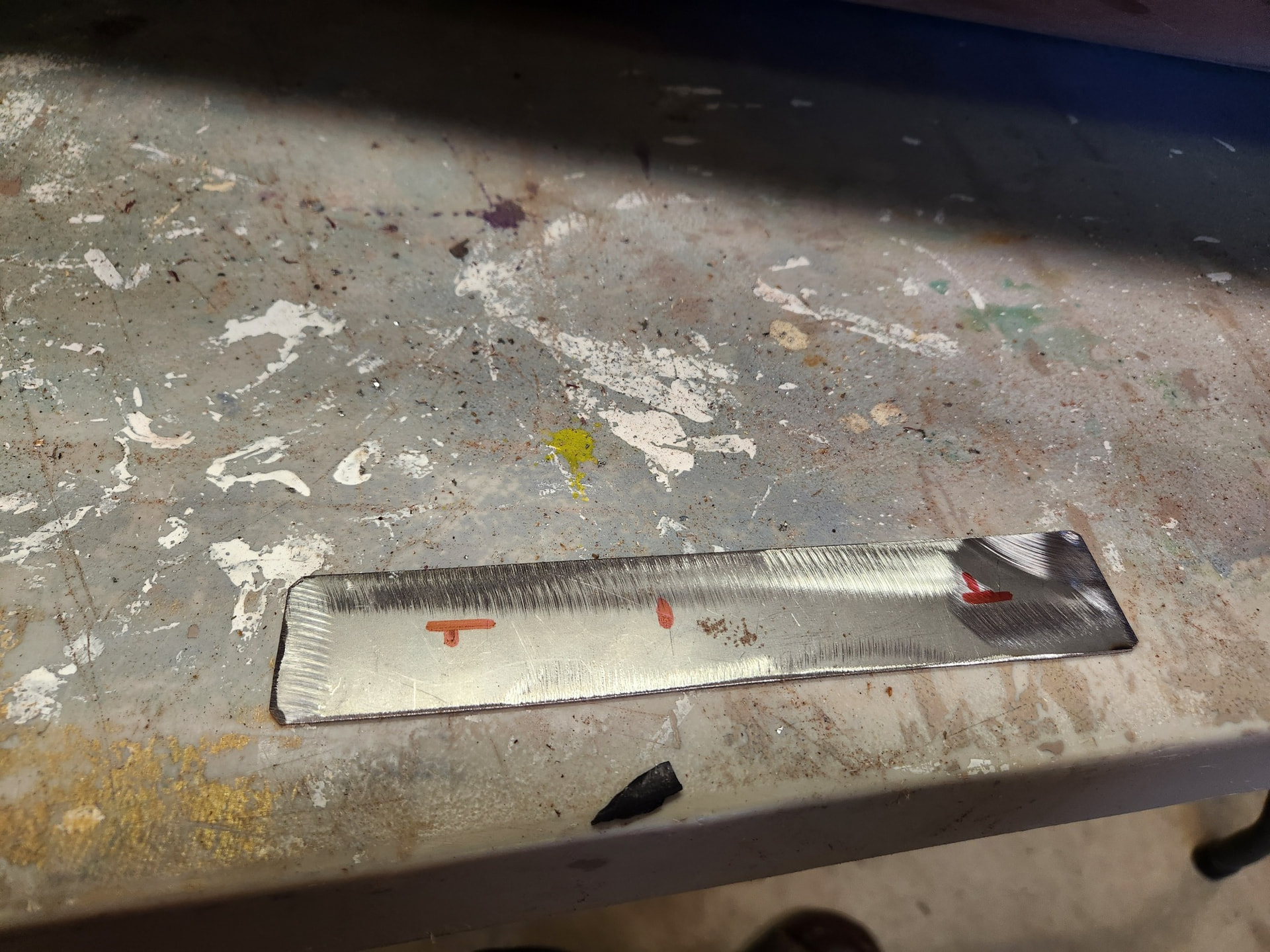

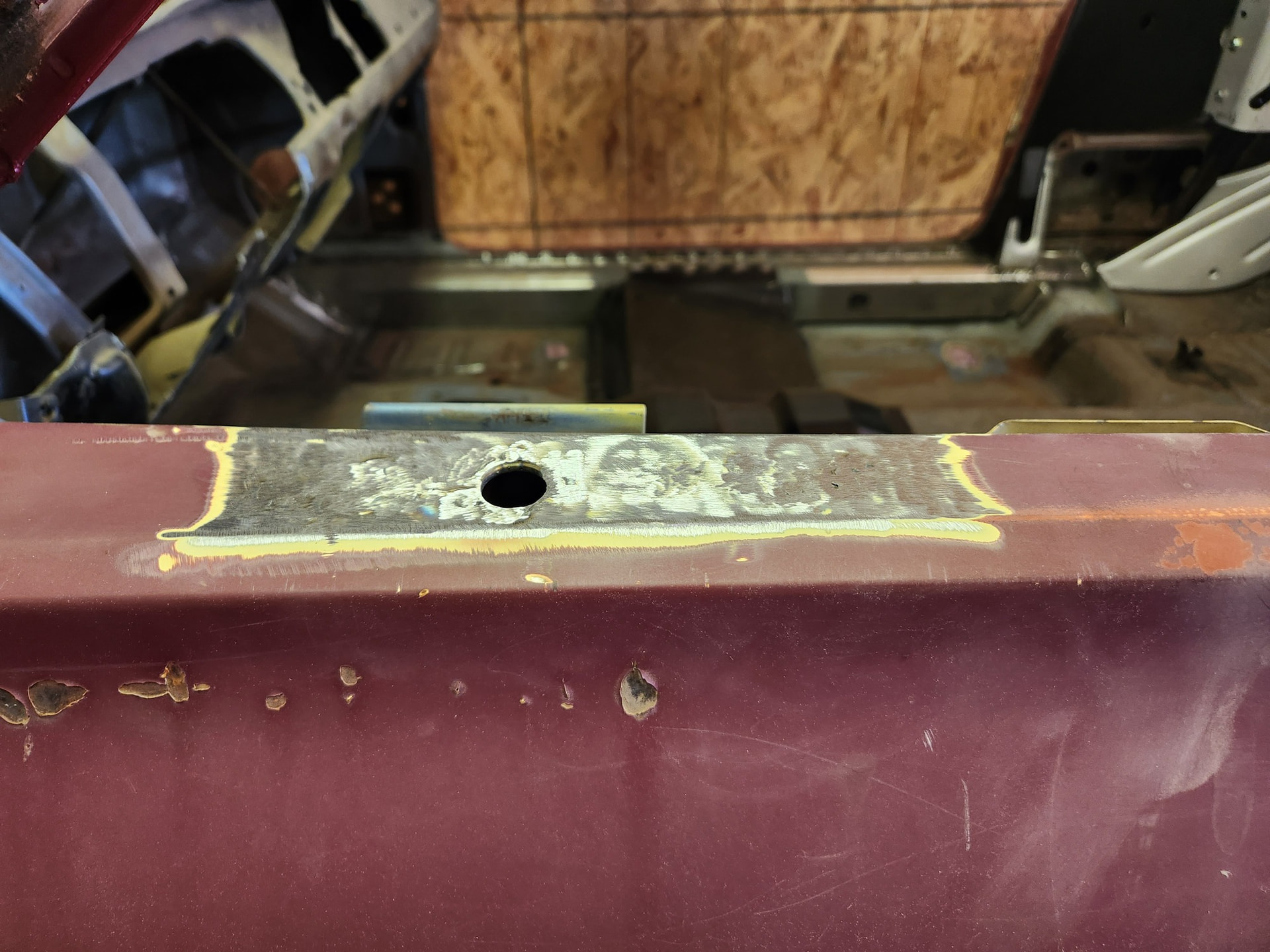

The existing and new holes allow welding in a backup plate of a piece of 18 gauge. Now there is double material thickness and new screw holes can be drilled when necessary.
Backup plate
Done
