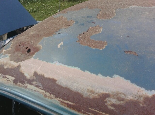

You’re going to have to replace that roof.
I’m sure there is a way to fix it, I am going to have sheet metal placed where the Rusted metal is…Does anyone have any Free parts they’d like to donate
I need to get a New Dash cover and headboard, Fix the Chromes…
How can I fix the lights, because my Dash lights work, and I don’t think the others do
Is that the worst of the roof? How does it look around the rear window? Curious about the roofs integrity,. Does the metal flex easily when you apply light to moderate palm pressure in the areas of heaviest corrosion? One good spot to check to see if there is extensive rust damage, is to look around the lower part of the rear window from inside the trunk. You will be looking for obvious pushed through rust holes dripping pink body filler or stuffed with newspaper …don’t count the evenly spaced holes which the stainless vinyl top trim was attached through…if they have been filled.
I used the palm of my hand to pop the top of the Roof…Yeah thats the worst…The previous owner has fixed the rear window part and yeah I’ve checked it with a Phillips Screw Driver…Its only bad on the front window, I have a guy that has a 70 Cougar locally coming to help me get it started and fix the possible leaks.I need to fix the shifter
The hole area is pretty strong in a way, I can patch up the Roof pretty EASY I guess,I got all the Chrome trim for the windows and the front window
