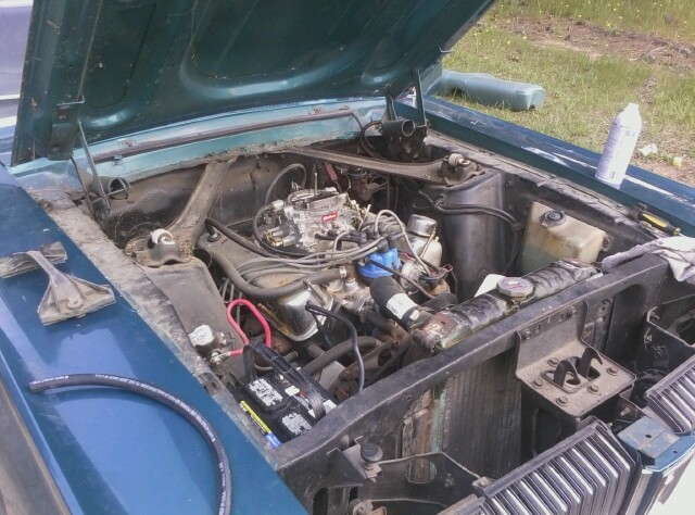

What type of Engines did my Cougar come out with
This guy told me its a 351, but I thought it only had a 289 ?
In '67, the Cougar could have come with a 289-2V (engine code F), a 289-4V (engine code A), or a 390-4V (engine code S). If it has a 351, it’s had an engine transplant. The engine code is part of the VIN (example: 7F93S616359 on my Cougar is 7=1967, F=Dearborn Assembly Plant, 93=XR-7, S=390-4V, unit number 616359).

I honestly can’t tell if its a 289 or 351, I’ve been told its both
Aside from the roof the car really looks pretty good.
Going from the pictures it looks like a 289. The deck height is taller on a 351w, but still hard to tell from the pictures. You can also check the firing order.
351w is (1-3-7-2-6-5-4-8 and 289 is (1-5-4-2-6-3-7-8). You can also get the numbers off the block above the starter.
Is the ignition coil just sort of hanging there? Never seen one in that location before.
It has a Bracket on it holding it to the engine I believe
