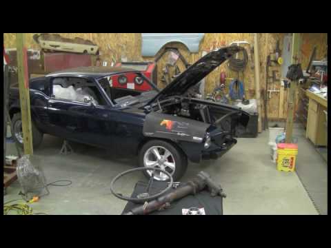

With standard steering, just remember it’s best to have the car moving at least a little when turning the steering wheel. It’s always going to be hard to turn the steering wheel when sitting still. There is a remedy, you could buy a Borgeson power steering kit that eliminates a lot of the problem parts. Here is a link to the part and also a video link as well on how to install the kit.
http://www.borgeson.com/xcart/catalog/Mustang_P_S_Kit_19681970_289_302_351W_Manual_Steering-p-1552.html
