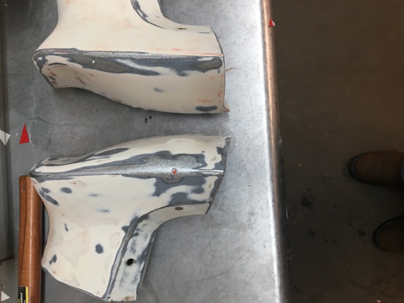

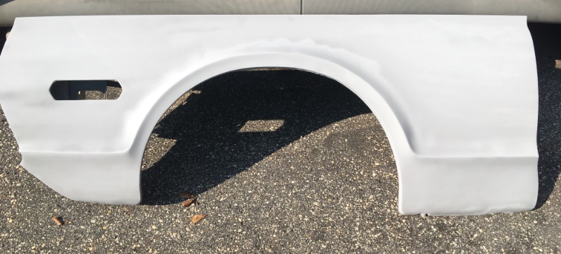

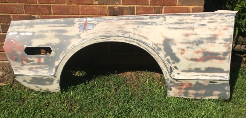

Some before and after pictures of my fender extensions.

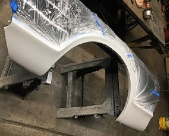

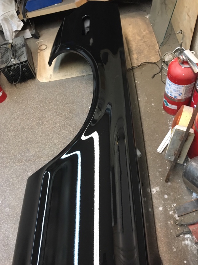

Like usual progress has been slow but my project is moving forward. I always want to balance family time over this project. I have stripped and welded some holes on the drivers side front fender. The holes were there from long sheet metal screws that a previous owner had drilled through the lower aluminum trim molding. After the welding and body work was done I sprayed the first coat of primer.

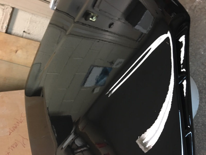

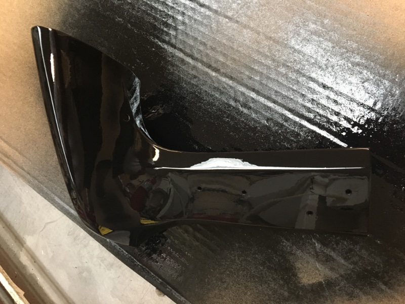

I also reworked my hood scoop because after spraying it black I could see some imperfections in the center of it.
I put the first coat of black on the fender today. There’s some light orange peel but after some wet sanding I’m sure I’ll be able to work it out to a smooth finish. The next step after getting the wet sanding complete will be masking off the black so I can spray the light gray for the GT-E inspired two tone paint scheme.
I also sprayed the XR7G hood scoop.

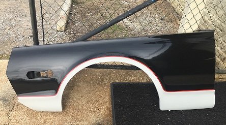

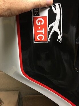

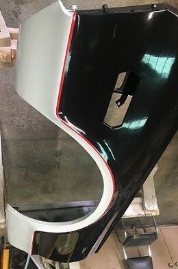

Family time as well as work have been keeping me busy as I’m sure it does with many of you and I’m thankful for that. It’s been a while since I updated my project so here is a little more information. I’ve taken some “artistic” liberties with my GTE inspired paint scheme compared to what the factory would have done if they had made a convertible in 1967 or 1968. I’ve added a 1/4” red pinstripe that I made on our sign machine instead of adding the extruded GTE moldings. I think the red pinstripe and the custom fender emblems that I made work well together. Here are a couple of pictures.
In the last picture of my fender emblem I did not have the print and cut properties set correctly so the machine made my walking Cougar a “bobcat” :laughing: . That has been corrected. :smiley:

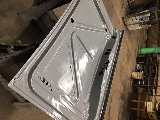

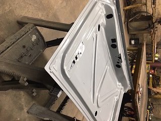

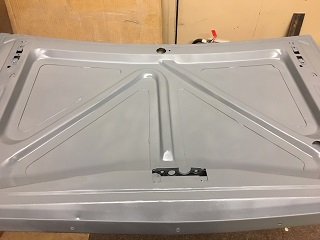

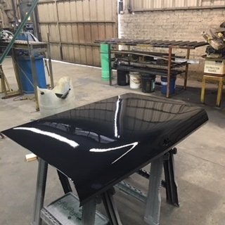

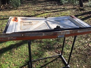

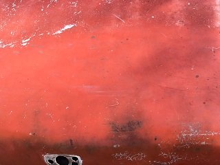

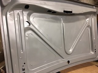

Trunk lid stripped, primed, sealed and painted. Another step towards the finish line. :smiley:
