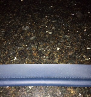

Another small milestone for my project. My convertible top package arrived today. I am so happy with my color choice. I chose Ford’s dark blue to compliment the white body. Here is a picture of the front wind-strip (I believe that’s the proper name).

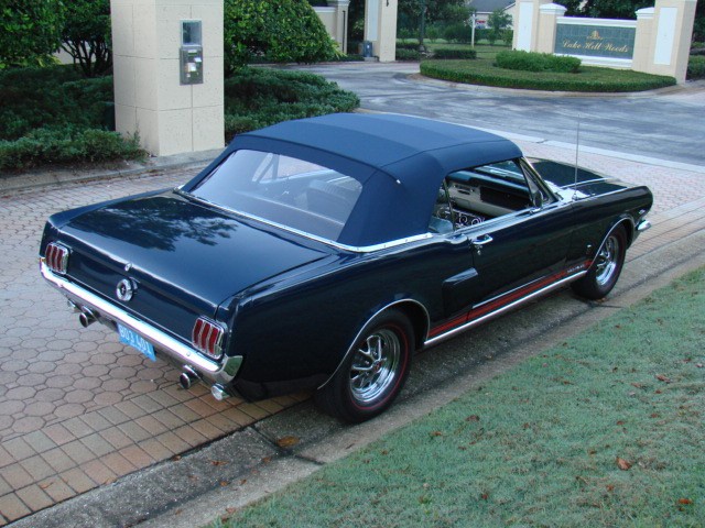

Here is the same color top on a 1966 Mustang.

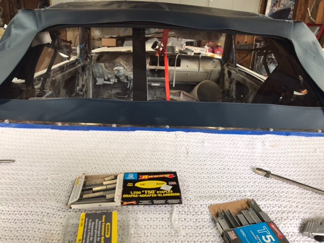

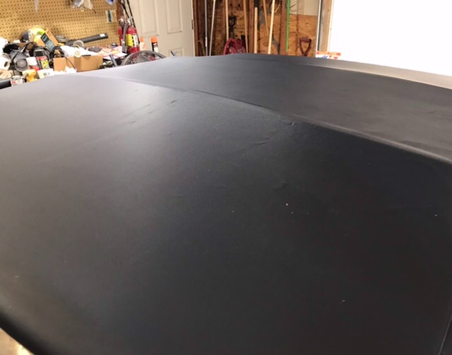

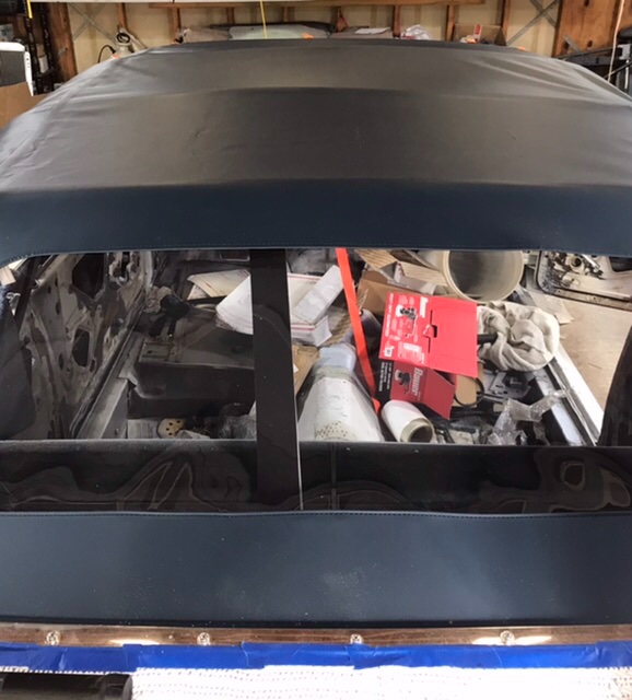

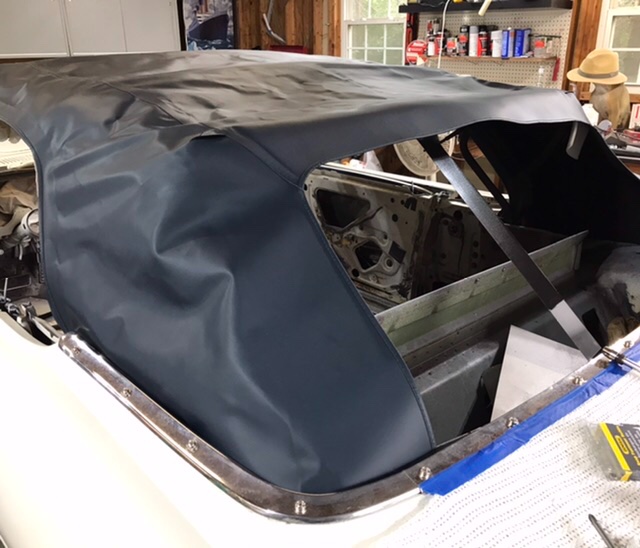

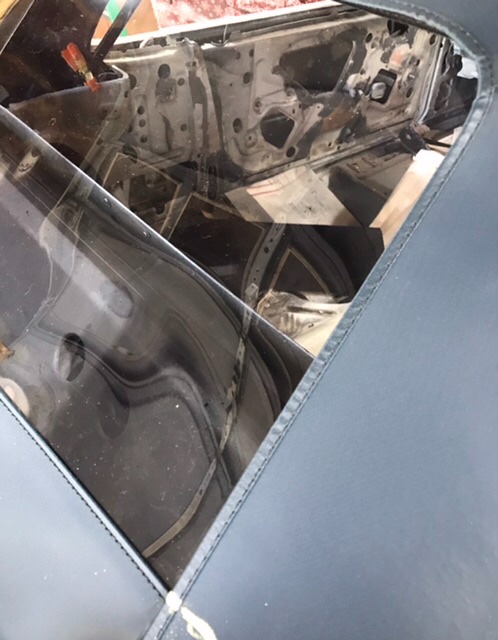

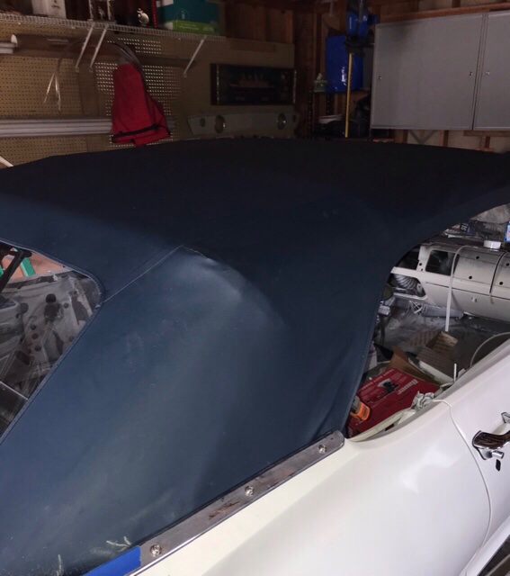

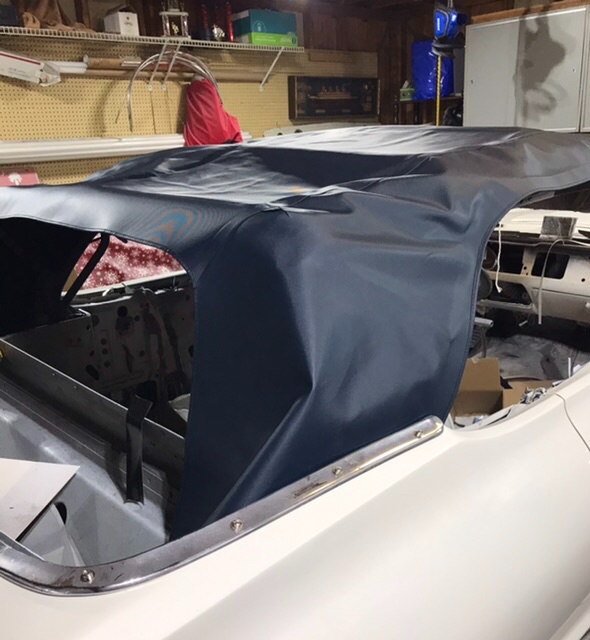

It has been unseasonably warm this past week so I started working on the top. I have installed new tack strips in the header bows. I have also installed the top header pads on each side of the frame. Now that the number four is in place, I can start on the rear window and rear quarter pads. I could not pass up the opportunity to lay the top on the frame to get an idea of how it with look when finished. I am really pleased with the dark blue top. :smiley:
Installing the convertible top is a tedious task to say the least. A lot of measuring, stapling, staple removal and adjustments to get everything wrinkle free. I’m moving slowly and taking breaks between adjustments and re-stapling the top. The rear quarter tack strips have been the biggest challenge. I have the rear window curtain in place and the right rear quarter fitted.
I filled nearly half of a coffee can with staples back when I did mine.

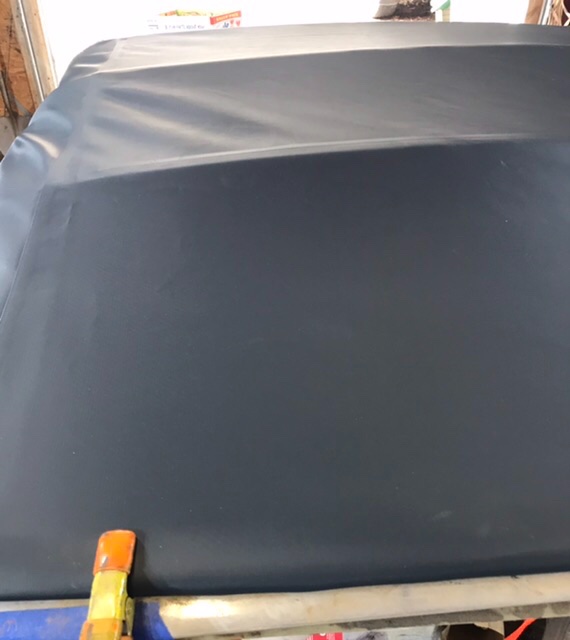

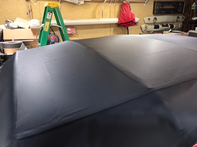

I’m slow but the top install is heading towards the halfway mark. A lot of adjusting and pulling to get everything tight and wrinkle free. This installation is quite the workout on my hands, fingers, and arms.

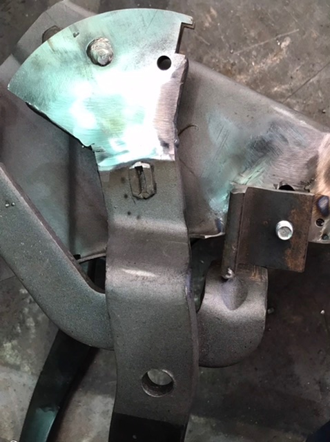

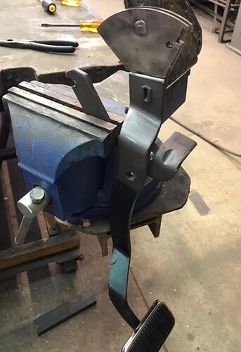

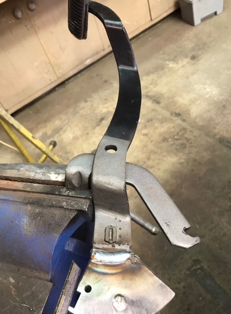

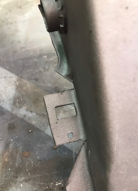

I finished the modifications needed for the clutch pedal assembly. I used the Mustang Steve cable clutch kit. The kit is straight forward and good quality.

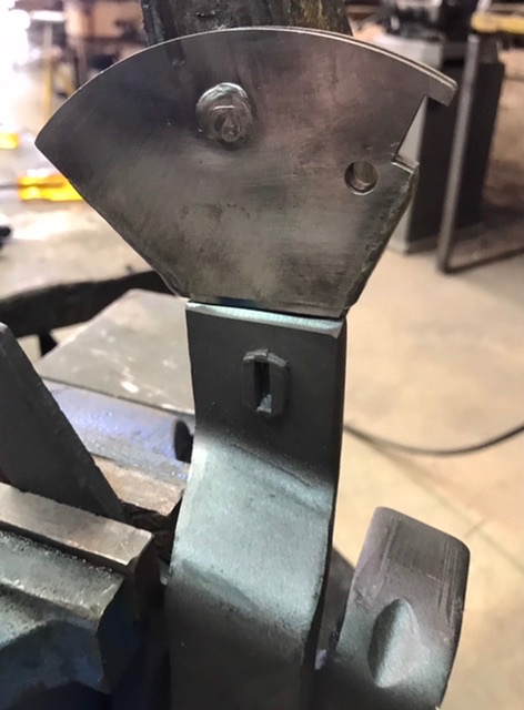

After removing the clutch pedal, I welded the cable quadrant in place.

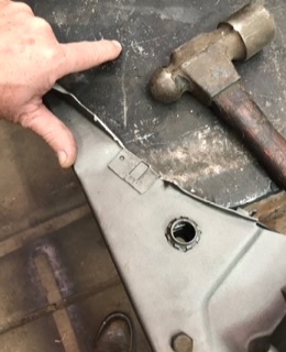

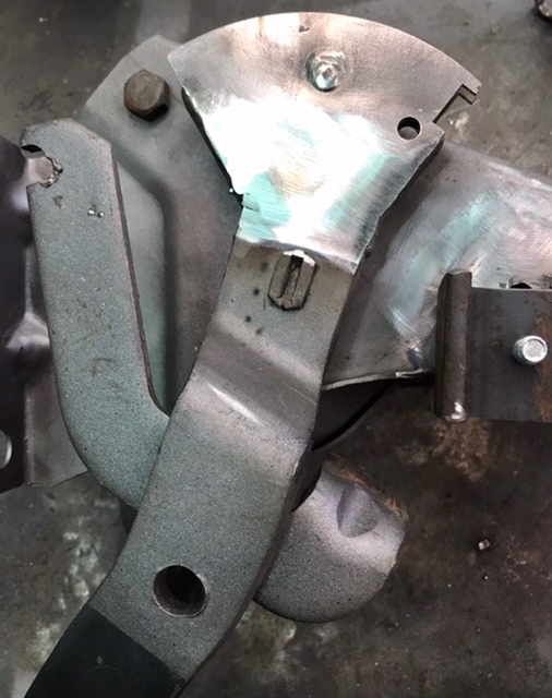

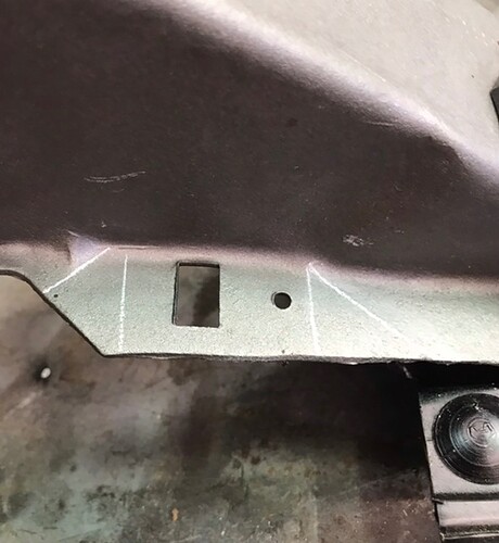

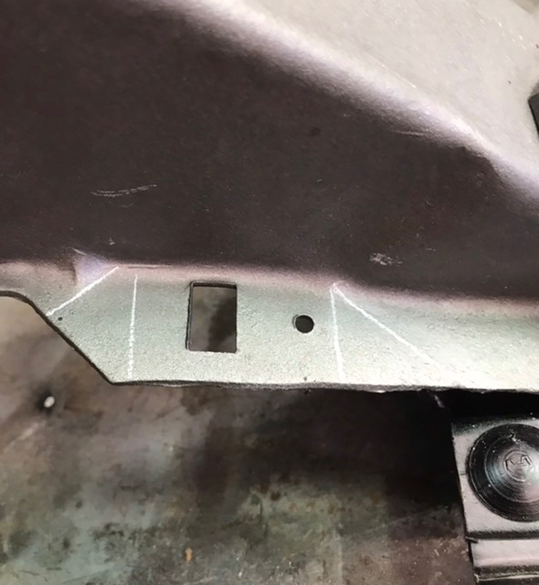

Once I finished with the quadrant, I moved to the modifications needed for the adjustable clutch pedal stop. This step required cutting and bending the clutch/brake pedal assembly flange.

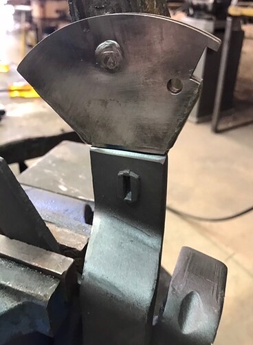

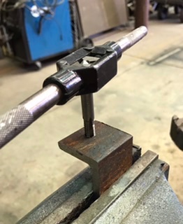

Once finished, I fabricated the stop out of 1-1/4 steel angle and tapped the bolt hole.

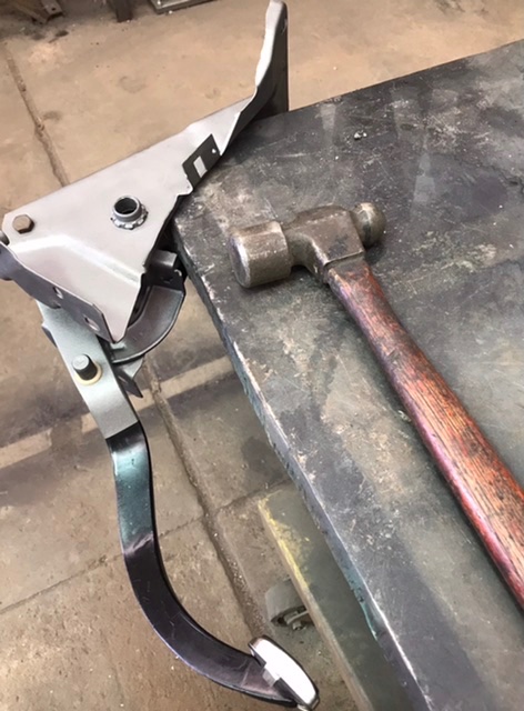

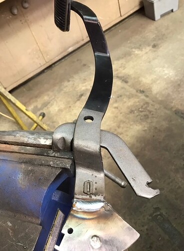

After fabricating the clutch pedal stop, it was time to reassemble the entire assembly.
My clutch pedal reassembled and showing the adjustable pedal stop in place.
