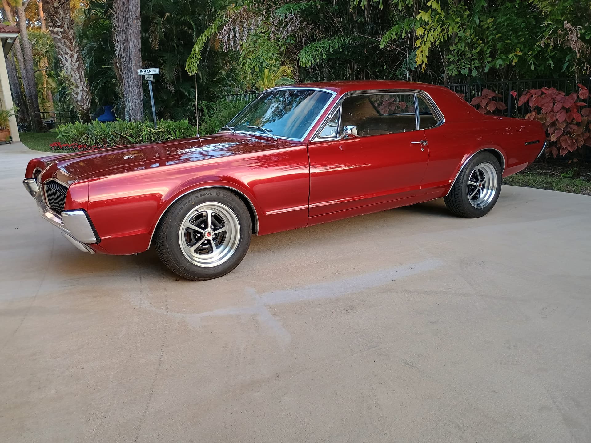

Ride height with s26 and sbc uppers and 1/2 coil cut off

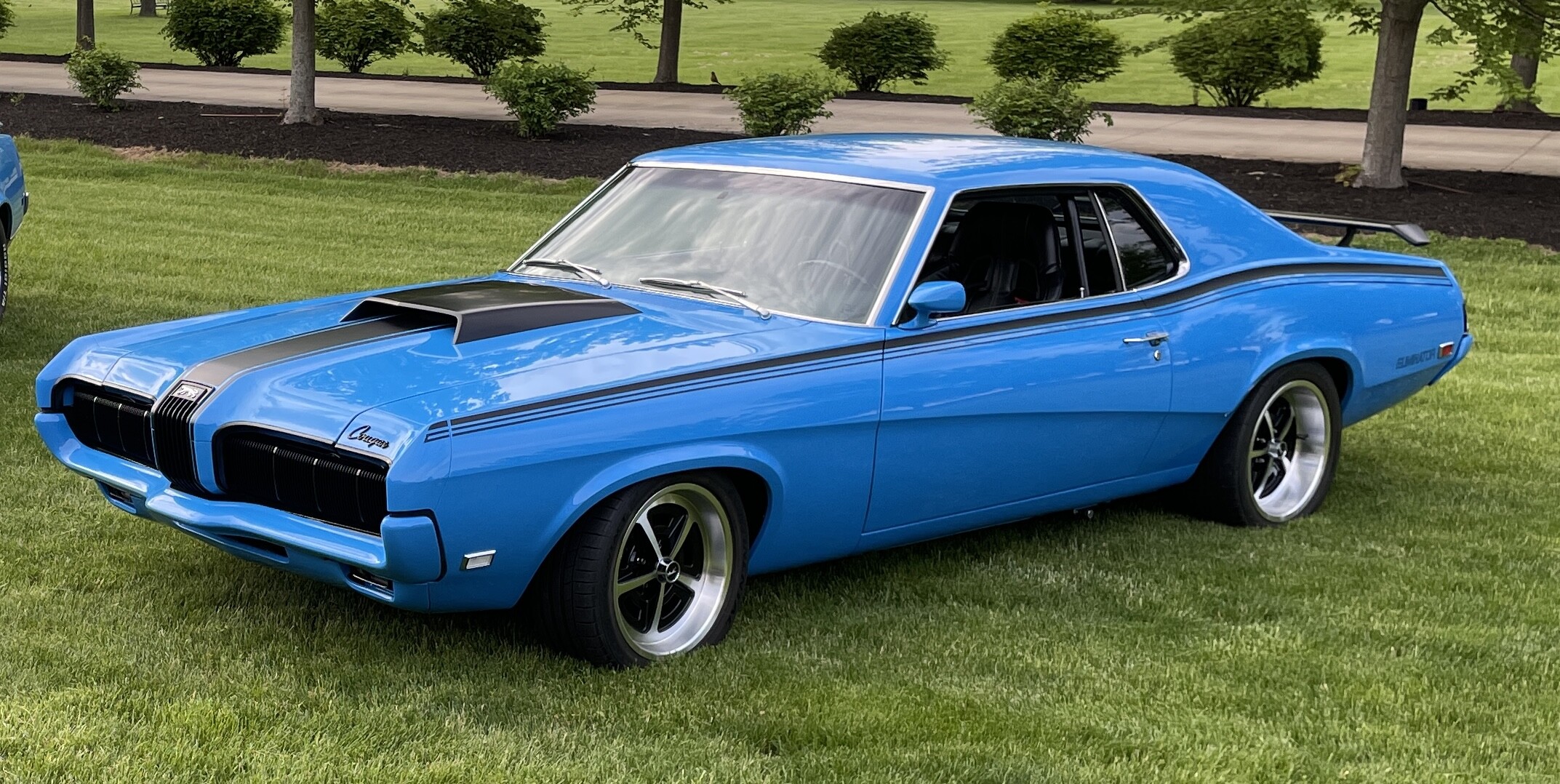

I went the Open Tracker route for front suspension and am happy with the results. I am using Viking double adjustable coil overs as they have a lot of adjustability for mods that are going to happen in the future.

An inexpensive first option is to do the Shelby mod. I did that to mine and the rake issue disappeared. I’m running 16" wheels and tires and the height is great. I’d be concerned lowering it more.

Ronmanny - sorry for the delayed response. I’m running the Scott Drake wheels on my car - the offset is fine with the tires I’m running (215/60 16). I believe wider tires would work as well. I went with these tires before these wheels. I believe these are a 4.5" backspace.
I had some fox body offset wheels before with spacers and wider tires were a problem so I stepped down to these. Finally getting tired of a limited turning radius on one side, I finally swapped the wheels out to these and I have no issues. The tires are plenty wide.
