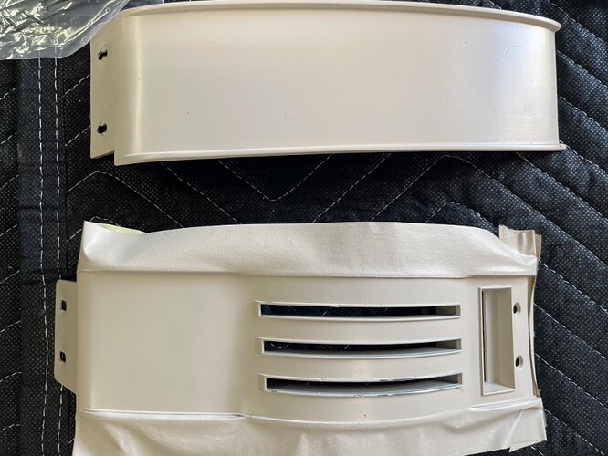

I originally left the exhaust heat shield off so I could retorque the manifold bolts after a few heat cycles. It has a little over an hour of runtime now so I retorqued all of the bolts. I believe I used every 9/16” tool in my toolbox to access the bolts.
I installed the heat shield and tube which was almost as bad as retorquing the bolts.

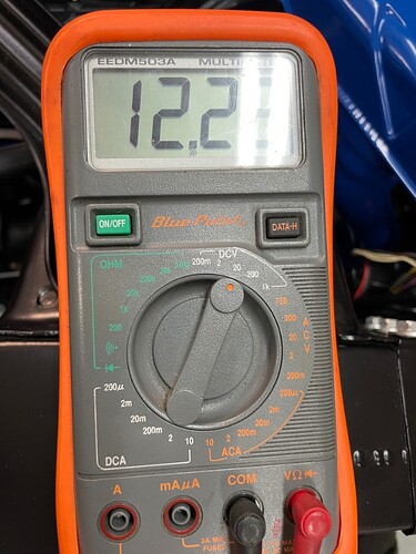

Tested the electrical system yesterday evening late for the components that were currently installed. When I tested the blower motor system I got magic smoke out of the vents. For those who are wondering magic smoke is something all electrical components have that make them work, once it is released the component no longer works. It was a joke one of the older techs used to make when I was a technician.
The blower motor is new and was bench tested prior to installation. The system is pretty simple, power runs directly to the motor the ground is switched through the resistor which creates the varying speeds. Using a 15 amp fused jumper wire I went straight to the blower motor and tested, it worked properly. I inspected under the dash wiring and no visible issues. Then I bypassed the resistor again with a fused jumper wire and the fan operated but at a slower speed than prior. I ohm tested all three wires from the switch to the resistor all less than 3ohms. Testing the wire from the resistor to the motor I discovered the issue 138ohms. On further inspection I found corrosion inside the motor to harness ground connection. A little cleaning with a wire gun barrel cleaning brush and we’re now les than 3ohms. Retesting netted a full speed blower motor.
I removed the resistor to inspect for damage from the excessive resistance and there was no visible damage but on medium speed it would not function so I’ll get a new one this week.

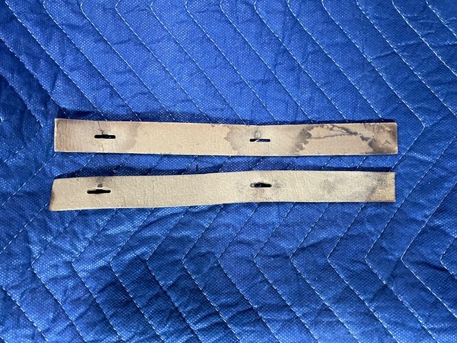

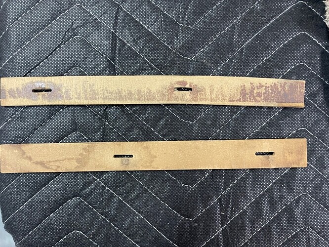

In the area where the headliner meets the rear package tray the car originally had two fiberboard strips similar to door panel material that anchored the headliner to the package tray. The originals were extremely warped probably from water seepage at the back glass overtime. I use the trick that I’ve used on many door panels in the past to straighten them out. I soaked the material fairly well with water then pinched the two strips between two steel bars held together with some shop clamps and let them sit for a couple days to dry. Took them out of the clamps this evening and they are nice and flat and ready for reuse .
When I do this process with door panels I again will soak them down with water then turn them facedown on the shop floor placing a couple of two by fours across the back and a couple of weights from the weight bench to hold pressure on them while they dry.
