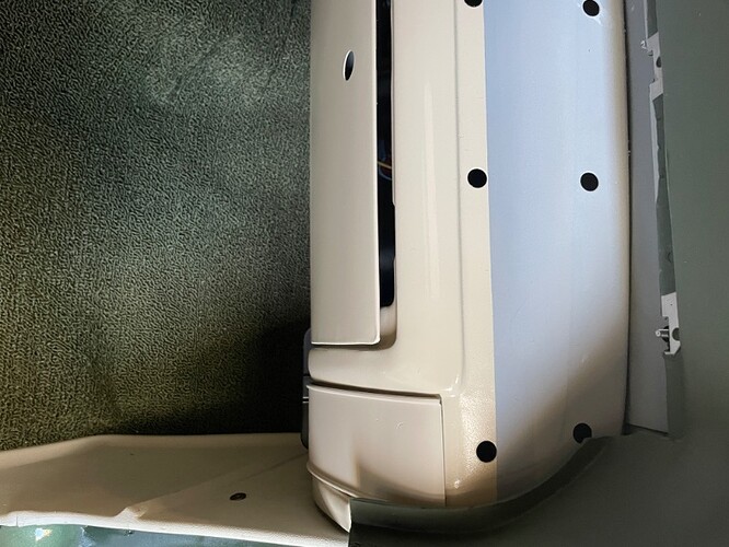

Test fitting the dash pad today as well. For the 1968 model you have to make a small notch in the front of the dash pad to clear the dash Vin plate otherwise it pushes the Vin plate into the windshield.
Can someone post a photo of the side of there 67-68 dash please. This one overlaps the hvac controls and the vent filler panel on the passenger side. I would like to see the factory look before I start trimming. Thank you.
