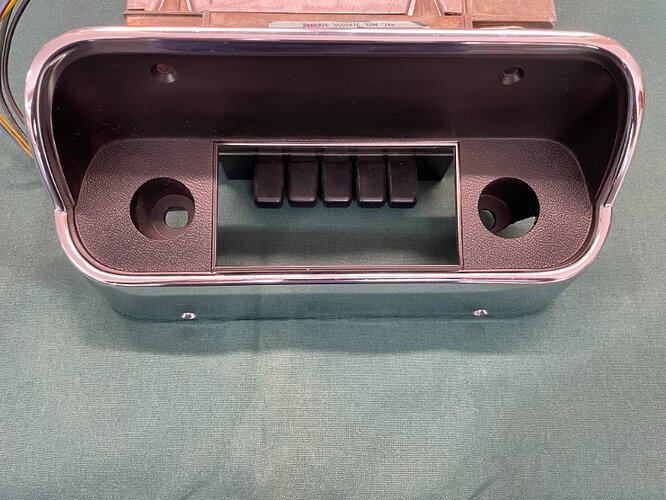

A couple of months ago I stumbled across an NOS AM radio kit for the car which included the radio, antenna, bezel as well as the installation diagram which was pretty cool. The camera case finish on the gauge pod ties in nicely with the radio bezel.

The radio is cool! Did it come with the drawing of the antenna location in the front fender? I need that…
Unfortunately it didn’t have the antenna template. I can make one off of my fender before I install it if you need.
I can measure it on one of my cars.
