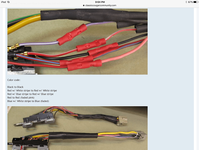

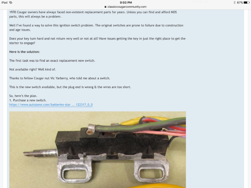

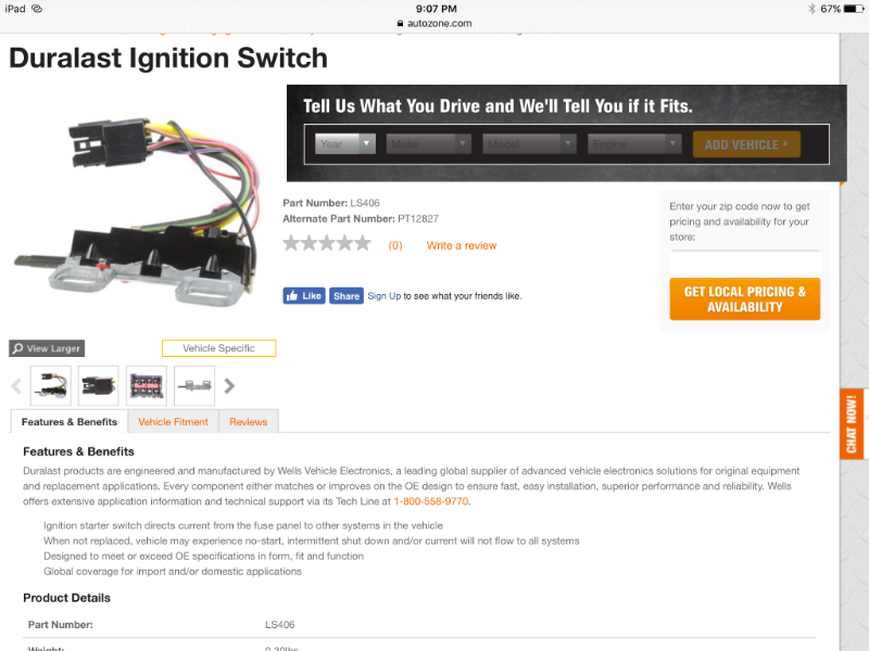

Here is a replacement that will work for the electrical part of the ignition switch:
There is another post that covers this as well. Replace your 1970 Ignition Switch for under $20 - #13 by fathead429
