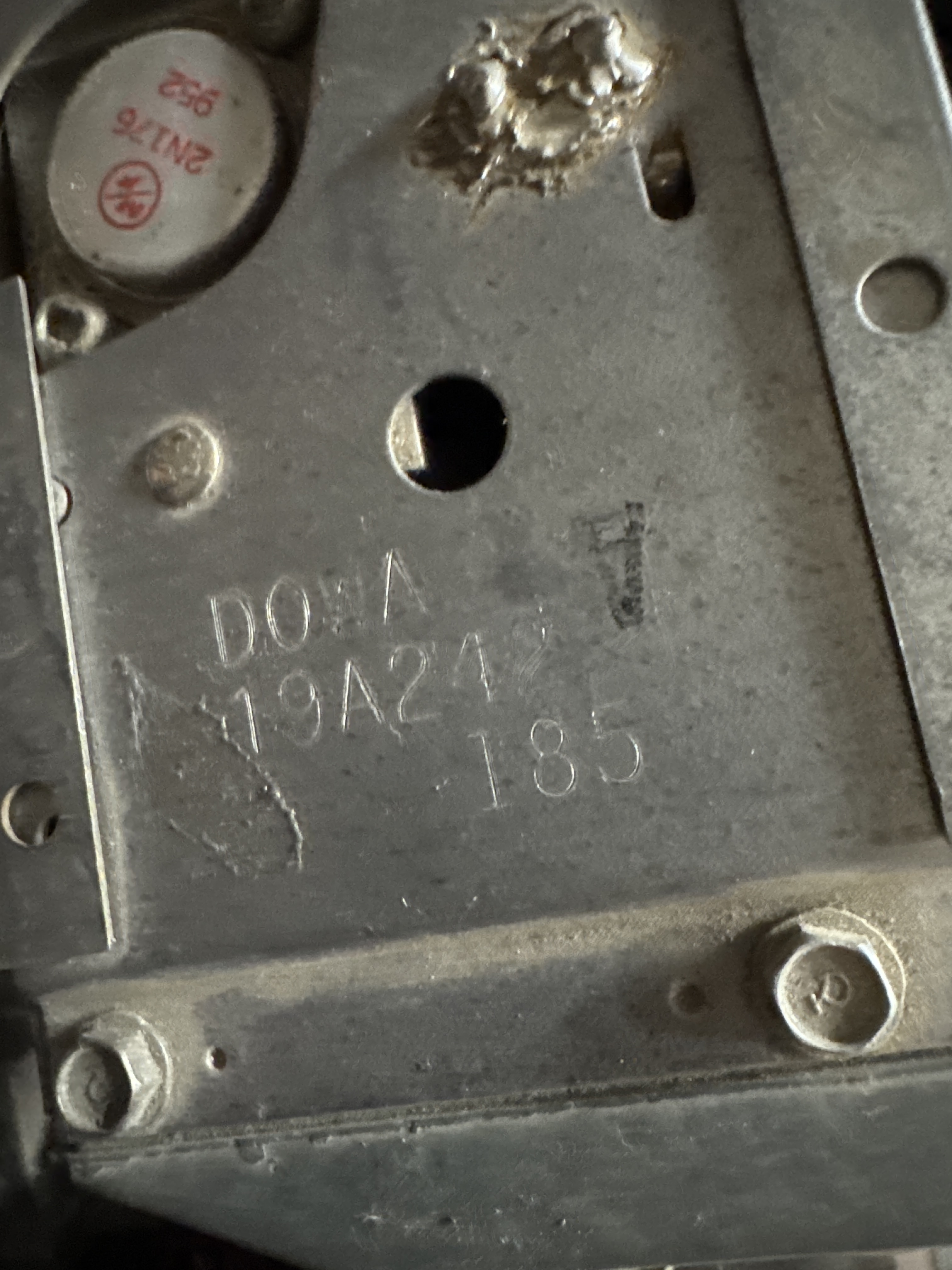

Your radio is likely the original one. Read the number stamped on the side - what is it?

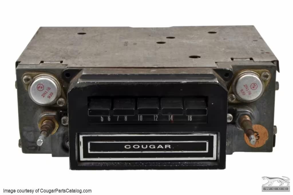

The AM radio for both 1969 and 1970 was imprinted with PHILCO in the clear plastic radio channel lens.
The AM/FM radio in 1969 only had the radio channels imprinted on the clear lens. In 1970 it was imprinted with COUGAR ( as well as the radio channels )
The AM radio-Stereosonic 8-track had no imprinted name on the small clear radio channel lens, and had COUGAR embossed onto the tape flip-door ( for both 1969 and 1970 )

This is what you’re looking for…

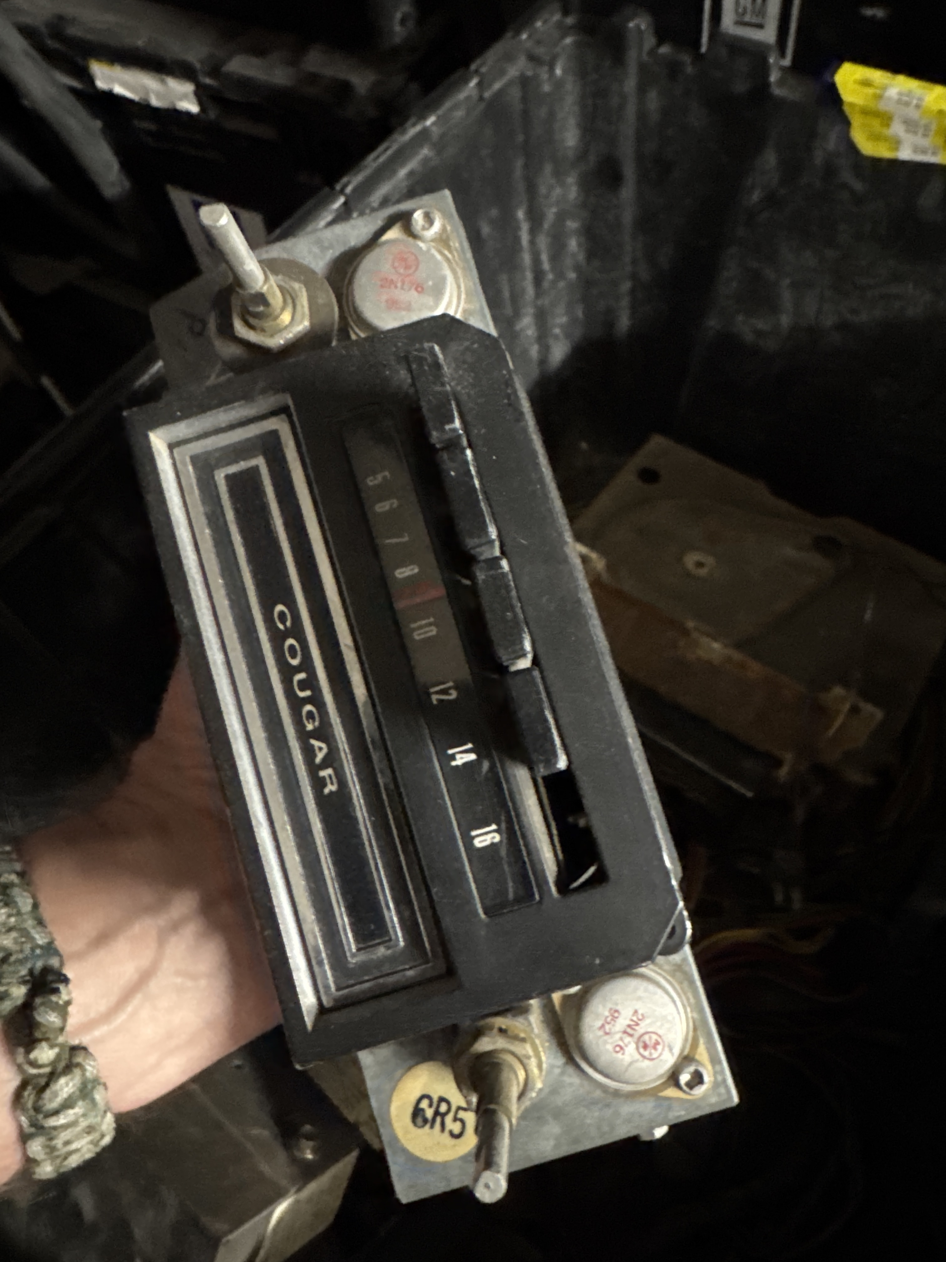

i have the same one and missing same Botten for sale
Thank you for the pictures. After looking at the surounding area of the radio channel screen, it’s very “Plain Jane” style for a classic luxury car.
Hello, can you take a few pictures of yours?

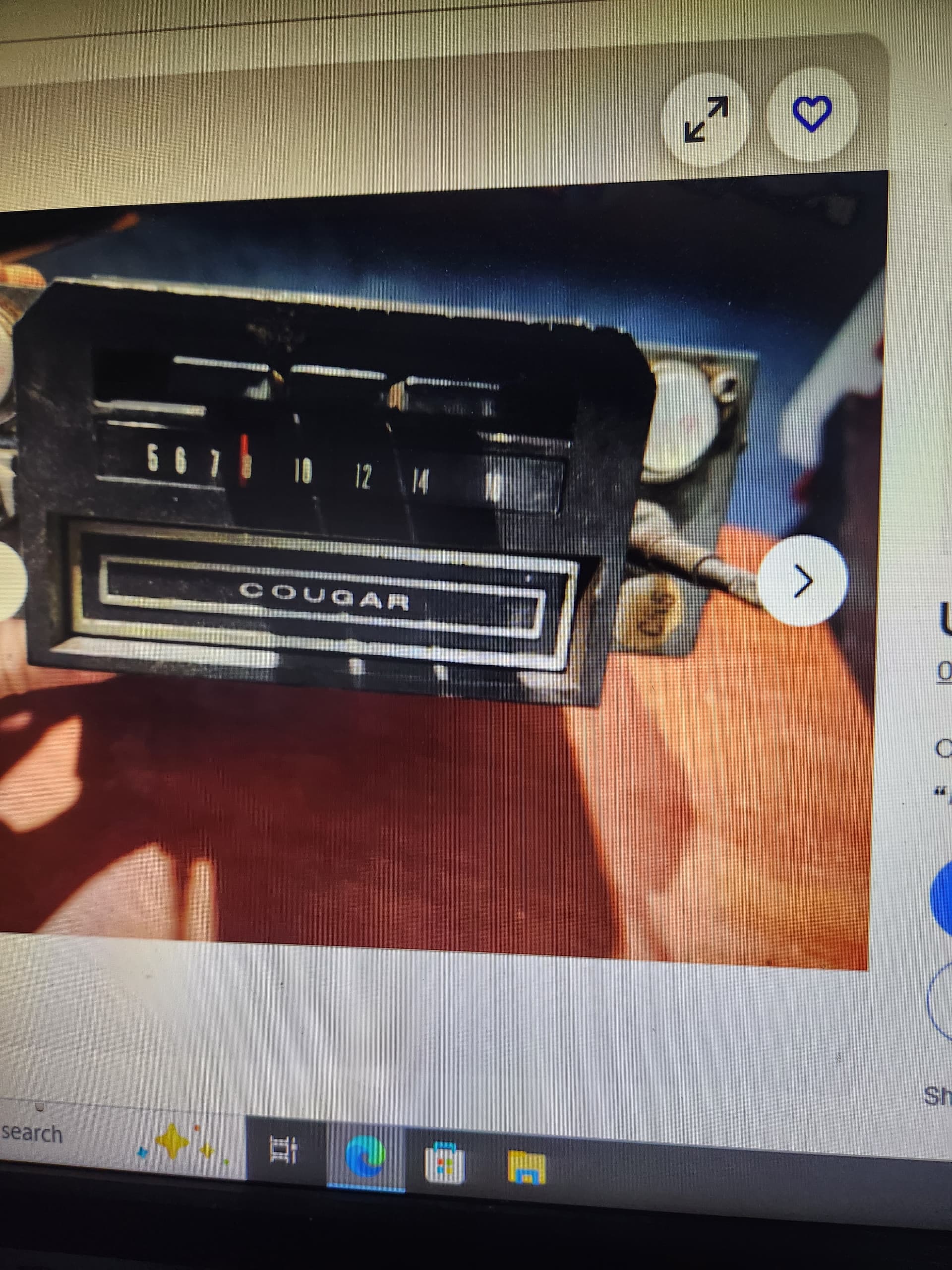

Its on ebay
Thank you for the picture. I just saw it on ebay.
