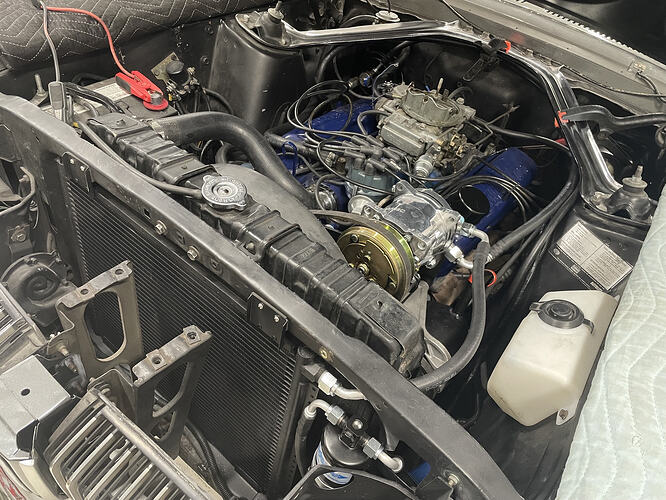

What exactly was compromised? System contamination? I rebuilt the HVAC box and changed all the under-hood components with new Sanden pump, reduced barrier lines, parallel flow condenser, and receiver drier. I’ve heard good things about some of the aftermarket systems but prefer to retain the inside OEM box and controls.

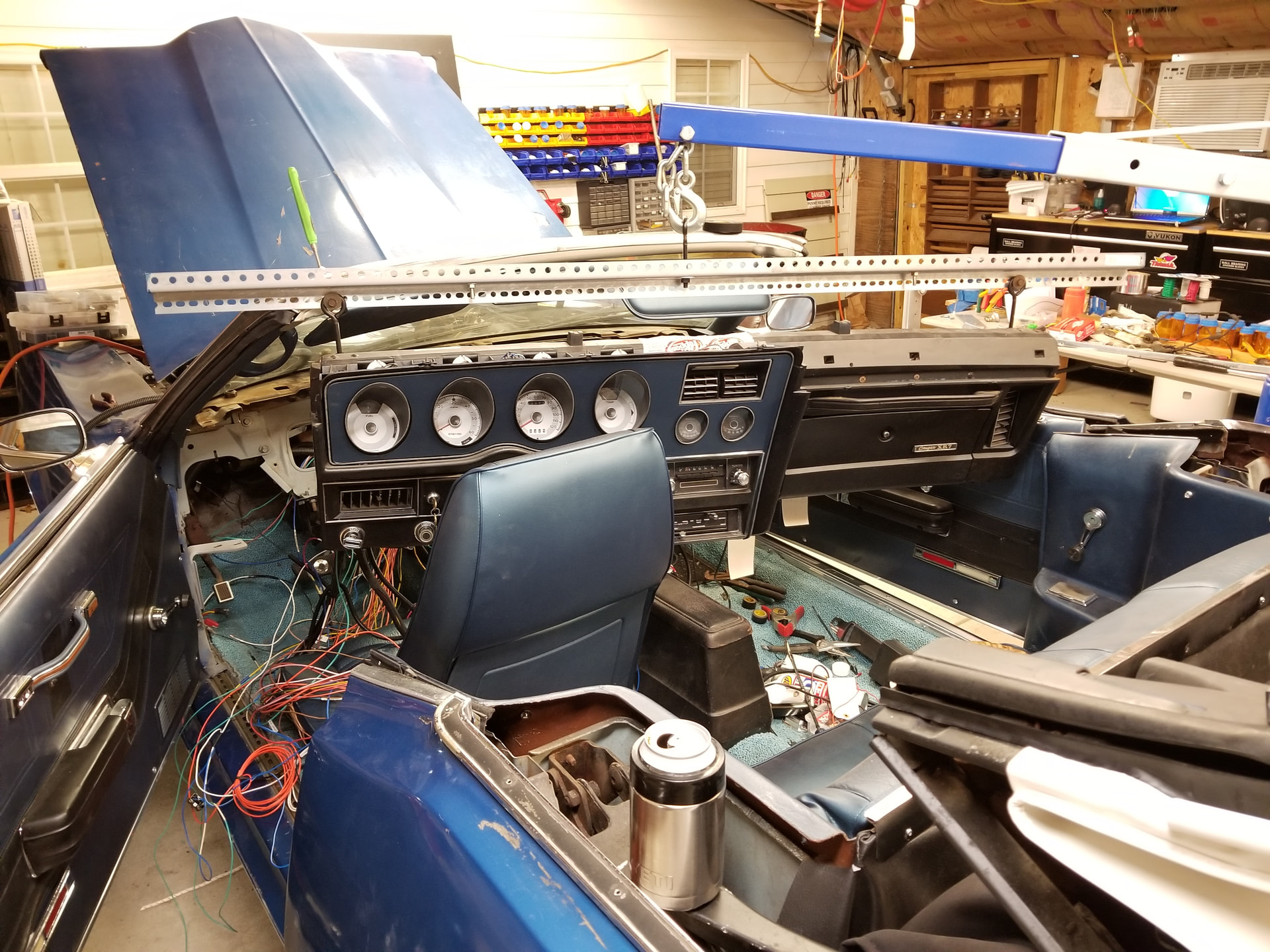

I, too, rebuilt the HVAC box, but put back in the original evaporator and heater coils. That was 5 years ago. I’m using the heater coil, and so far, no leaks. My concern is that I’ll do what you did, but with negative results. I put tape over the exposed valve block under the hood, and except for the old York bracket, all the rest is gone. I’m 77 years old, going on a hundred, so this decision is based on the fact that this will be the last time I remove the dash (which is the easiest approach), as my financial means won’t allow me to hire this refurbishment out. Also, from what I’ve read, it will eliminate a lot of the vacuum lines, iffy selector switch, that pesky long wire cable, wiring harness, and additional accumulated underhood temperature increase. I’ve already switched over to a 4 row and dual fan radiator, which was a Godsend. My query was if someone has a '71-'73 and has already done this.

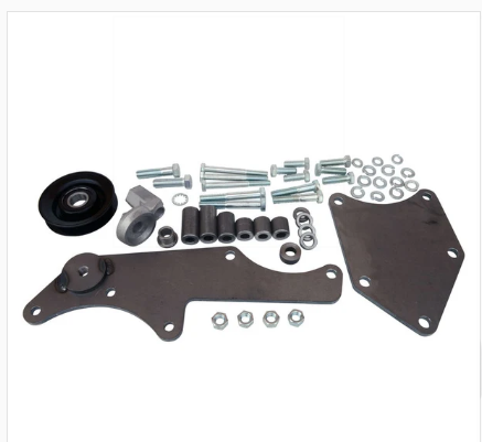

Yes, it’s a polished Sanden 508 style. I wanted to use the economical conversion plate but the OEM tensioner pulley and heavy brackets just looked wrong next to it. Maybe they could have been eliminated and just used the pump as tensioner? There are other conversion kits that “cheap out” and use the pump as a tensioner but I never liked that idea. I opted for the more expensive setup with the dedicated tensioner pulley and bracket like below.
Looks good from here. I will have to (possibly) remove and discard the York bracket, but this looks substantial enough to do the job. Where did you purchase it from?

Yes, it’s a pretty stout kit. The plate material is 1/4" thick or more. I bought mine from Classic Auto Air but looks like Johns Mustang sells the same kit for less. Of course, it’s for early model SBF. Unsure which engine you have but shop around, you may find better pricing. If you’re buying new lines I like the reduced barrier hoses. They are significantly smaller, none of mine are larger than a heater hose.
John’s Mustang: 1965-1968 Mustang Sanden Compressor Bracket Kit, V8 (289, 302)

The dash does not need to be removed on the 71-73 cars. The HVAC box is two halves - the blower housing and the evaporator/heater core case. You leave the blower housing in the car and remove the other half - do your restoration work and reassemble. The shop manual has a step-by-step procedure, exploded diagrams and the vacuum schematics.
Good to know. I removed the box on my 68 ok but it was tight. I don’t have a 71-73 but I have a 1970 Mach 1 and I know for a fact you must remove the dash to remove the evaporator/heater box. I assumed 71-73 Cougars were the same.
You are correct. In my case, I’ve decided to replace the entire A/C system. After much discussion with Classic Auto Air (and while it won’t win me any points at an AACA show) I settled on their direct replacement system. Also, while it does require the replacement of all components (except the Ford/York mounting bracket) both underhood and underdash, this gives me the opportunity to repair/replace a lot of radio and gauge wiring that needs attention. You know, in for a penny, in for a pound. So, thanks to all of you who shared their thoughts. I had a lot to think about, and all things considered, this seems the best route.
