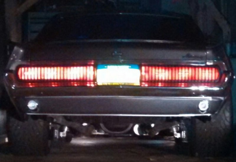

I attached some pictures of past work and how she sits.

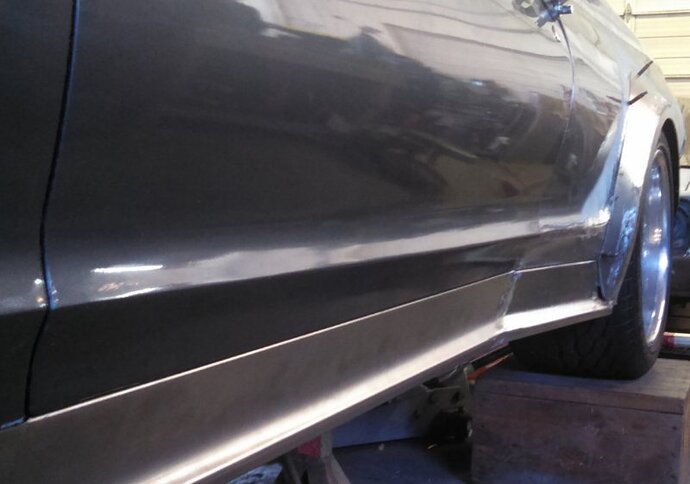

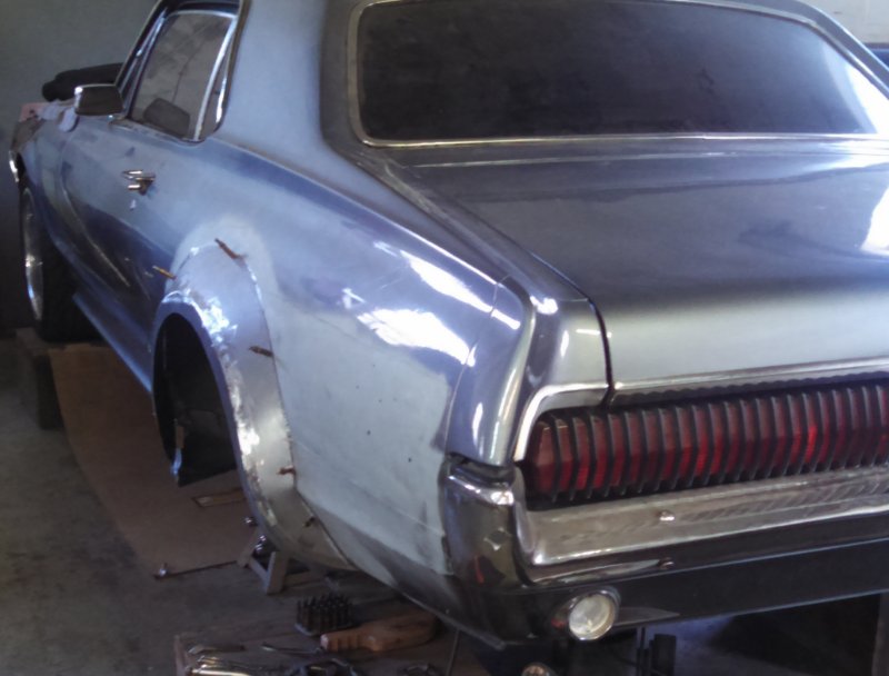

I would like more information on your flares.Did you make them and what was the process?

I made them as well as adding 2 inches to the wheel well. I made templates using hard stock paper, light cardboard. Got it close then transferred to metal and then used a roller to give it a little bend then tacked the side piece.
