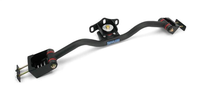

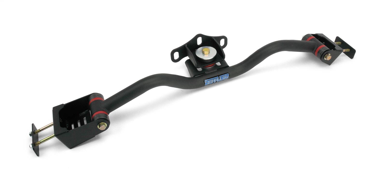

Maybe this might help.
The Stiffler’s cross member is most likely what I will try to use for the 6R80 automatic. With any luck it will clear my exhaust and bolt up to the subframe with only minor modification.
Looks like it would work for you but from what I can see on the Summit page it appears that you have to weld in the new crossmember attachments after cutting out the OEM transmission mounting crossmember. Not a bolt in.
Good points. I should have the 6R80 mated to the block in a couple of days. Then I can start sizing up mounts. Ultimately I need to think about the cross member, mount, frame connectors and driveshaft loop long term. The original cross member isn’t coming out but I’ve had to make some indents.
I would worry about the drive shaft tunnel too. Likely it isn’t big enough and will need some rework.
