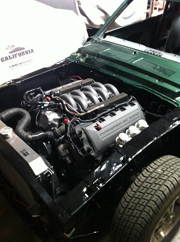

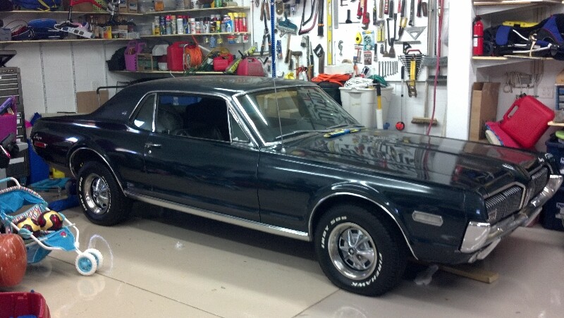

I’m in the middle of a coyote cougar restomod project for my 1968 Cougar XR-7. This is my first car, and I bought it in 1985 for $350. It’s come a long way since 1985, and since the motor/tranny were not numbers matching I decided to restore it as a a restomod. I have attached a couple of pictures, and I’ll post more of a how to later. Bob Lorenz from R&R restorations (http://rrrestorations.com) is overseeing the restoration, and can answer more of the technical questions. The suspension is from Total Cost involved, and the Coyote Crate motor and Tremec T56 6 speed transmission are from Ford racing.
And yes, we had to remove the shock towers.
Total Cost Involved has been a great resource for the project. They published a how to pdf document to support their custom front suspension swap. Let me know if you want a copy, and I’ll email it because it’s too big to attach.

I have no experience with the Coyote motor… But I do have to say that your car looks sweet with that motor in there…
Brian
John welcome to the Classic Cougar Community. That’s a fine looking Cougar that you have. That engine looks massive in the engine bay. :thumbup:

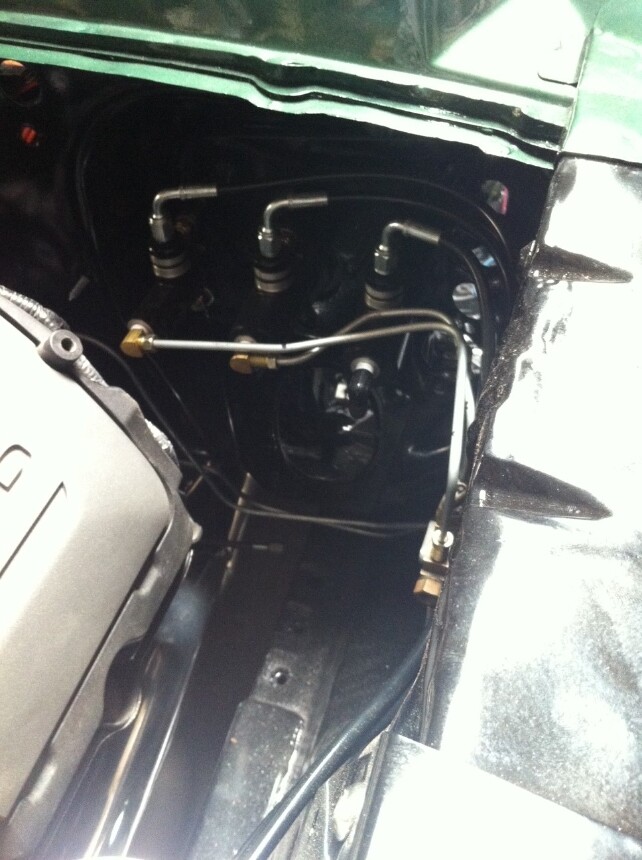

Thanks Steven,
Yes, it takes up so much of the engine bay, we had to run individual brake cylinders, and mount two to the inner fender, and two inside the trunk.

Wow…that’s all I have to say about that.

Dang that looks cool in there! And you know the car is going to go like stink!
