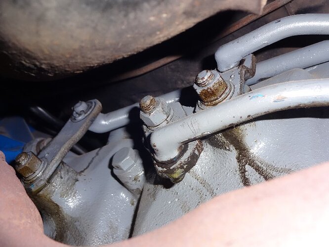

I’ve attached a photo of the shift levers in case there is anything obvious about the positions.
If not, any suggestions?
Thanks
