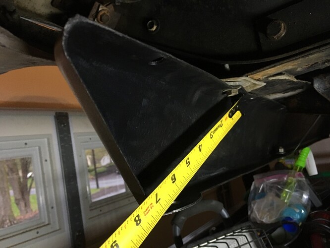

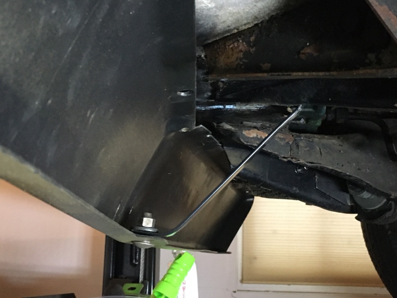

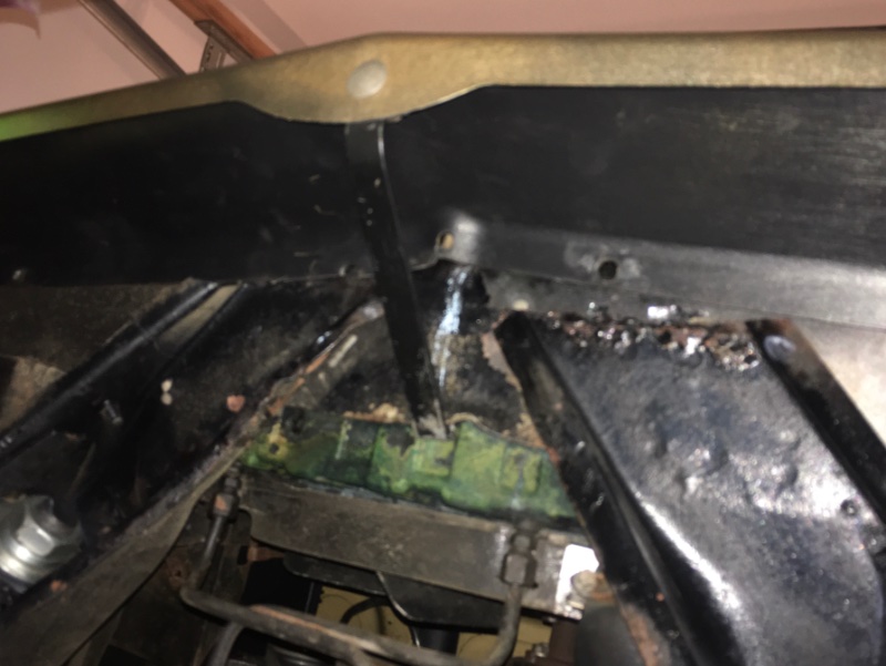

Here are some pics.
1/2 flat stock that I drilled a hole in on 1 side to bolt to the spoiler and bent up and back to hold into the core support. It gets pulled foward by the force of the spoiler and holds it in place for now
I drilled 2 new holes in the spoiler to hold it onto the lower cowl bolts.
I have 2 other 1/2 inch flat stock mounts for the ends but I haven’t finished those yet. They will also use the lower cowl bolt and bolt to the lower outer spoiler hole.
