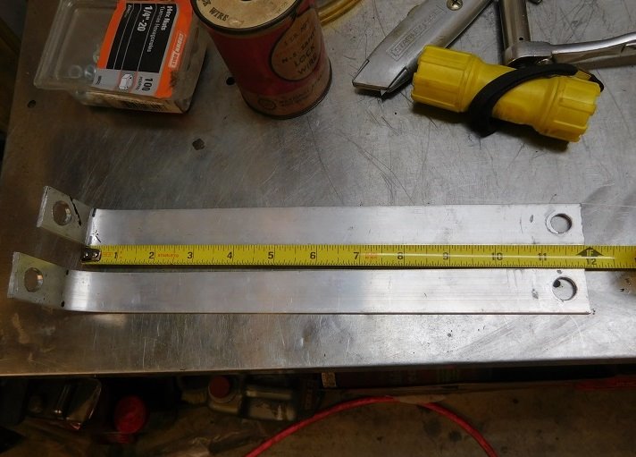

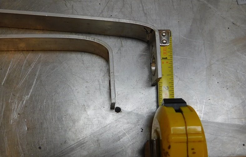

Here are the supports I use to hold the front of the transmission until the engine is installed. The material is 1/8" X 1.25" aluminum bar stock.
Thanks Royce ,that way looks so convenient.

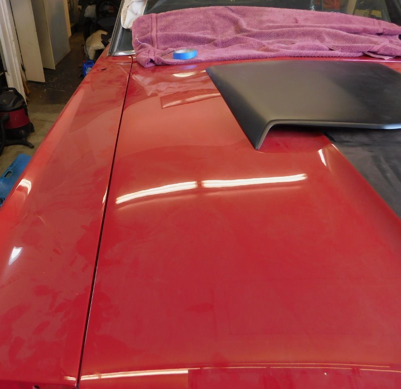

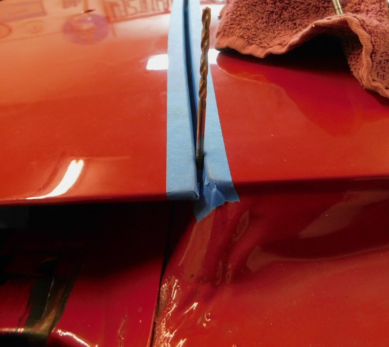

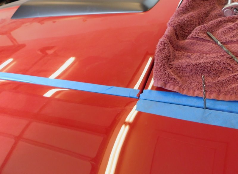

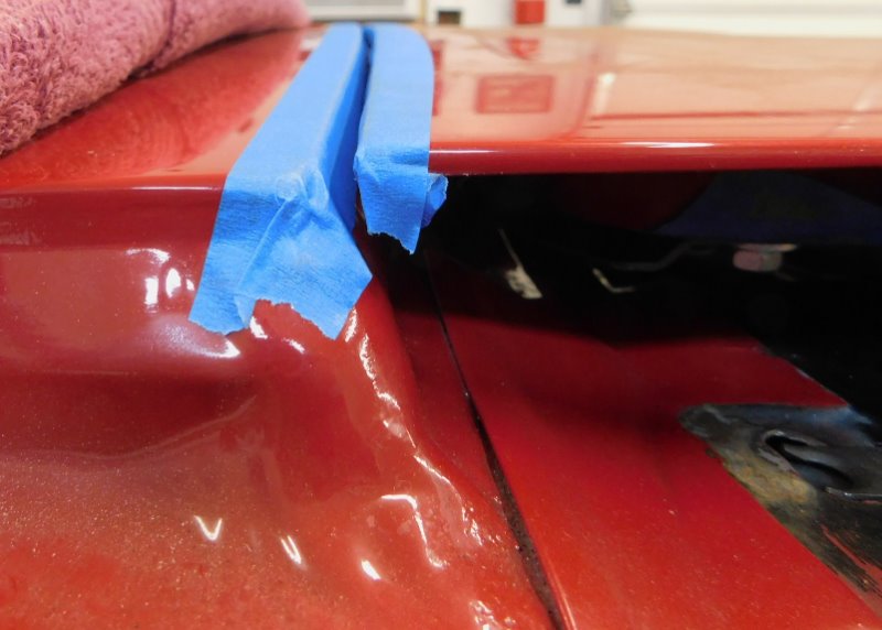

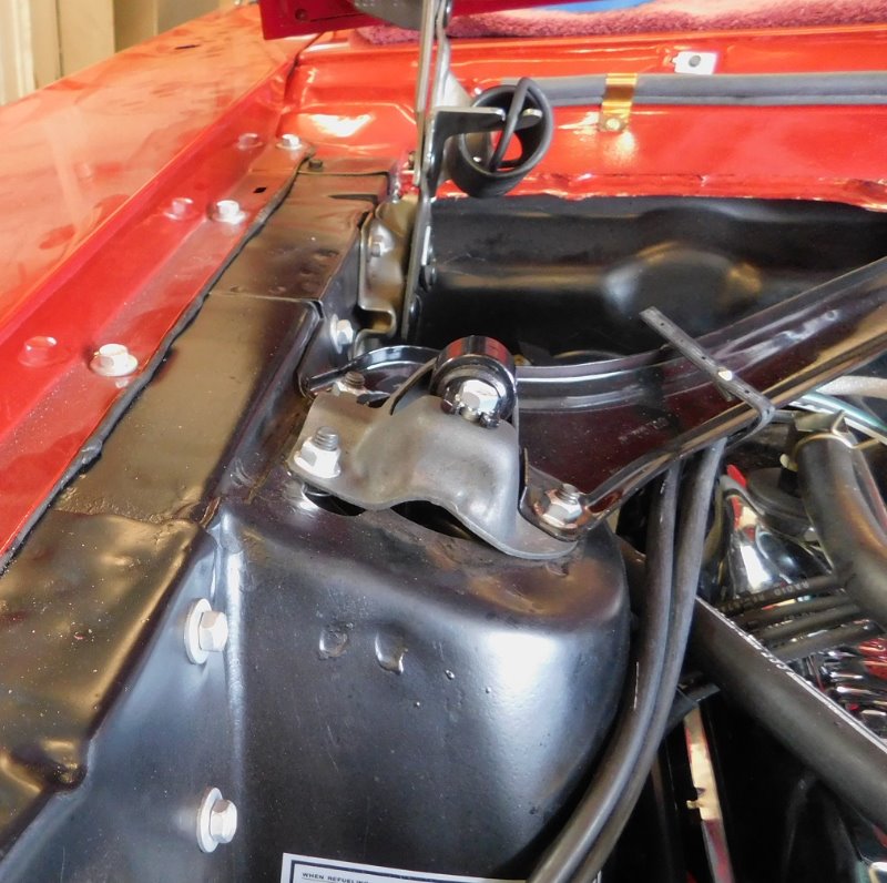

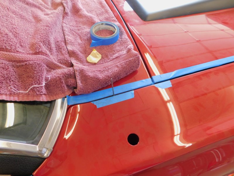

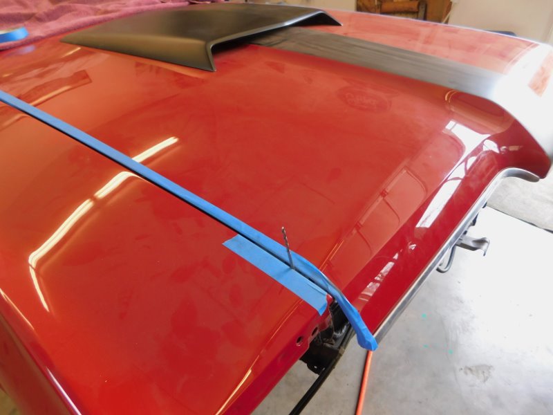

I spent most of the day today adjusting the hood and hinges and the hood latch. The factory spec calls for .120" +/- .060" at the cowl to hood gap. I ended up with .125" at each end which made the center .160".

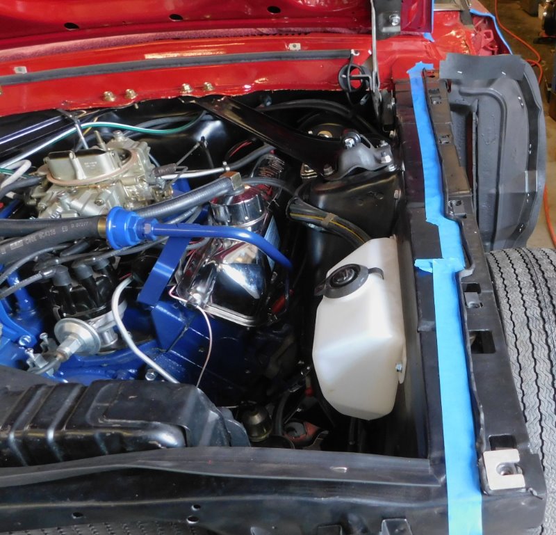

This was where I started, looking from the passenger side across the cowl.

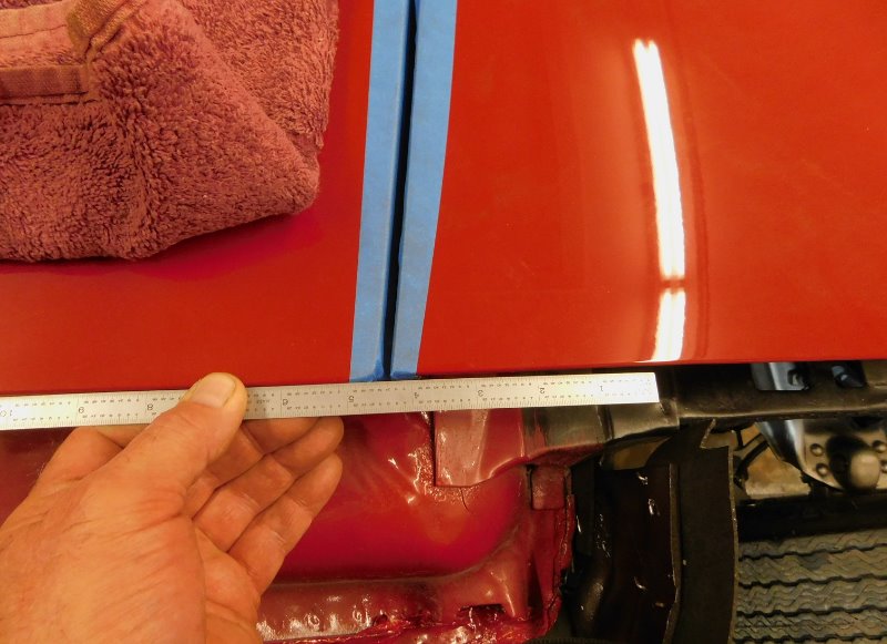

This is the driver side with the bolts loose on the hinge so I could get the 1/8" gap.
The side to side gap was way off even using all the adjustment available in the hood hinges. The LH side had the hood 1/8" shy of aligning with the hood, while the RH side was off the same exact amount in the other direction.
A single factory style shim from the AMK hood hinge kit under one of the LH hood hinge bolts fixed it.

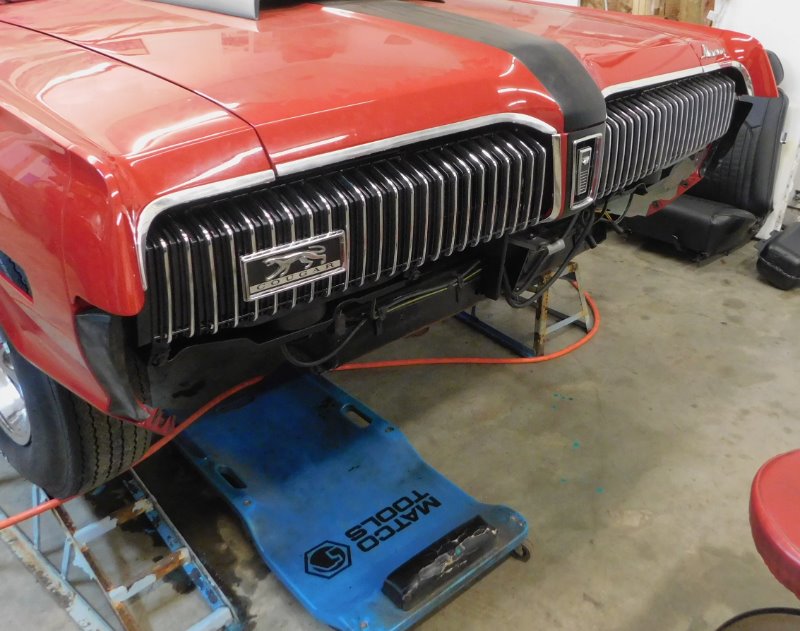

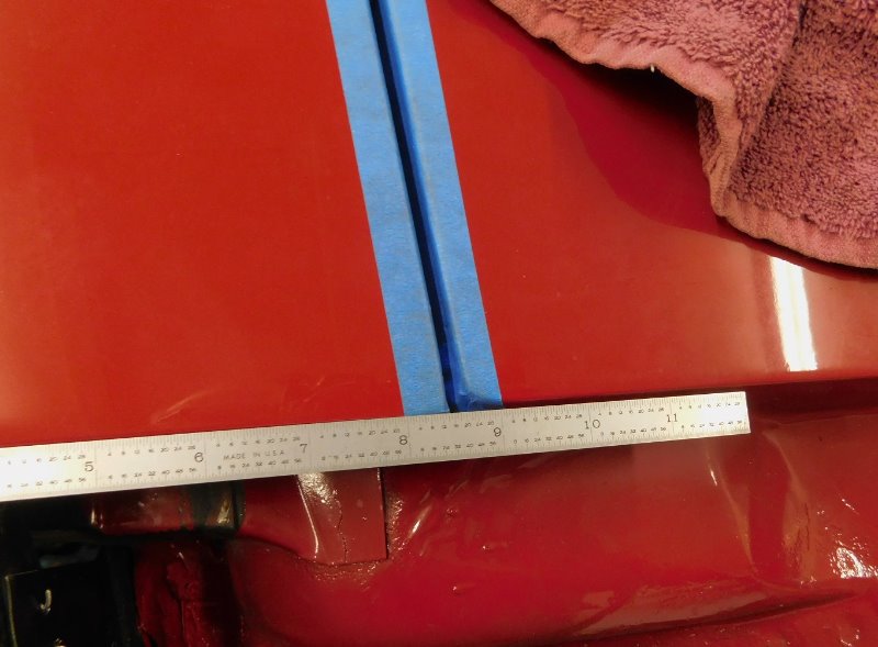

Yesterday was spent installing the front fenders and grille. Lots of work! We started by test fitting the fenders so that a pattern for the butyl rubber seal strips could be determined. Then the rubber caulk was laid in place where it is supposed to be. This product started out as 5/16" diameter, we used a piece about 18" long and stretched it for the length of the fender. As a result it ended up about 3/16" diameter before getting squished by the fender lip.

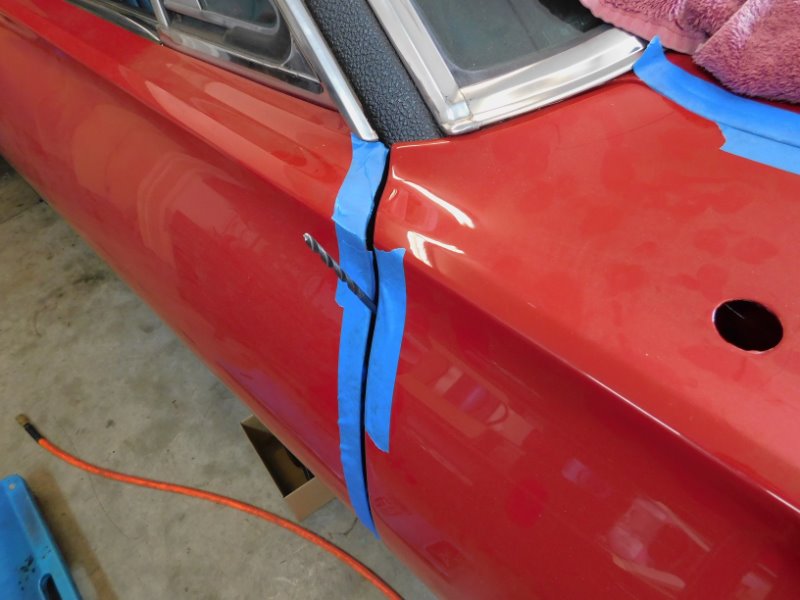

With the hood already properly aligned we just needed to get the gaps recommended by the factory shop manual. Door to fender is 3/16", fender to hood (or cowl) is 1/8".
It’s starting to look like we might get done soon! Here is the finished gap, and what the squeezed out seam sealer looks like.
Very nice alignment!
