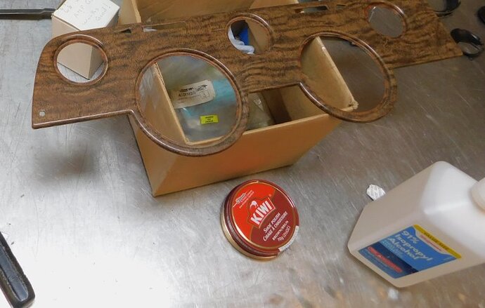

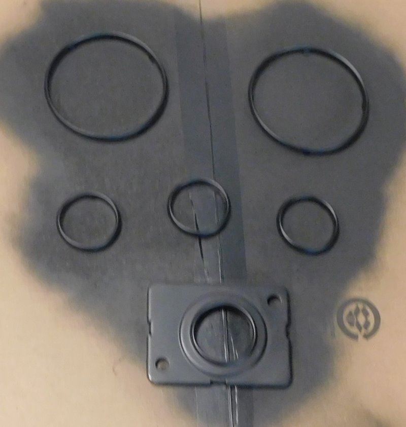

The dash chrome parts came on Friday from Instrument Specialties. I have to say the work was flawless. The plastic chrome is deep and rich, and the semi gloss black / satin finish is also exactly as it should be. All the areas that were originally robin’s egg blue were also flawless. With that in hand I had a lot to do this weekend.
The first job was carefully cleaning the dash woodgrain pieces. I used 91% rubbing alcohol and it did a fine job of removing all the nicotine. Next I used brown shoe polish to bring back the faded color. Bear in mind my wood grained parts were virtually perfect, if yours are not so nice you probably need to buy the woodgrain kit sold by WCCC.
